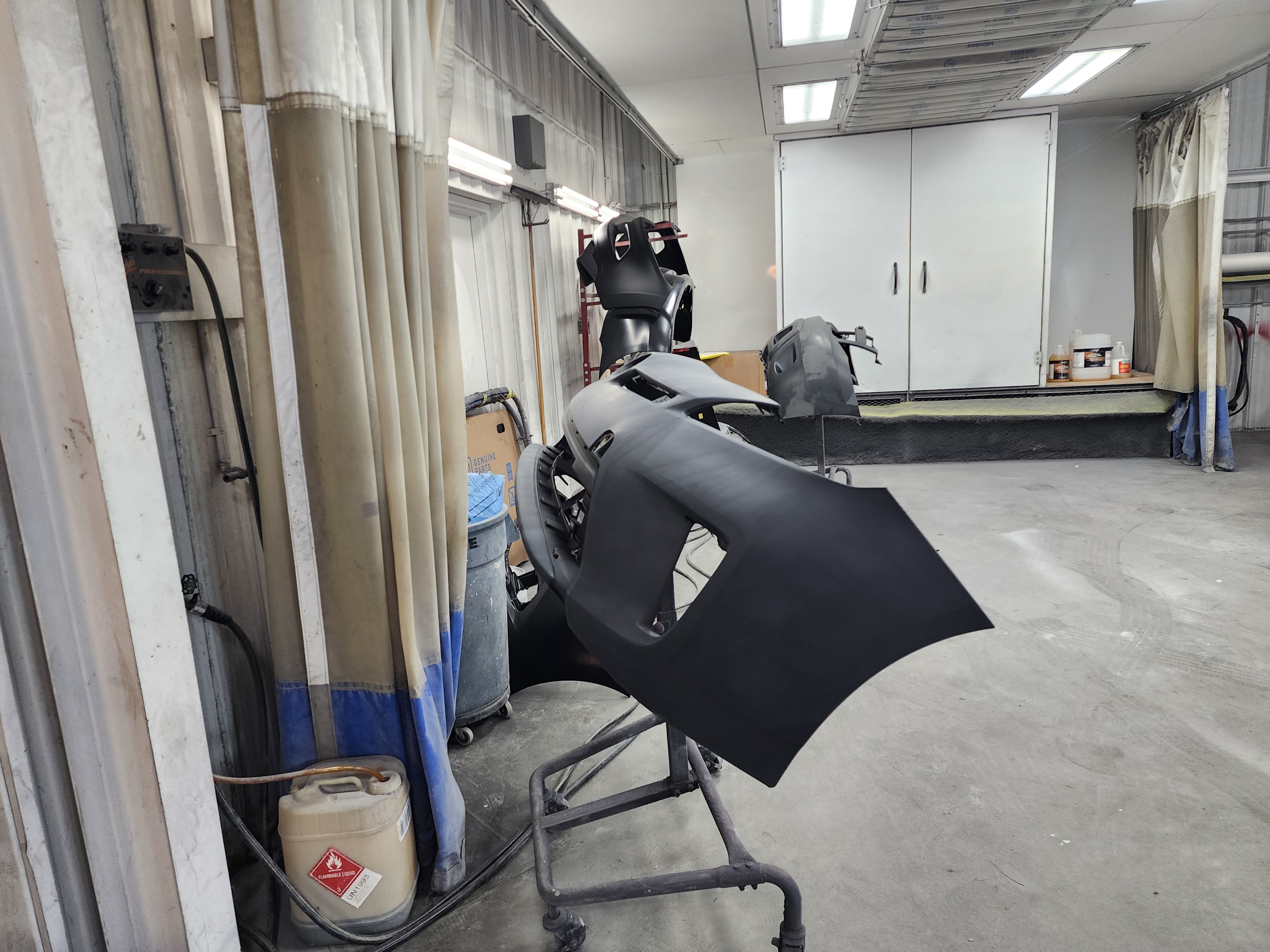

I walked back to the back of the shop one day when they were spraying the Subaru. Paint booth in the corner and 2 sides were draped plastic on a rail like a shower curtain. No heating equipment around. Saw a front bumper and a couple other parts on stands in the main bay drying.

Sikkens is a good product. the blowtherm is where color is applied, and when dry, the clears are then applied. the area with the curtain is a prep station where sanding and priming is done. it has a dust collection systems. the spray booth will either have a natural gas or propane main burner. my booth is natural gas. i have a 3 inch high pressure gas line feeding the 1.5 million btu burner. there is a prefilter on the air intake side, then the main burner, then another set of filters in the ceiling of the booth, into the spray area. under the grating on the floor is another set of filters to remove and overspray or dust. the filtered air is the exhausted outside. my booth has a 10hp 3 phase motor on the intake side, and another 10 hp 3 phase motor on the exhaust stack.. the exhaust filters are 98% efficient. the booth system is a balanced positive pressure system to avoid any dust infiltration in the spray area. we bake at around 140 degrees f, but our booth is capable of 170. it is very expensive to run the booth.

Apparently there is a squirrel cage fan with filters that blows outside air down on the car in the paint booth. A squirrel cage fan with filters is also underneath the floor that exhausts the air outside and pulls down the air at a .5 cfm higher rate. They didn't know the one underneath wasn't working right. Spent the last 2 days fixing that and were adjusting the air flow when I was there.
They said it hadn't been working right for the last 2 years but they thought it had to do with outside wind, temperature, and humidity issues that was causing the problem with the down draft. One said something about not knowing the underneath fan unit was even there until they called the guy who installed it in 1989.
