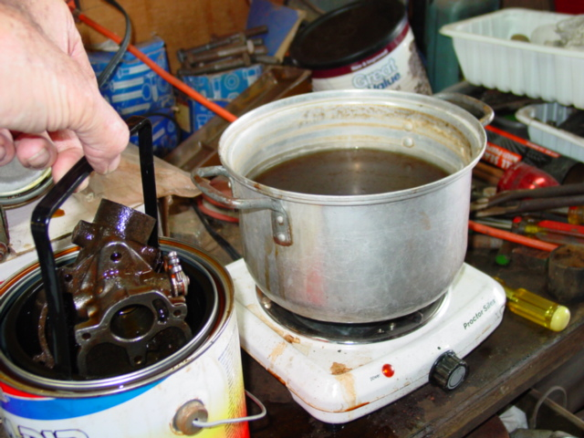

Posted a few days ago that it wouldn't run without choke. Pulled it back off and went through it again. Found an extremely small hole in the top that was blocked. Some carbs have one hole,some have two. Torch tip cleaner , carb spray and air compressor, it's working correctly now.

When I was able this was how I cleaned carburetors after disassembled them. I soaked them in carb cleaner for however time it took to get back to them. a day or maybe a week. I then boiled them in dawn laced water. Compressed air and a visual check with my dental picks. Just passing along how I did them. How else can I get others to look at all the pictures I took.

This one was really rough. Sat in the bucket of Berrymans for a week+. Then an hour in a hot ultrasonic cleaner. 😉
