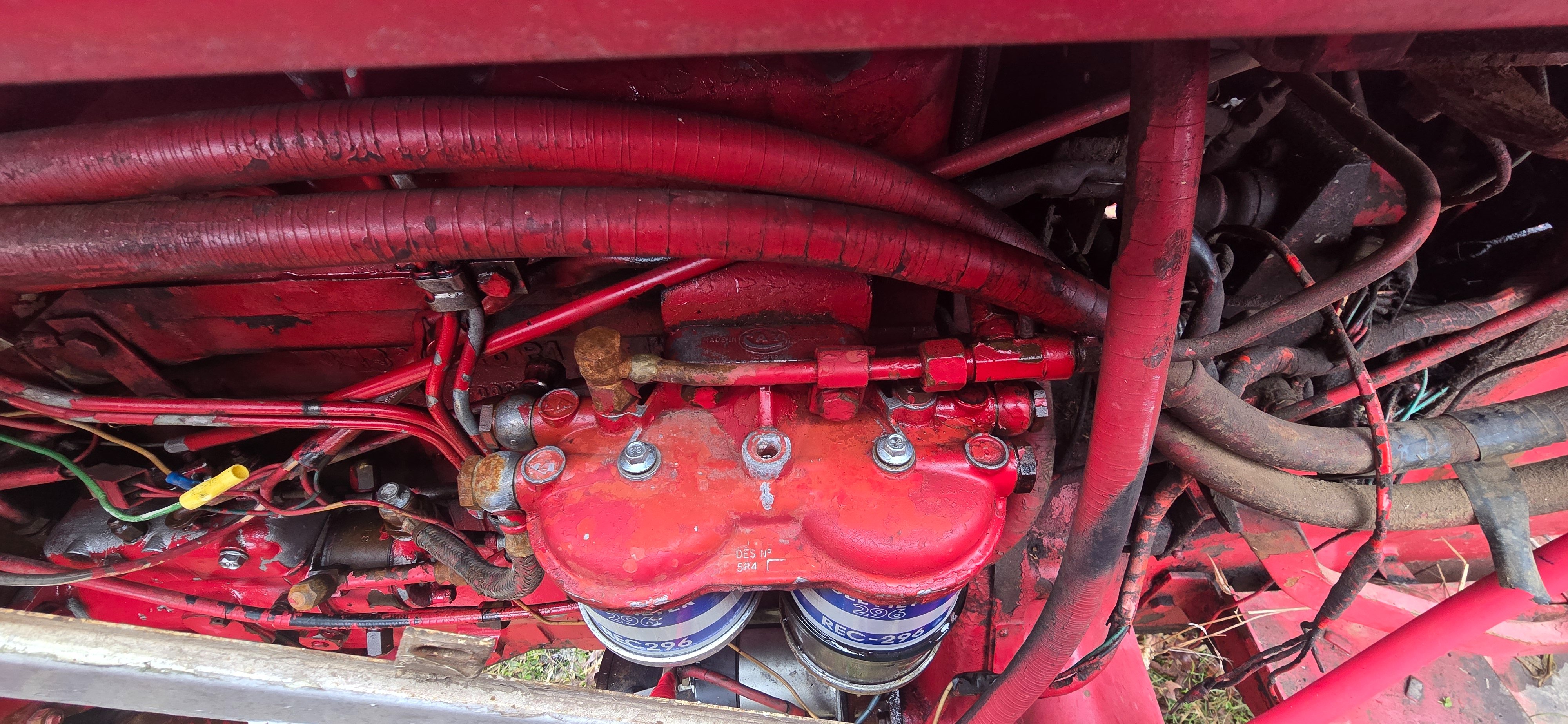

Re fuel filters, see photo below, I believe you have the good ones like the one on the left with the holes in the top, the one on the right has caused problems with fuel flow.

The primary fuel filter base has a drian plug which is just a suckin in air like crazy. No idea how ive missed this.
Opened it up, here's a pic of the threads.
Gonna have to size that up, threads are pretty wooped. The bolt that was in it spun while I was trying to cinch it down.
Should I do straight thread with an oring, or npt?
Either would work if done correctly. It looks like that was originally straight thread plug with a nylon, fiber. or other type of sealing washer; it doesn't appear to have the lead in chamfer that would be there for an O-ring.

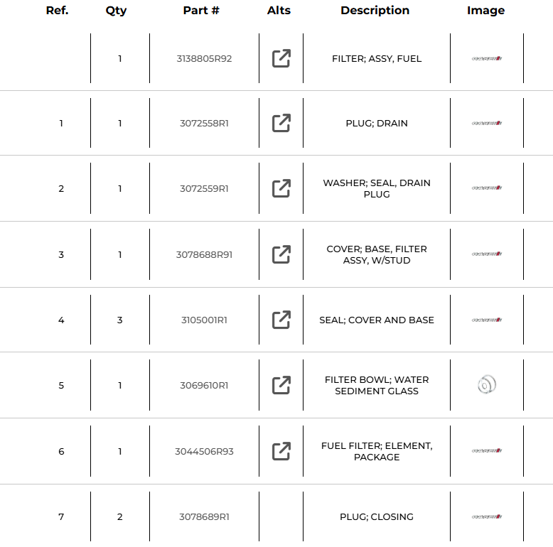

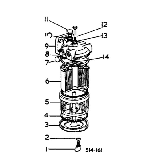

From CaseIH 454 European CAV Fuel System parts, Item #1 Part # 3072558R1.
Google Part # 3072558R1 and see if there any available.

Thanks for the diagram Jim, I'm going to see what I can get for the baseplate and the drain plug.
I previously purchased a complete filter assembly with the top bracket and such, none of the lower components interchange with the original cav top end.
May have to go with the aftermarket assembly if oem baseplate is not available.
