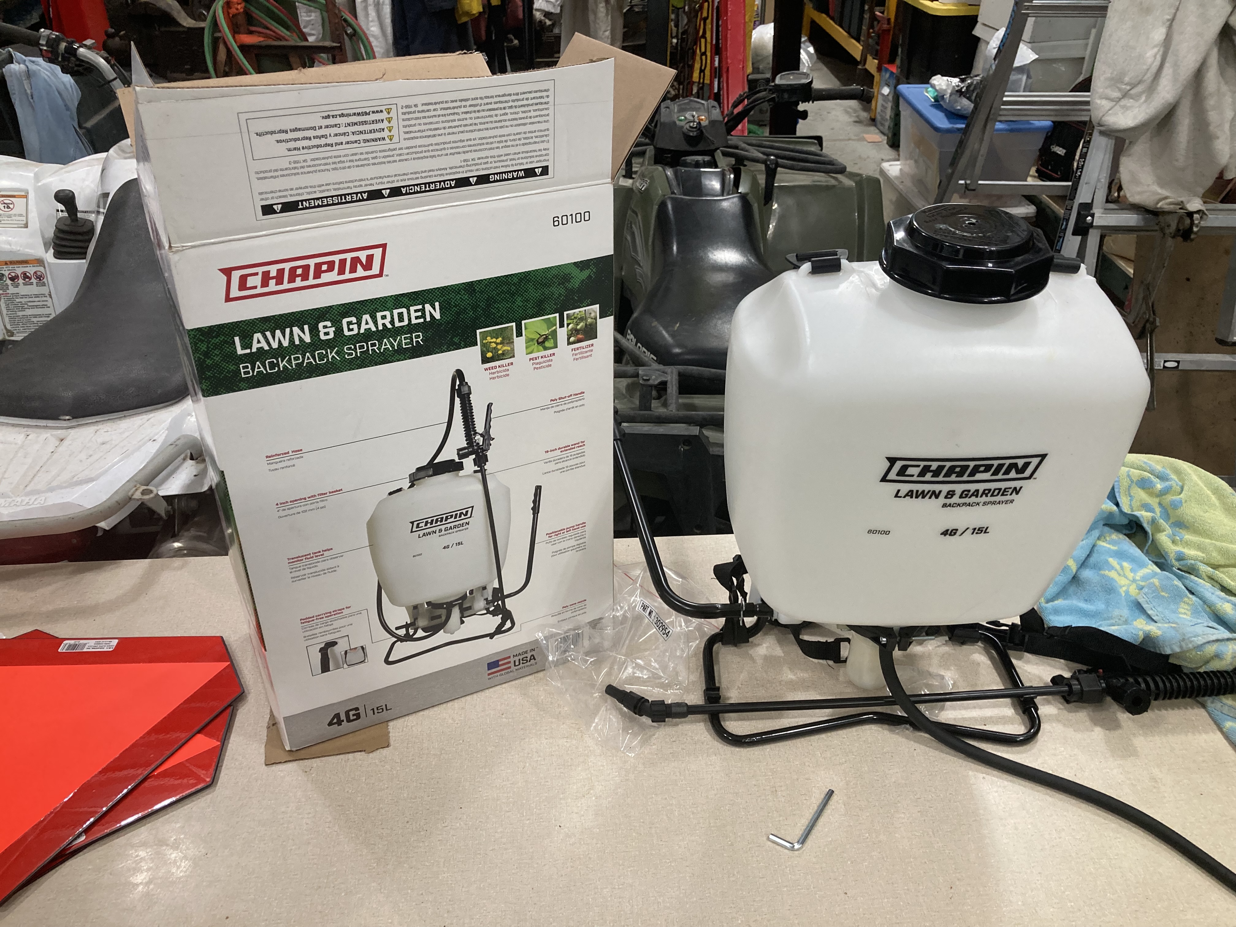

Been considering a backpack sprayer for herbicide. The hand pump ones are generally under a hundred dollars, the battery ones a couple hundred. I get a little tired schlepping the two gallon pump ups around and seems like you always pump more than you spray.

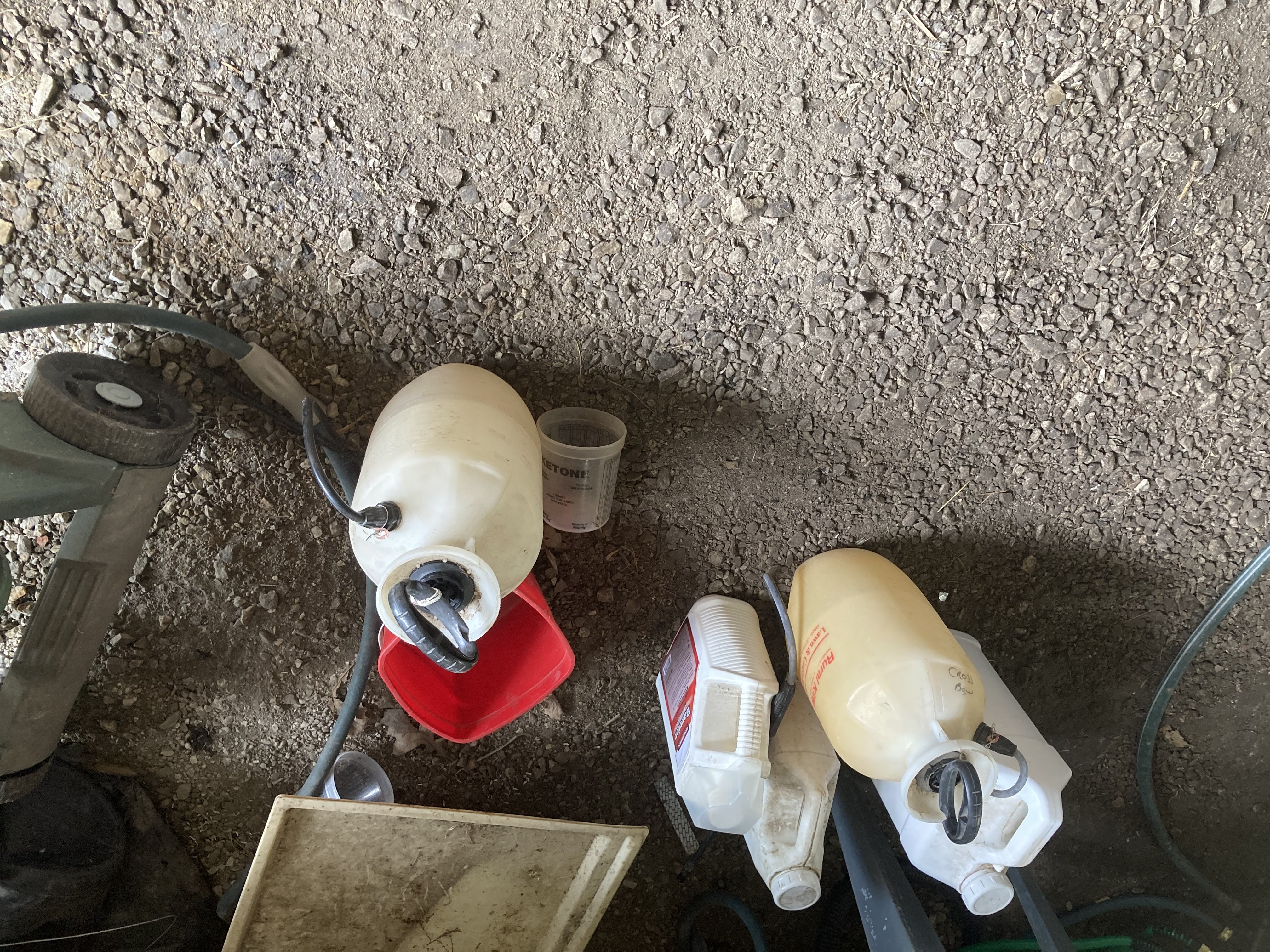

I still use a 2½G hand sprayer occasionally. The hand pump quit so I drilled a hole and inserted a car valve stem just below the neck. A quick visit to my air compressor pressurizes it in 10 seconds, enough so the over-pressure valve opens if I'm too slow, been using it that way for 'bout 10 yrs now.

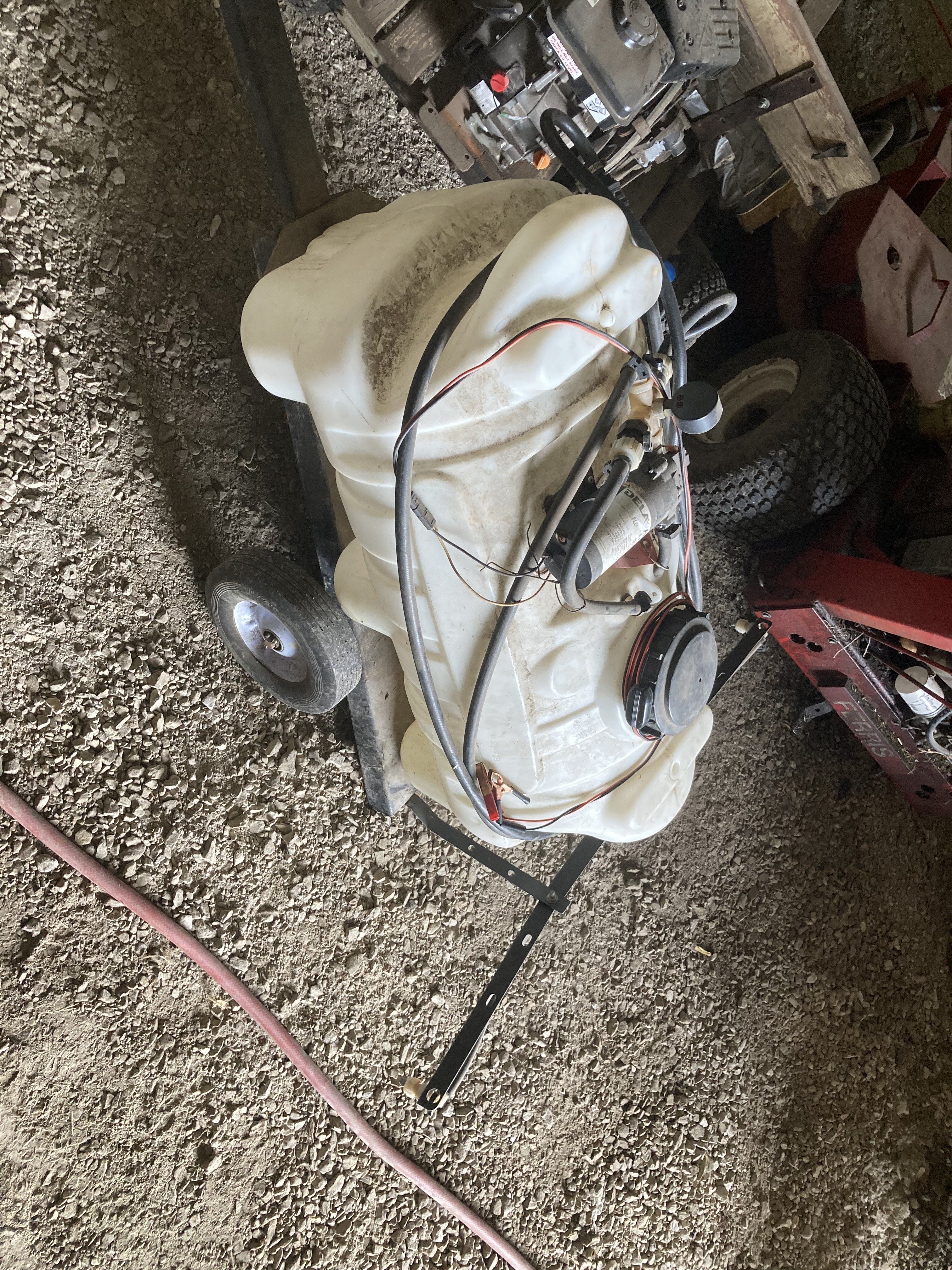

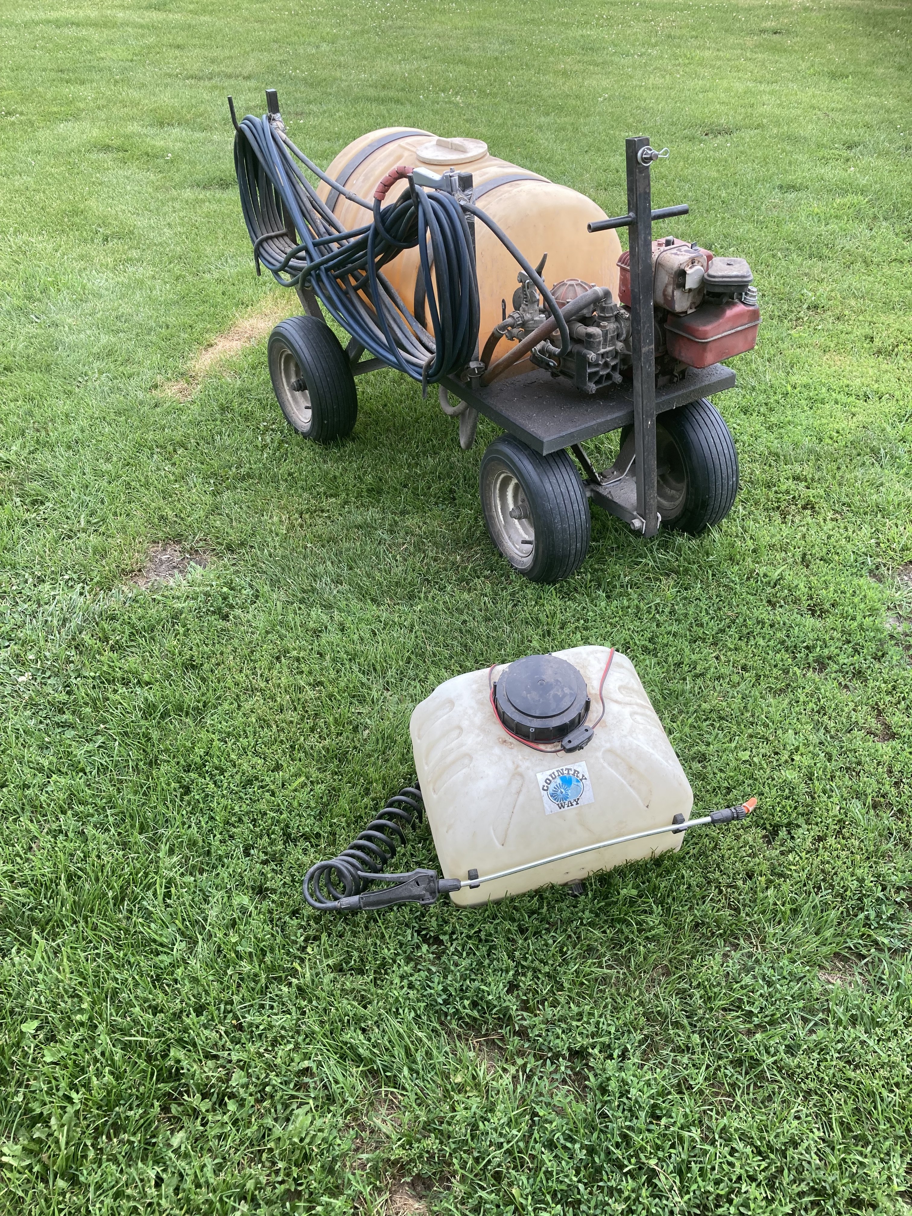

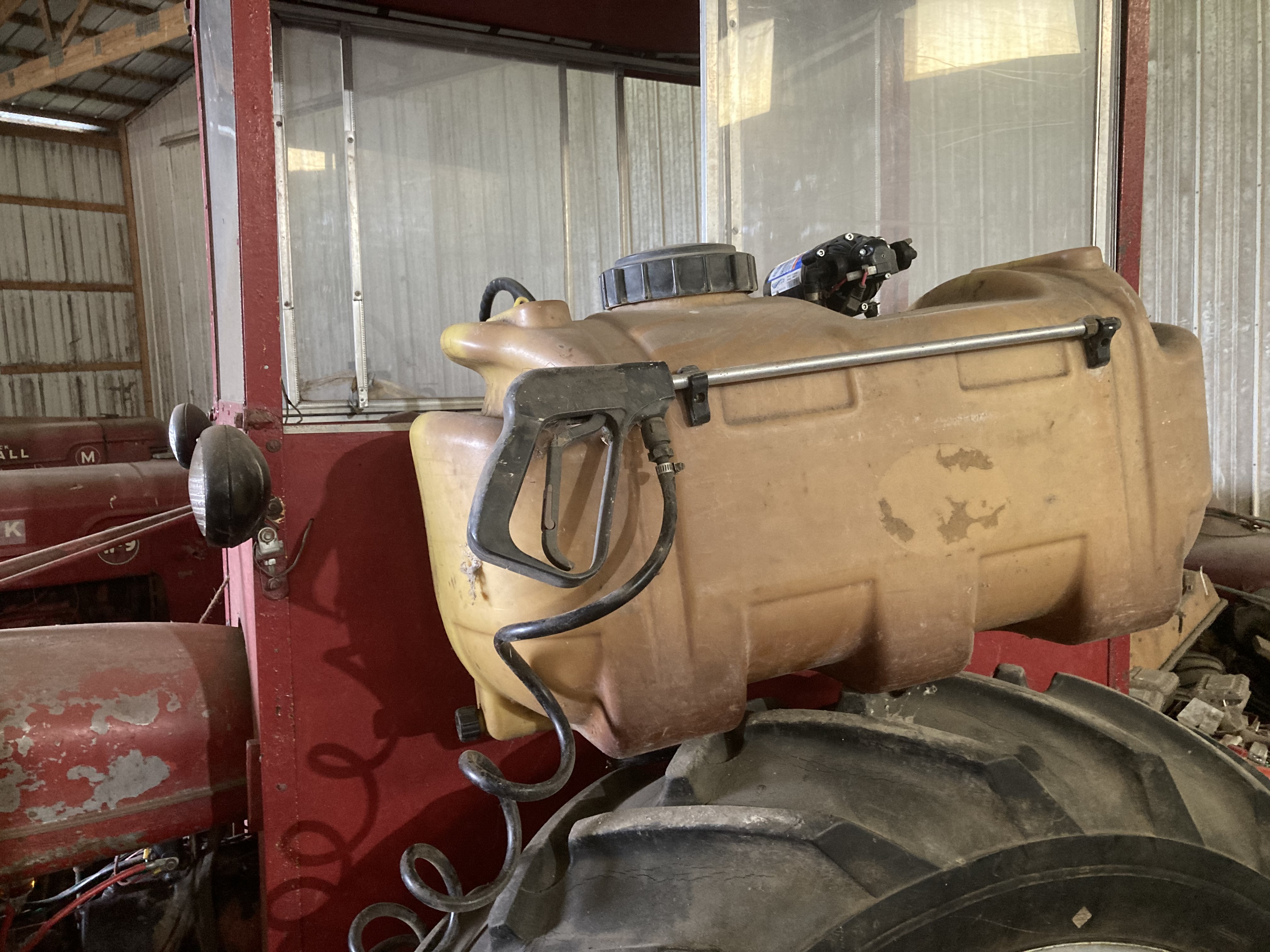

Every sprayer i have serves a purpose. The 15 gal electric on the back of the super a is great for spraying in garden. The 25 gal electric that lives in the back of the gator in the summer works great for spraying ditches, fences and wood trails. The 60 gal pto is perfect for spraying the grassland/cropland i use. The pump up backpack works great for getting to areas the other rigs will not. As example, used the backpack couple days ago to walk thru my gourds and spray round up in the middles where some weeds and grass was coming up. Vines too big to drive anything thru. And i forgot about the 1 gallon sprayer for spraying pesticides and such in garden when needed.
