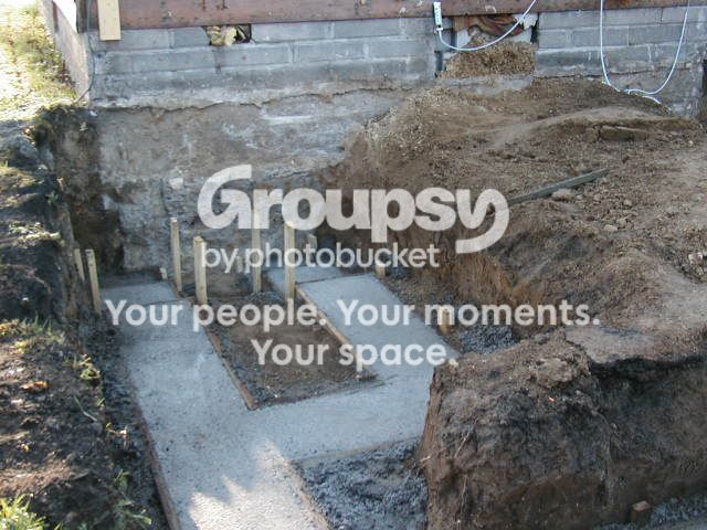

If you need to dig a few rocks, remove some tree stumps or dig a foundation rent a mini excavator.
They are great fun to operate and a couple of hours in the seat you'll be nearly a pro.
