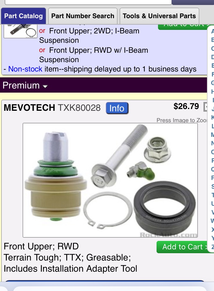

Thanks. I know you recommended a place for parts, but I’m looking at these ball joints from rock auto in their premium lineup. Any opinion on the brand?
No opinion other than I am going to do it as a once and done repair and not taking a chance on a product I have no history of. This has been discussed on professional forums its hard to beat OEM.
