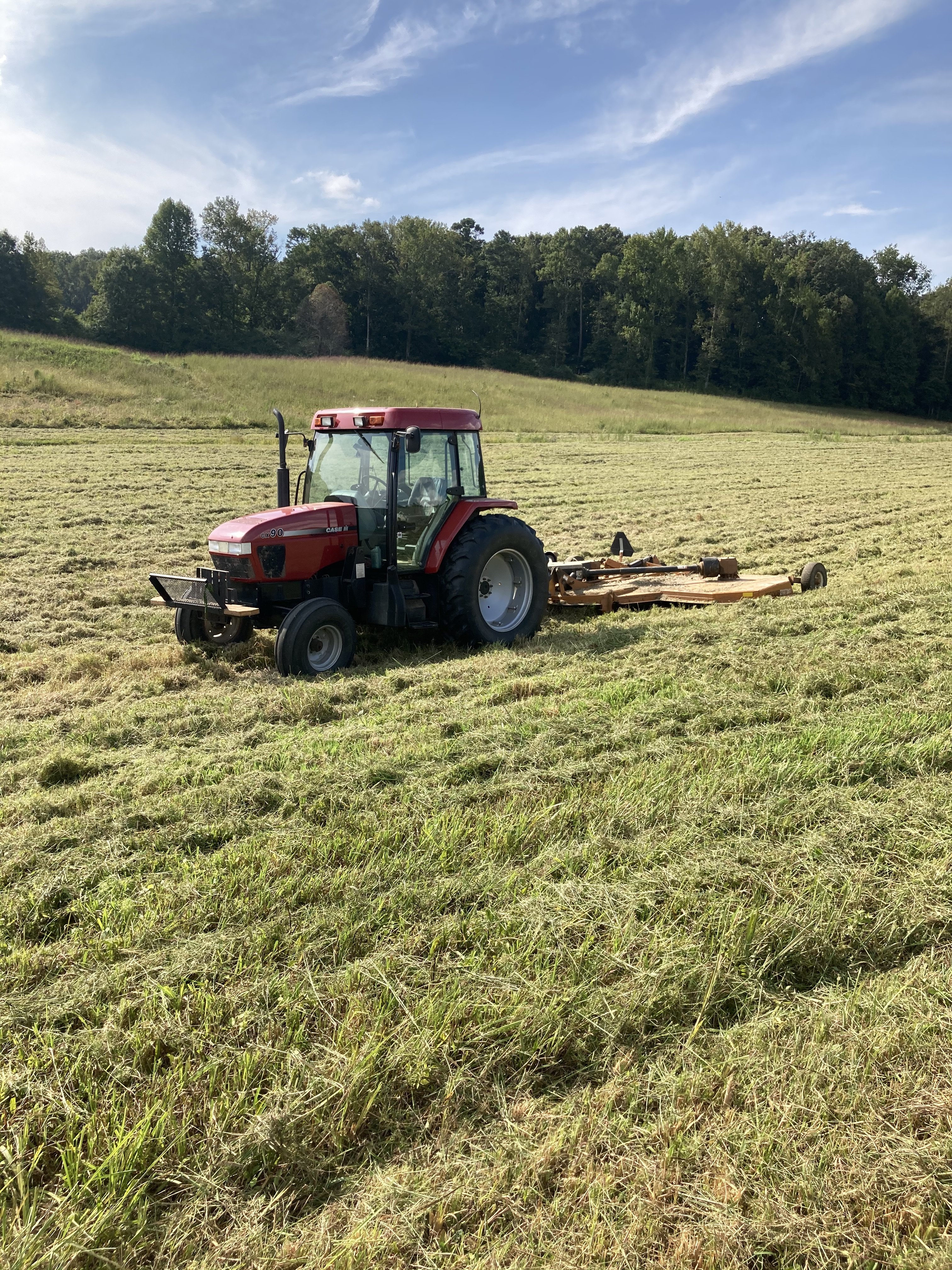

Run a 15 ft woods. Mowing grass 3 ft tall i run 3 to 4 mph. Full cut. Pulling it with a caseih cx90. 90 pto.
