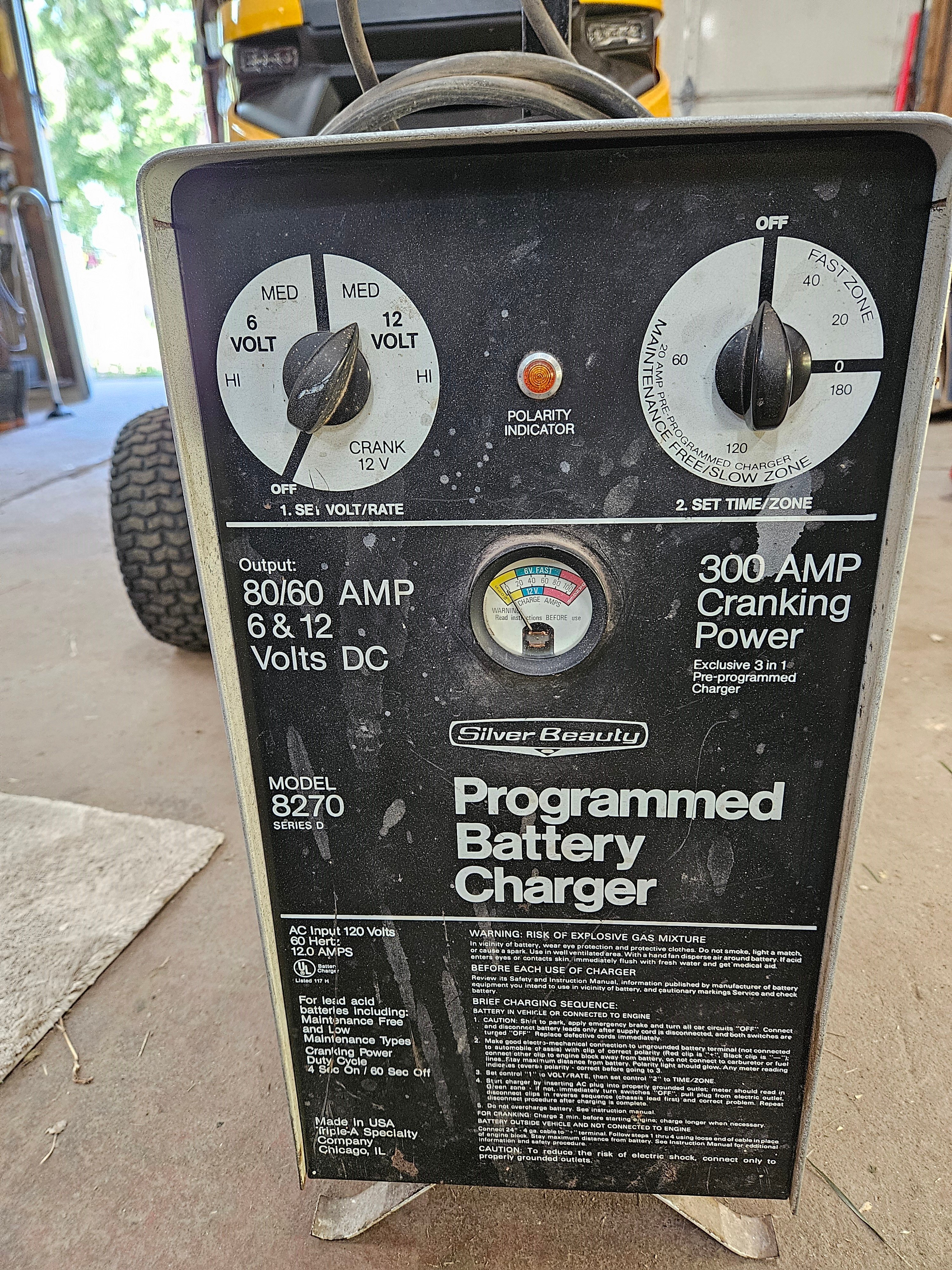

For years I’ve been using a wheeled battery charger that my wife gave to me as a gift about 50 years ago. (See first pic) It always did exactly what was expected, until a couple of weeks ago when I went to charge a battery and the fan on the charger didn’t com on. The charger worked OK, but the normally audible fan was conspicuous by its absence.

Meanwhile, I’d tried my old charger again and found it was again working normally. Why the fan didn’t run that one time, I have no idea. Maybe a switch wasn’t dropped all the way into a detent or something.
I guess I’ll see where this goes, and if my old charger acts up again, I’ll cross that bridge when I come to it. So far, I’m not out a dime. All the shipping both ways was free.

Dirt daubers just love to crawl inside equipment to build their nests. Most vulnerable are fan blades. Also had one electric motor burn up on a drill press because of a mud nest blocking rotation. Replacement had a screen shroud I built to keep pests out......air compressor and band saw motors too to name a couple more. Did that to numerous equipment around the shop.
On new equipment fan problems I would expect something else. My comment was directed at you old unit. I have a 40 year old Miller 130 200A stick welder that had fan trouble years ago....forget the fix but I didn't buy a new fan...had to be another kind of fix probably a dauber nest.
Usually the fan gets full of dirt and stops working after a few decades, opening it up and blowing everything out helps. I have a Schumacher/Craftsman wheeled charger that the fan quit on. Been quite a few years back but the transformer part that dropped the voltage for the fan went bad. I rewired it so the fan ran off of the output 12v and it's been working fine, the fan will run as soon as it's hooked to the battery if the charger isn't running.
I should have mentioned, in playing with my old charger, I pulled the cover off of the unit and blew everything clean with an air hose. The fan spun freely, and there was no reason, other than electrical, for it not to have spun that one time.
I have an old wheeled charger that I bought at an auto parts store about 40 years ago.
One fine day at the beginning of the mowing season, my lawn tractor exhibited signs of needing a battery charge.
So, I wheeled my charger over to it, hooked it up, and turned on the charger. What followed was a lot of sparking and then nothing.
So, I took the cover off. I could plainly see where the sparks came from - it was a complete failure of the diode assembly.
I looked into getting replacement parts, and much to my surprise, the original manufacturer was still in business, and even listed that charger as a past model.
I looked at the parts list to find that the rectifier assembly was no longer available. Further inspection revealed that the individual diodes were standard components, and were readily available - and not at all expensive. So, I cleaned it up, put new diodes in it, and it has been fine ever since.

Many of the new chargers will not start charging a fully dead battery. The built-in computer says no start without feed back. Fix is jump another charged battery to start charging until partial charge is in battery.
Goose, in the meantime, watch the yard sales and junk stores for those old 70's era can openers - the kind with the built in knife sharpeners. Those little motors were common in a lot of chargers.
