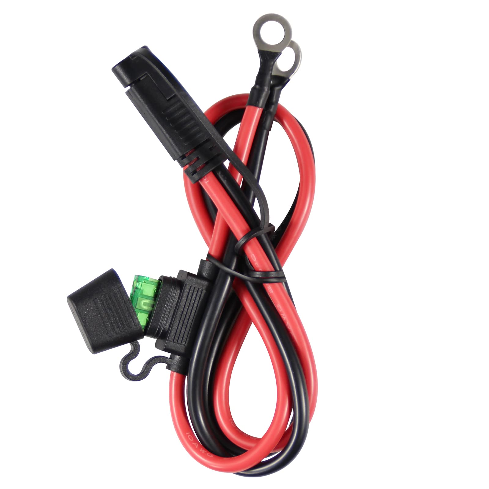

I install a quick connector that comes with the better trickle chargers. That way I don’t even have to lift the hood to charge.
