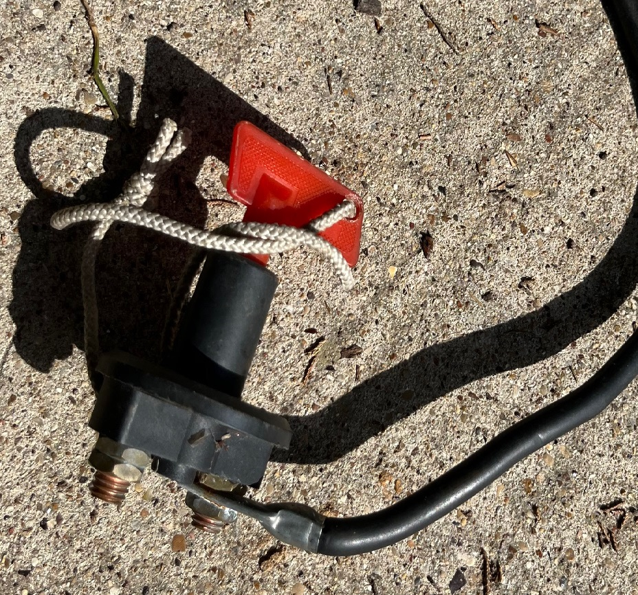

Use this type and battery post size/shape/etc. won't matter.

This what I use now
This is the one i use on automotive so far so good. Amazon
High Current Battery Disconnect Switch 12V 500A, Universal Battery Kill Switch for Car Engineering Vehicle Truck RV Trailer, Manual Battery Cut Shut Off Switch​
