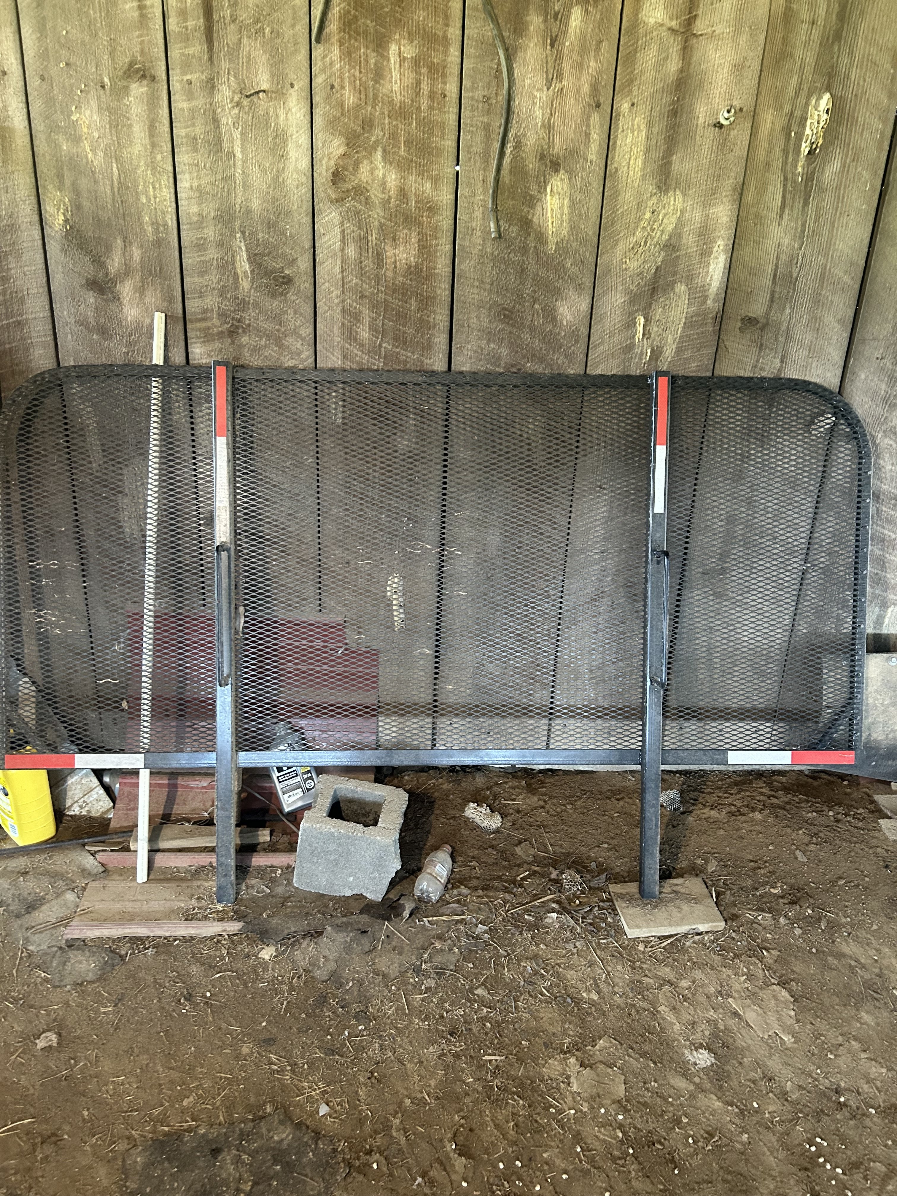

Bought a 15' batwing mower that doesn't have any type of deflecting guards on it.
Frankly not too worried about the rear, where I'm mowing (pastures) there won't be anything behind me.
But don't want rocks (got plenty of those) smacking me in the head.
Can get my hands on some used 7" baler belting. Fairly tough stuff.
I was thinking cutting across the belt 4" or so every 4" and bolting it to the front of the mower.
Should flex enough to let grass get underneath, but offer deflection.
Thoughts?
Thanks

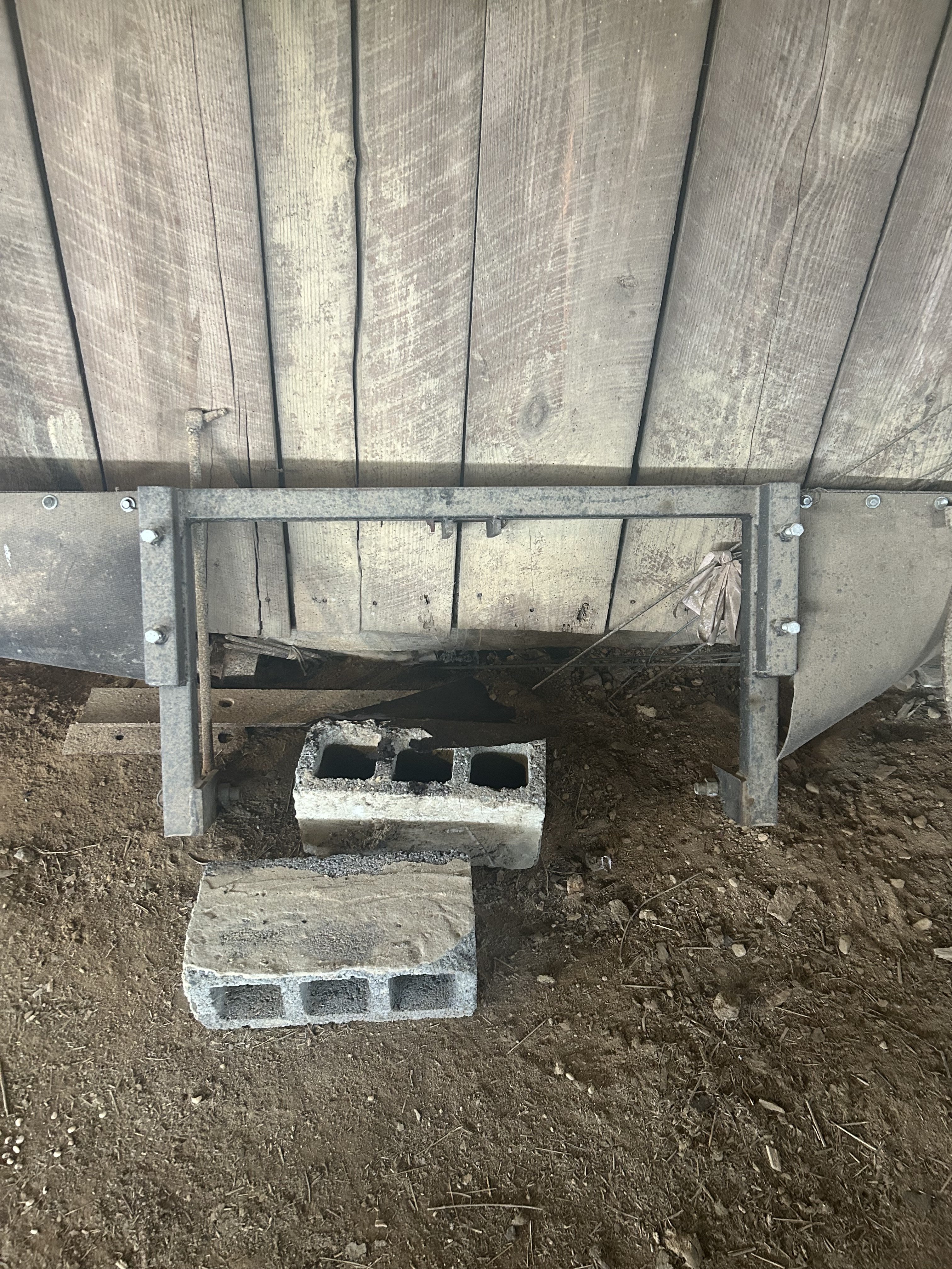

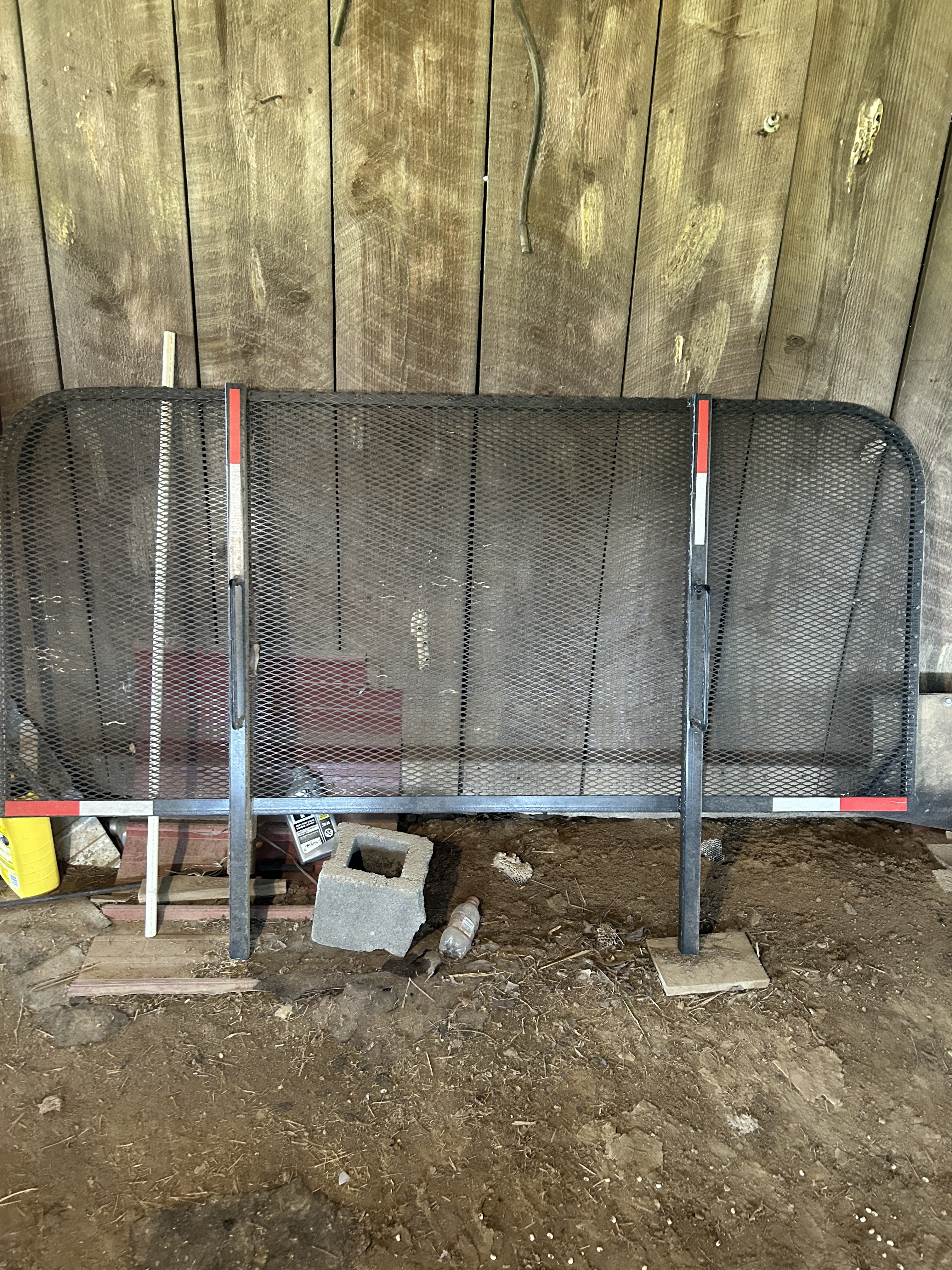

Have a woods brand with rubber belting on front. It is about 1/2 inch ir better thick. Wirks fine. I also built a screen to attach to 3 pt hitch when using it to prevent any thing from hitting cab.
