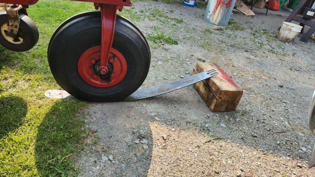

I was given this Stihl MS250.
I noticed it doesn't cut well, figured the chain was dull. Then I noticed the last six inches of the bar were skewed, bent. I put a straightedge on it: over a quarter inch crooked.
I wedged it in between heavy iron, tried bending it back: no go.
Can this be straightened with basic tools?
Or should I buy a new bar? If so: what kind? OEM Stihl, or an Oregon, or something else?
The saw will be used for firewood. Not a daily money maker.

Replace. They never straighten up properly; even when they look and seem OK, the slight bend in them will cause the guides on the chain to wear fast, get sloppy, and burn up chains frequently. As far as brands, doesn't really matter for thaf saw. The MS250 is a great farm saw, but it's still a smaller saw from Stihl's mid-range line - nothing you're going to use for logging hardwood all day every day, where bar hardness and longevity is more critical.
I would just straighten it out.I do them in a press in my shop,but all the loggers I worked for just straighten them in the woods.They make a slot straight down in the top of a stump,stick the bar in as far as it needs to be,and whack it sideways.I've seen a crew pinch and bend a half dozen bars in a day working nasty twisted wood.New choppers will bend a lot of them too.I have an assortment of new sprocket nose tips,and a bar facing table.Looks like a little table saw with a stone in it.You slide the bar against the stone to true up the surfaces where the bar rides.You could spend a fortune throwing a bar away everytime you did something stupid and bent one.

That is a laminated bar, made of 3 sections, 2 sides and a middle, spot-welded. Pretty much impossible to straighten. Loggers will be using solid, milled bars that can be straightened. Buy a new bar.
Fun fact, I straightened a Disston 2 man by laying one end over a block of wood and driving my Super C front wheel up the bar. That did not readily straighten.
