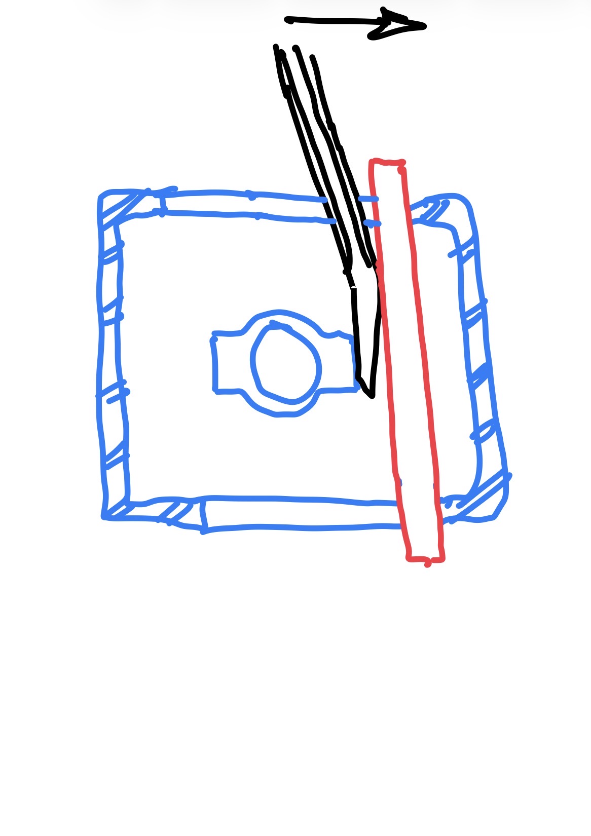

Thanks for the pics. My TO30 housing looks identical to yours. I see no signs of damage to mine so I wonder if the problem is a small amount of distortion in the bulkhead between the transmission housing and pump housing. It would only take about 0.020 to kick the housing end tangs over by 0.060 or more. My countershaft end looks identical to yours but again, there's no visible damage in mine. If the problem is indeed a deformed bulkhead, swapping parts won't help. Even if the problem is deformation of the parts, shimming should still work.
A more radical approach that might actually work is to put a heavy steel bar up and down between the top and bottom housing edges and use a long heavy pry bar.

Yes, pump cover is off. interference is clearly visible between the "starboard" ear and pump housing. Less clear is possible interference between the pump housing and transmission housing and vertical pressure tube at the bottom.
Excellent question if the pump will fit without the front PTO housing in place. I need to try that.
Wonder if you install the housing, then back off the 4 mounting bolts a bit, so it can be wiggled, then fit the pump in, then tighten up the bolts?

I think you've hit on the best approach to try. Once together and with the bolts tightened, the parts will hit but likely be close enough to the center. The lower PTO housing bolts will be damn hard to reach but my old tractor buddy and I have gotten into some pretty tight spaces.
