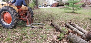

I usually cut mine 8 foot 6 inches or 10 foot 6 inches depending on tree. To keep them clean, even the ones for firewood, I carry them out on the forked three point lift behind my tractor. Dirt dulls a chain saw real quick.
