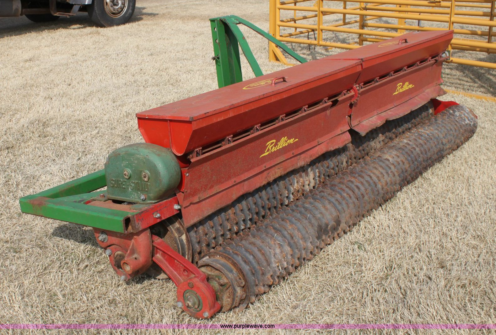

I use a brillion seeder. In my opinion they are the ultimate way to put down hay seed.
Only one I know (have used) seeder attachment is Oliver superior, it a grain drill. But at the Oliver hart part show in Wooster Ohio at the auction were two seeders . So they do exist , check if they fit you needs
These specialty grass seeding rigs are the way to go if you want to plant a lot of these seeds. I’m not familiar with how they work exactly in metering out the seed but clearly they are the tool to do the best job. That looks like one heavy piece of equipment. One has to consider tractor lift capacity and how to transport the seeder when you get into these machines.

Are you tilling first or overseeding existing sod? I've had experience with John Deere Van Brunt, IH-McCormick, Oliver Superior, Marliss and Lilliston grass boxes and none of their grass boxes liked fluffy seed like orchardgrass or brome. There needs to be an agitator in there for that kind of seed. Specialty grass drills like the Truax no-till have it but something like that would cost a lot more. If you're working the ground first, I'd go with a Brillion Sure Stand seeder.
Paul
My brother and father pulled a Brillion cultipacker behind a McCormick grain drill. The grain drill was easy to transport. The cultipacker... not so much. Had to be trailered from field to field. But. It was light enough, and we had the travelling welder dude that serviced all the local farms make a stone rack for the cultipacker. It came to the field light... and we would just go to one of the piles of freshly picked stones and load up the racks with some free "weights" and be off n running.
