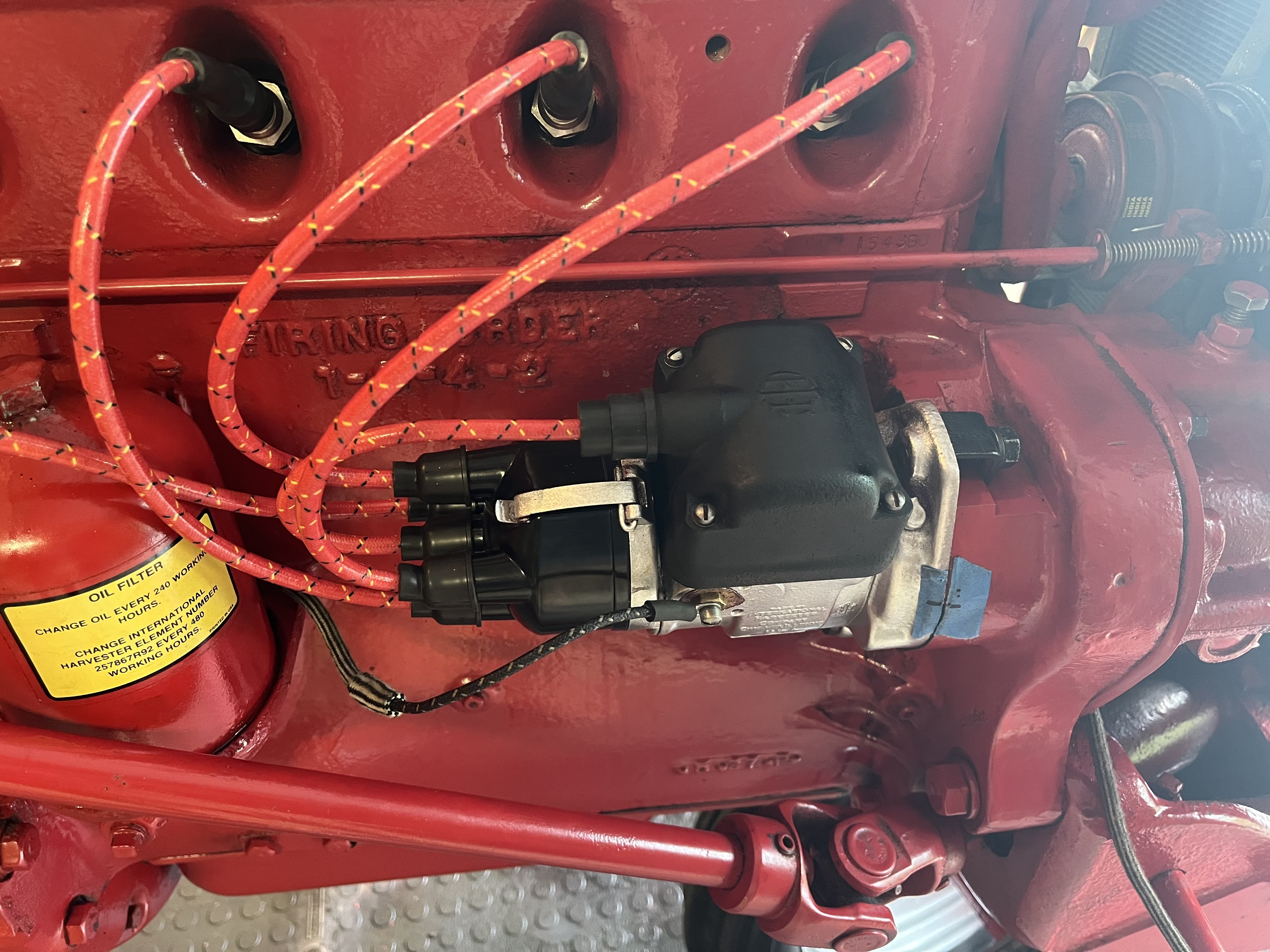

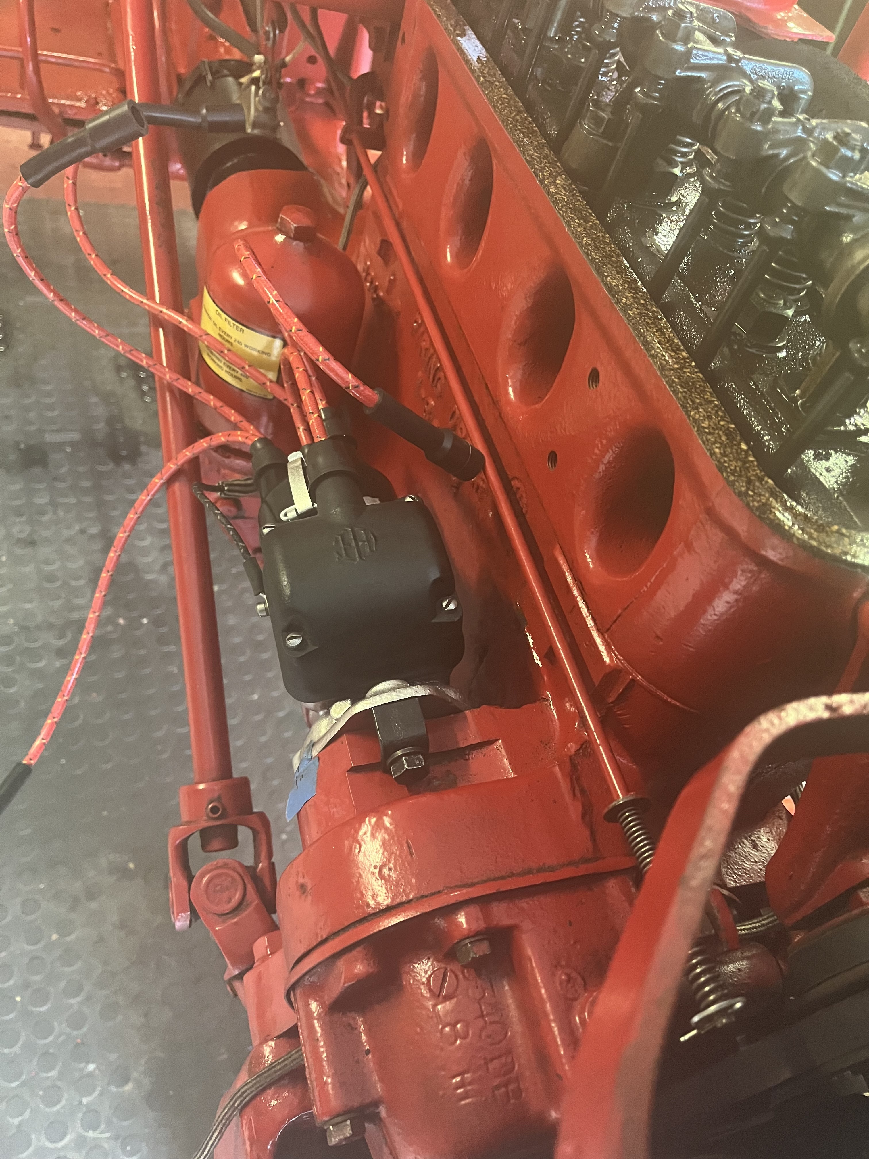

Hi Dave - I checked the timing, found the timing mark on the flywheel. It was off a bit (advanced), reset the mag. Still bucks and kicks with a load. With the new mag setting, however, it seems the coil is much further away from the block than I would expect it to be. See picture. Thoughts?
Jim

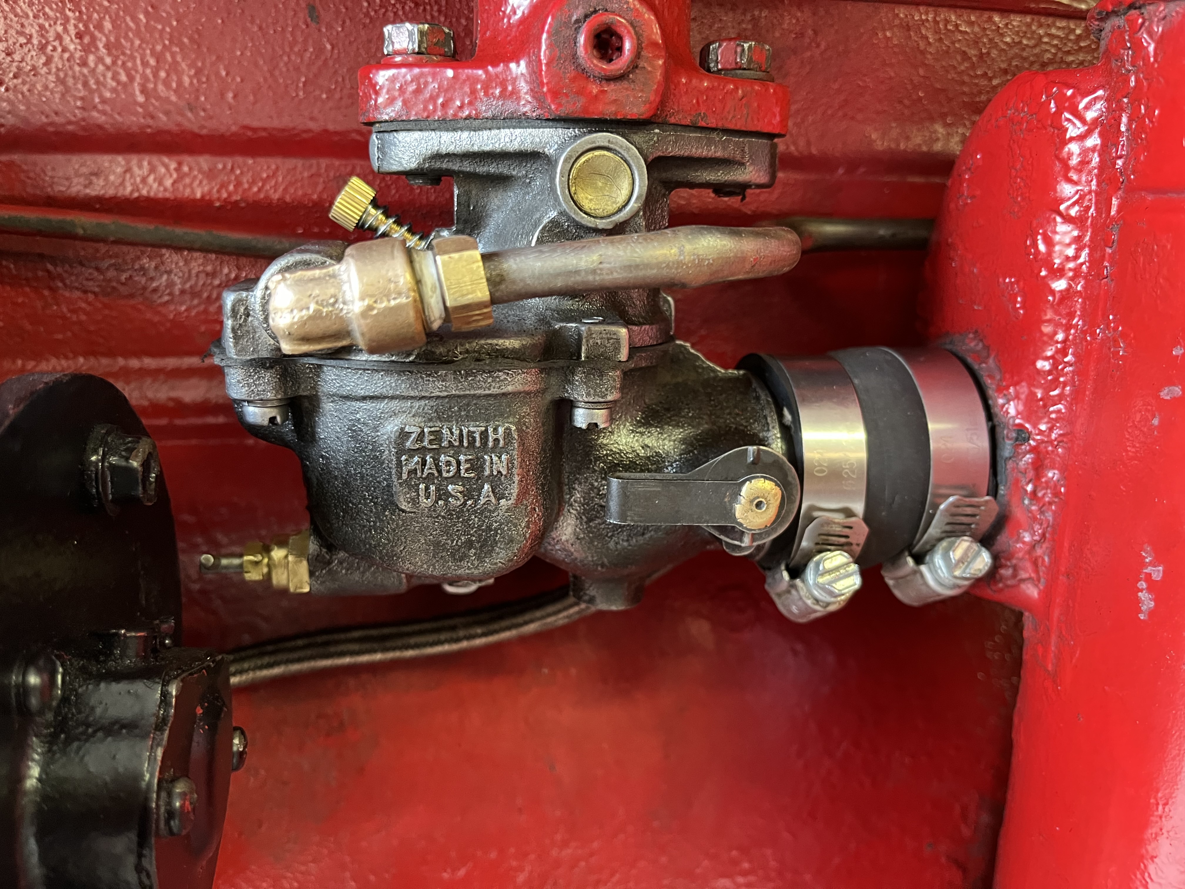

To everyone following or reading this thread… thanks. Problem solved! Runs beautifully , no hesitation under load, lots of power. The fix? Throwing the cheap, crappy Chinese carbs (2) in the trash. Finding an original Zenith carb, rebuilding and installing. What a difference - no more frustration!
