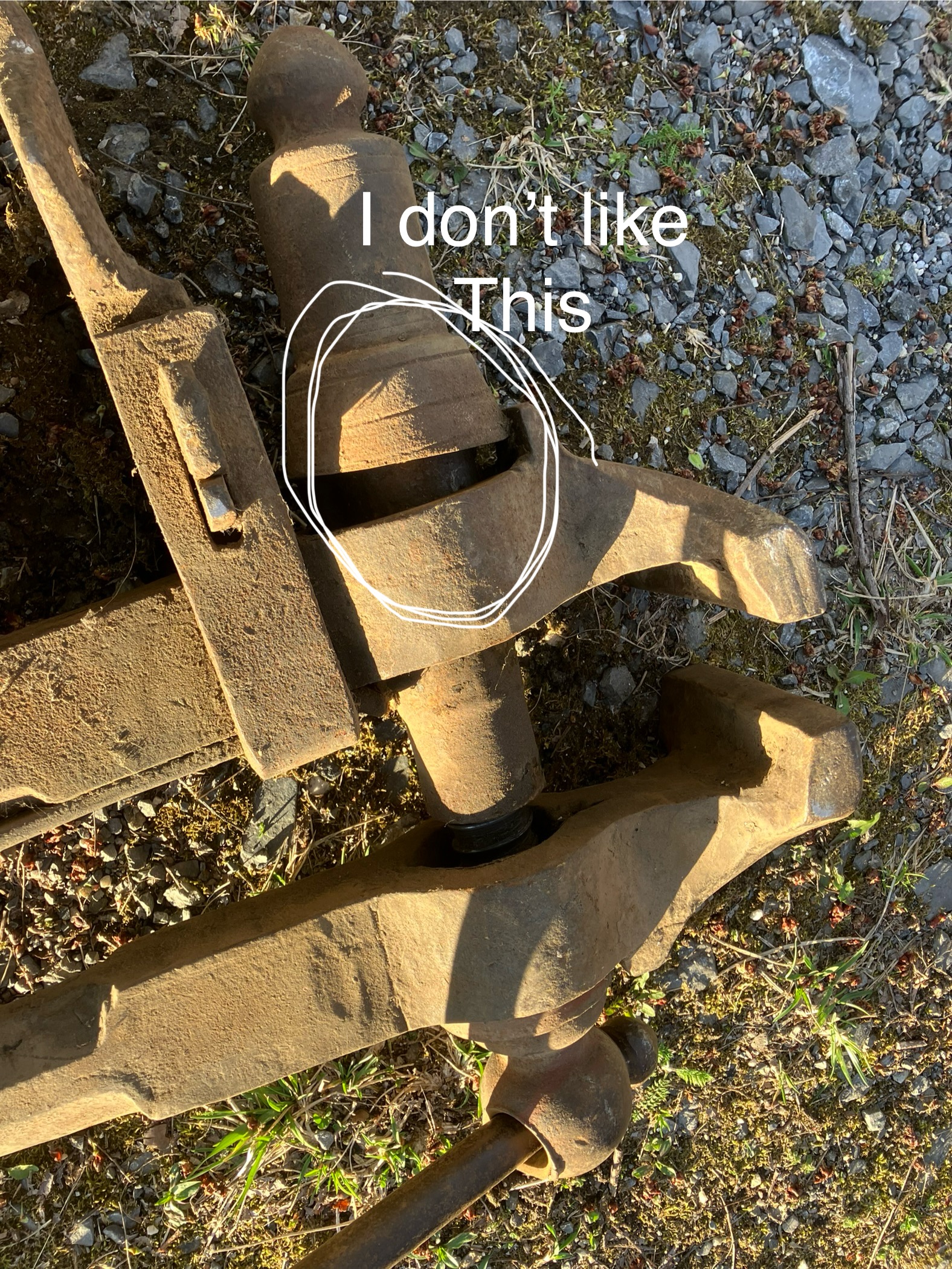

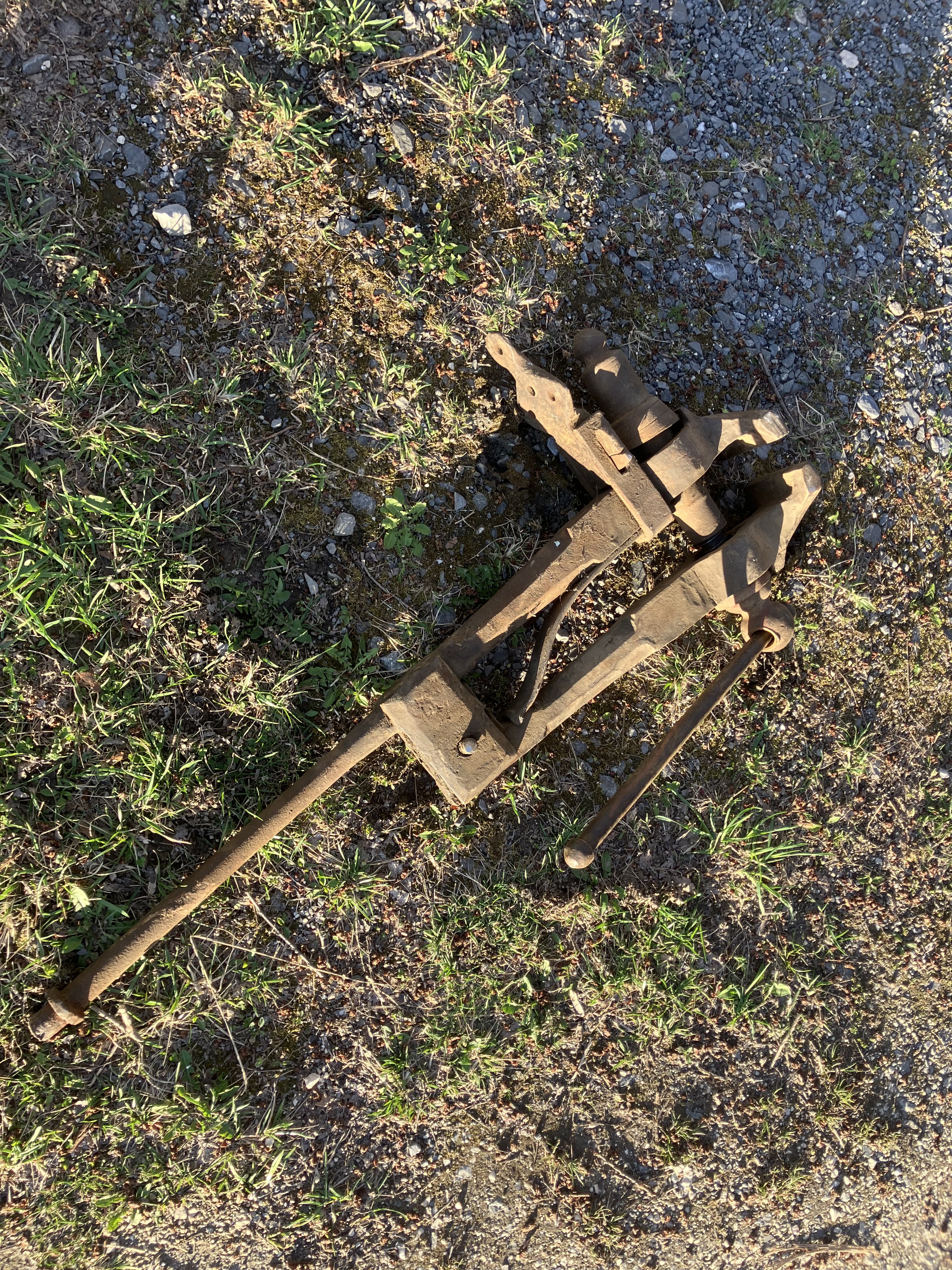

I bought this along with some other tools. It actually tightens and clamps down so far as I can tell but I don’t like the alignment in the photo. It looks out of whack. Just extreme wear? Bent shaft? Both? Not sure I’ll put it to use, had planned to mount it to something solid outside my workshop. Nice, heavy tool with some age on it. Thanks for any thoughts.
Normal. The pulling force touches gust at the top of the "keyhole" through which the "nut" passes. This is because the force is directed to close to the non moving jaw. The pivoting of the jaws together causes the actual jaw surfaces to be non parallel until they are at or near closed. at which point the "nut" will have nearly become flat to the non moving hole. But not quite. All good. Jim
Thanks for that. Just need to find a massive tree trunk or similar if I want to set it up.
You spreader spring looks like it might be a tad weak. Maybe have a crack in it or just weak.
I have one exactly the same as yours. They all look nearly the same except the mounting plates vary a lot.
You might want to place the peg leg into a hunk of iron. Like a lifting barbell weight or similar.

Spring could be weak. A tap from a hammer made the jaws open quickly.
Spring looks fine. They don't open up as wide and a bench vise because the front jaw pivots and would not be parallel to each other. Working with much more than an inch thick material the jaws will tend to let it slip upward. They normally are fastened to a bench with a hole in the floor or other anchor method for holding the bottom end. Like bolting to the top of a bench then having a pocket st the bottom or a ring that fits tight around the bottom end so it doesn't twist sideways or flop around when pulling or pushing on it. I doubt a tree or stump would work very well for it. We have one in the shed . It has a hole in the floor for the bottom end to set in with a pipe in the floor up around the leg.
