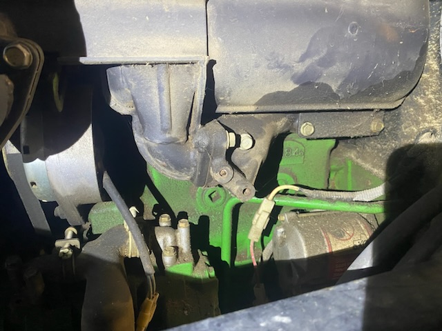

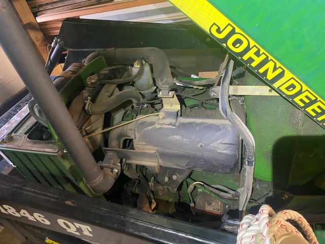

I want to install a block heater on a 790. It has the Yanmar 3 cyl diesel. I was looking at a parts schematic and it looked like there was a threaded plug I could take out and install a block heater. It was supposed to be either 3/4” or 1”. What I found on the engine was different.
On the injection pump side of the engine there are 3 regular knock out style freeze plugs. They look to be 1”. On the opposite side of the engine there are two plugs. One is threaded and the other is knock out. Those look to be 1 1/4”.
Anyone with a 790, where did you put the block heater? I’d prefer the threaded style. Pics show the side with the two plugs.

That’s the pic I was looking at originally. I saw those plugs on the pump side of the engine. Seems like they’ll be harder to get at with everything that’s going on on that side.
And it looks like they have an adaptor to install a threaded plug where the knock out freeze plug is?
I’ll have to look closer for any other plugs I might have missed

Doing some more research, there might be a plug behind the starter. At least on the 850 there is. I was reading another thread where you have to remove the starter to get to the plug.
I think the location for the adapter and heater shown in the parts catalog is on the right side, at the rear of the block, about the level of the injection pump.
Yeah I’m hoping that’s not my only option for this engine. I’m thinking the adaptor is because the coolant passage isn’t deep enough for the heater element.
View attachment 118View attachment 117
