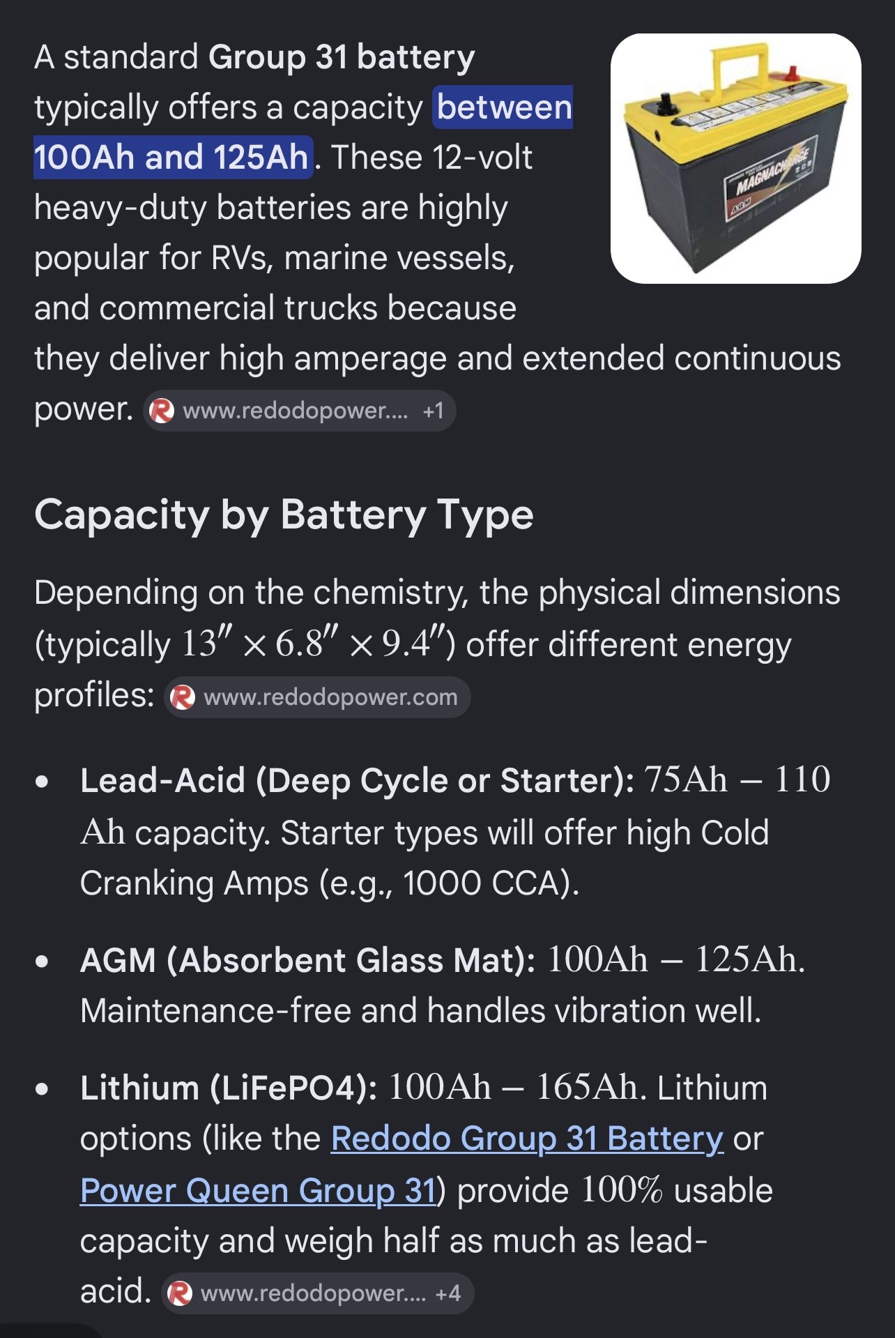

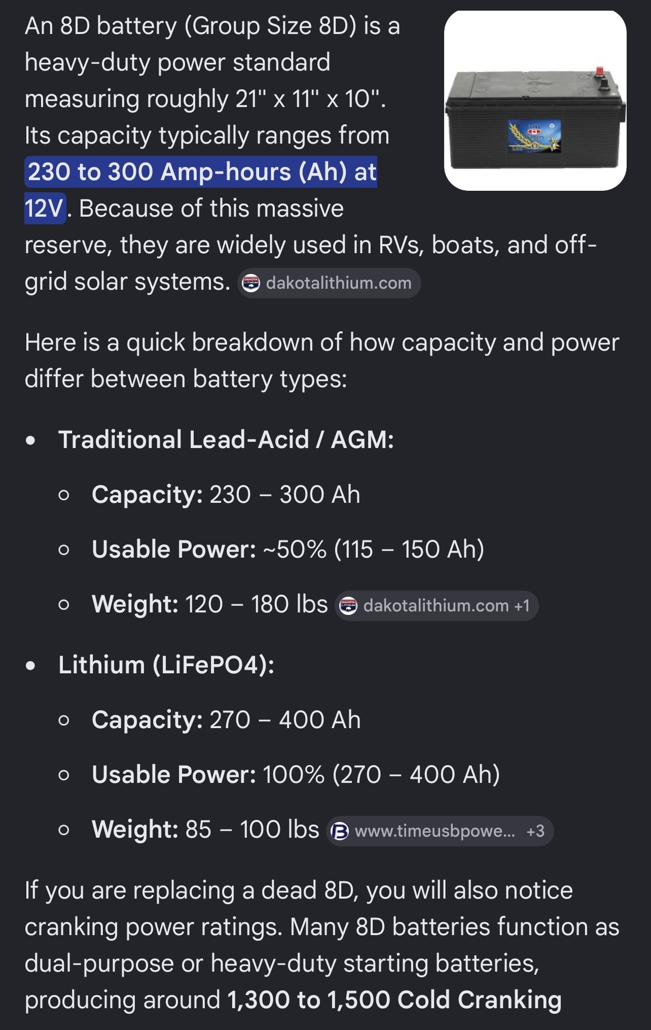

My boat has a pair of 8D batteries, one for starting and one for acceries but they can be switched together on an emergency. The problem I have is that they are in a terribly difficult place to get to especially as I get older. I have to change them and if I could get by with a pair of type 31 batteries?
Could install 2 or 3 group 31 batteries in the locations currently occupied by the 8D batteries ?
Could use lithium 8D or lithium group 31 batteries to save weight .
Lithium also allows deep cycling the batteries without damaging them .
Running a lead acid battery below 50% is not smart .

If they need changed, I would look at lithium for a boat. You can get a lot more capacity in the same size with less weight. Just remember that while all lithium batteries are good at deep cycle, not all are rated for starting.
