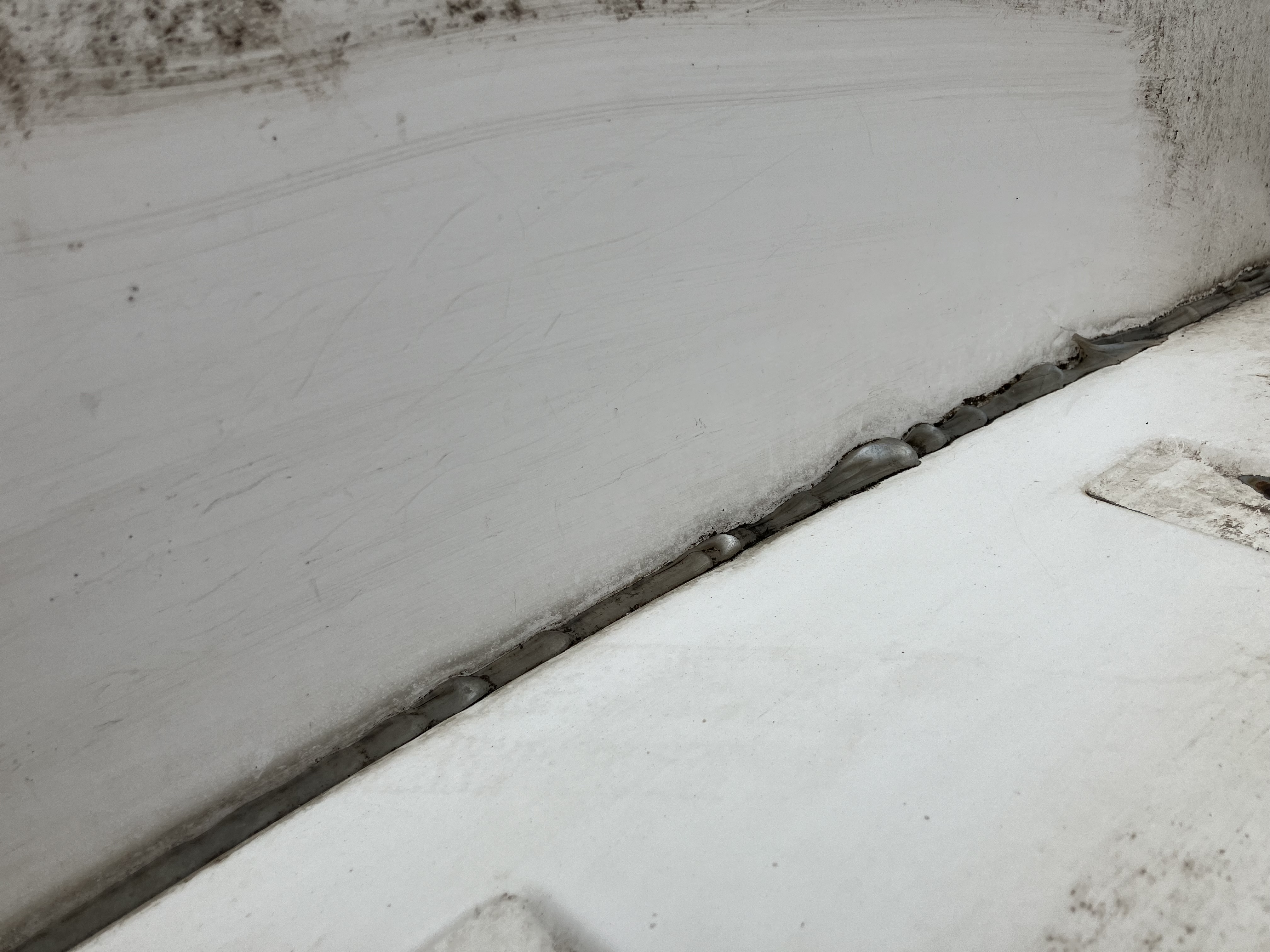

I have a box truck on a E350 Ford chassis I use for work. It’s been through a lot of storms with no problems but lately there’s a significant leak into the cab where it meets the box. Just take off the old caulk and clean the area then reapply or is there more I should be looking at? Thanks for any suggestions. Gerrit

A sealant caulk like NP1. There are roof repair tapes made for RV. box truck, etc., roof repairs. ZIP tape will last for several years on a trailer roof. A place that sells/ leases/repairs OTR box trailers will often have a sealant they recommend/use. Whatever you use the area needs to be cleaned, degreased, and dry before applying the chosen product (at least any I have used).

That's what most people would use, too. Clear household silicone. Totally wrong for the application. Houses don't rattle down the road at 70MPH on a daily basis.
Years ago I used a product called Dicor which is an RV sealant. Very sticky stuff. Household silicone won't stick to smooth metal. Dicor needs to be chiseled off.
Thanks for the replies. I looked online at some products, have a better idea what to use. On Monday I’ll call the shop that works on my truck—they specialize in medium to large commercial vehicles and their service person is happy to help with DIY questions. Here’s a visual of the sealant that’s on there now. It’s flexible like silicone.

Hard to tell just by looks, but it looks like a polyurethane to me. NP1 is a very good polyurethane sealant. The biggest part of the task is going to be removing the old and getting it clean, if you want to do it fully correctly.

Yes, I plan to remove the old sealant. I have a good assortment of scrapers and razor blades that should help with the job. Too wet out to do anything right now and I want to have the new sealant on hand before starting the job.

if you have a sawzall, there are many scraper blades available that make the removal much easier. also there are scraper blades for the multi tools that work well.
I called the place that works on my truck this morning. They said if I find something that works, to let them know. They were no help as far as recommending a sealant. I'll look into the products others mentioned here.
