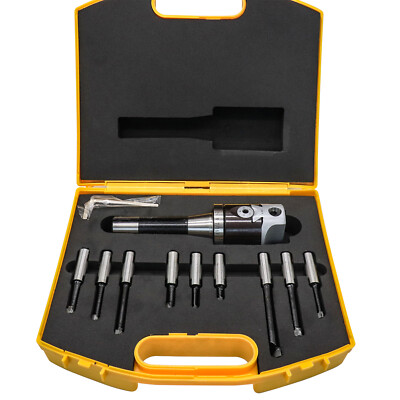

Here is an example of a low cost version of a Boring head with an R8 shank for a Bridgeport Milling Machine

@Brokengun: Bought that one just now. Been waiting for a good deal and at 67 bucks, it was A-OK. Thank you!
