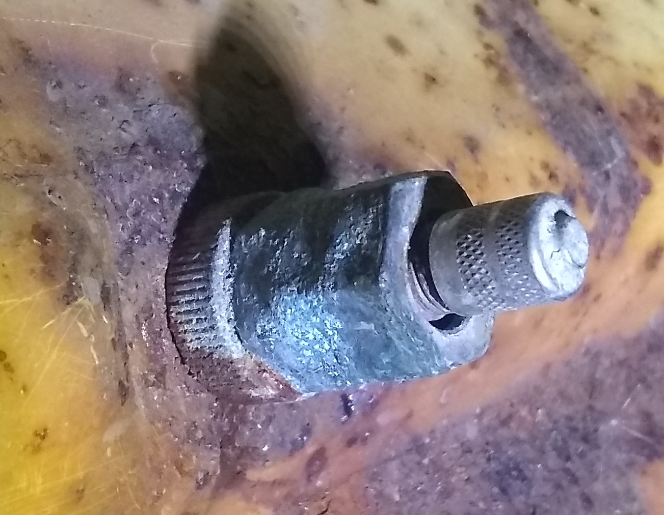

Broken valve stem fixable?

When they pull the tire off to replace the tube, take the rim home before they put the new tire on and weld a short (2" or so) piece of angle on the rim to protect the valve stem in the future. I don't have any pictures of ours, but if you google, 'tractor tire valve stem protector' you'll see lots of images of what folks have done.

I wouldn't try using any of the glue-on replacement stems. I used to use them (and still have some around), but if that tube is newer than about 20 years old, it probably won't work: Newer tubes have plasticizers in the rubber that prevents patches from sticking. Bit of a pain, because you can no longer patch a tube when you're in a pinch. Or rather, you can, but it probably won't hold up for very long.

For all of you who recommend "take the tire off and take it to the tire shop," this tire is, or will be, filled with Calcium Chloride fluid which weighs on the order of 11lbs per gallon. He doesn't appear to have a way to pump the fluid in/out at this time.
Does he have a forklift or skidsteer to handle a loaded tractor tire? We don't know. What we do know is throwing a loaded tire in the back of a pickup truck and taking it to town isn't something a normal human being can do by hand. Not to mention the fluid from the broken valve stem dripping all over the truck.
In this case if you can't do it yourself it's well worth the cost of a service call to have them come and do it on the tractor.

Several years ago I had a tire tear open on my 4020. I had a spare that was in decent shape except that the valve stem was broken off similar to yours. It used CH3 insert (the second type posted by Jim.ME).
I cleaned up the stem, and a new CH3 fit nicely, but there was nothing to secure it as the part with the internal threads was broken off.
I found a brass nut that fit the remaining external threads next to the plastic nut and silver brazed it to a brass compression fitting nut that fit over the smaller part of the valve stem insert.
The part I made has held the valve stem insert in place, leak-free for several years.

.View attachment 6105
That there is what separates the men from the boys.
