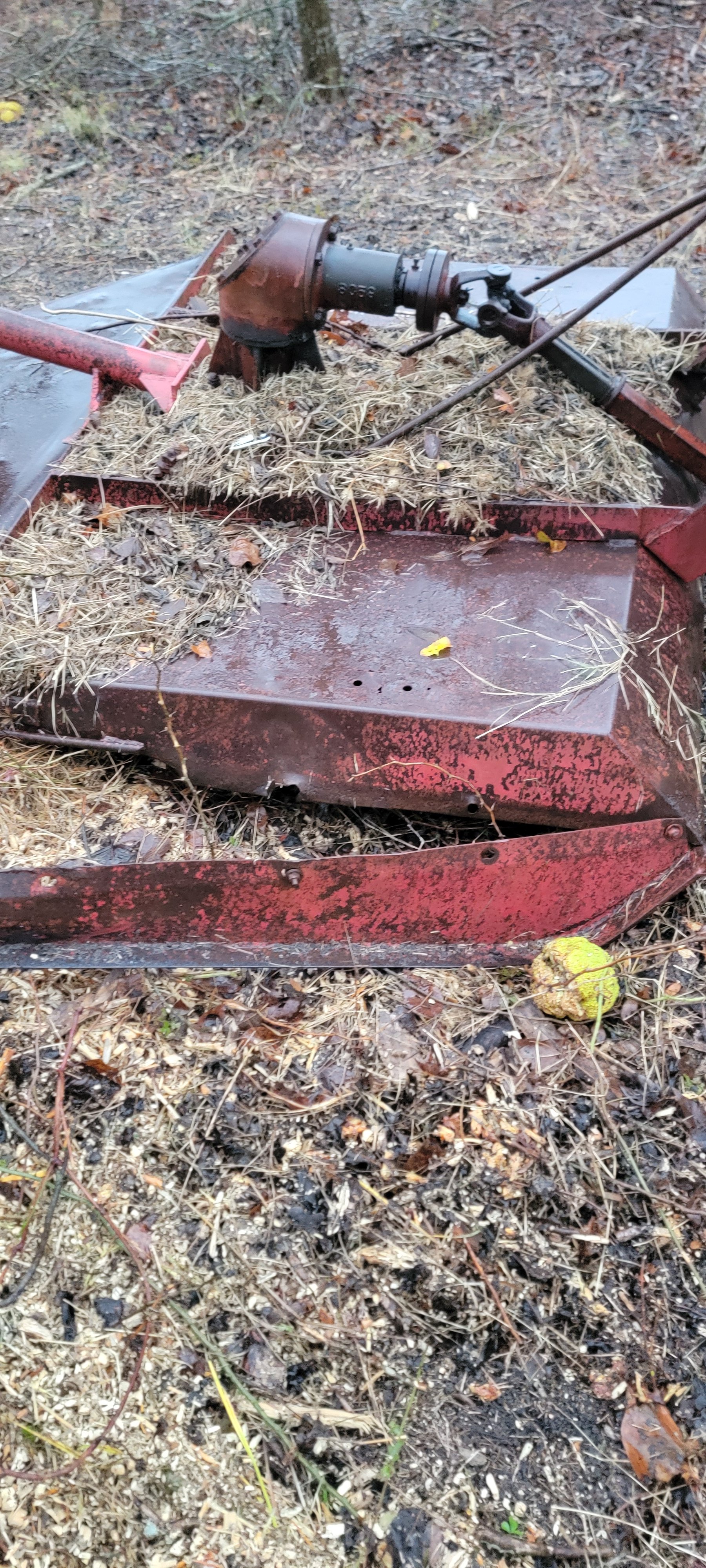

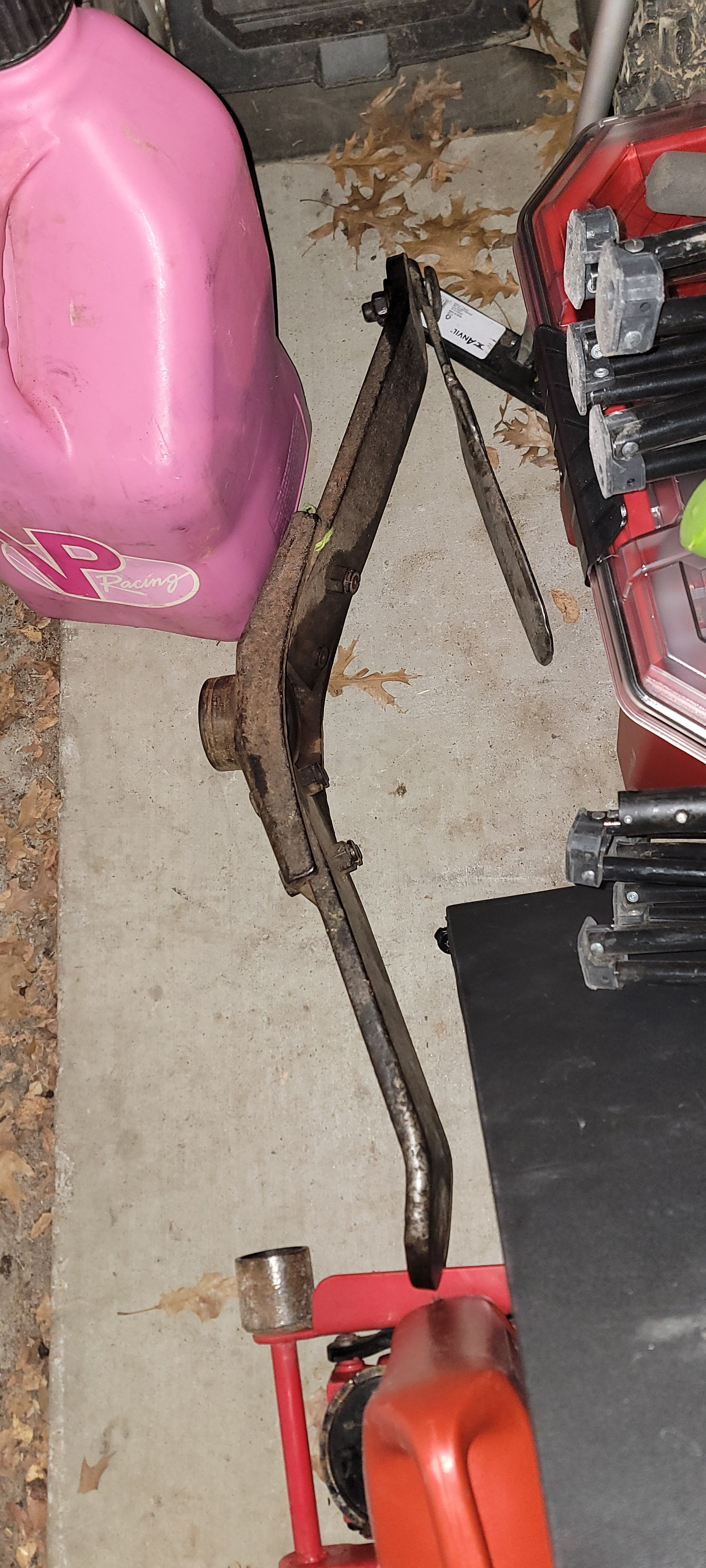

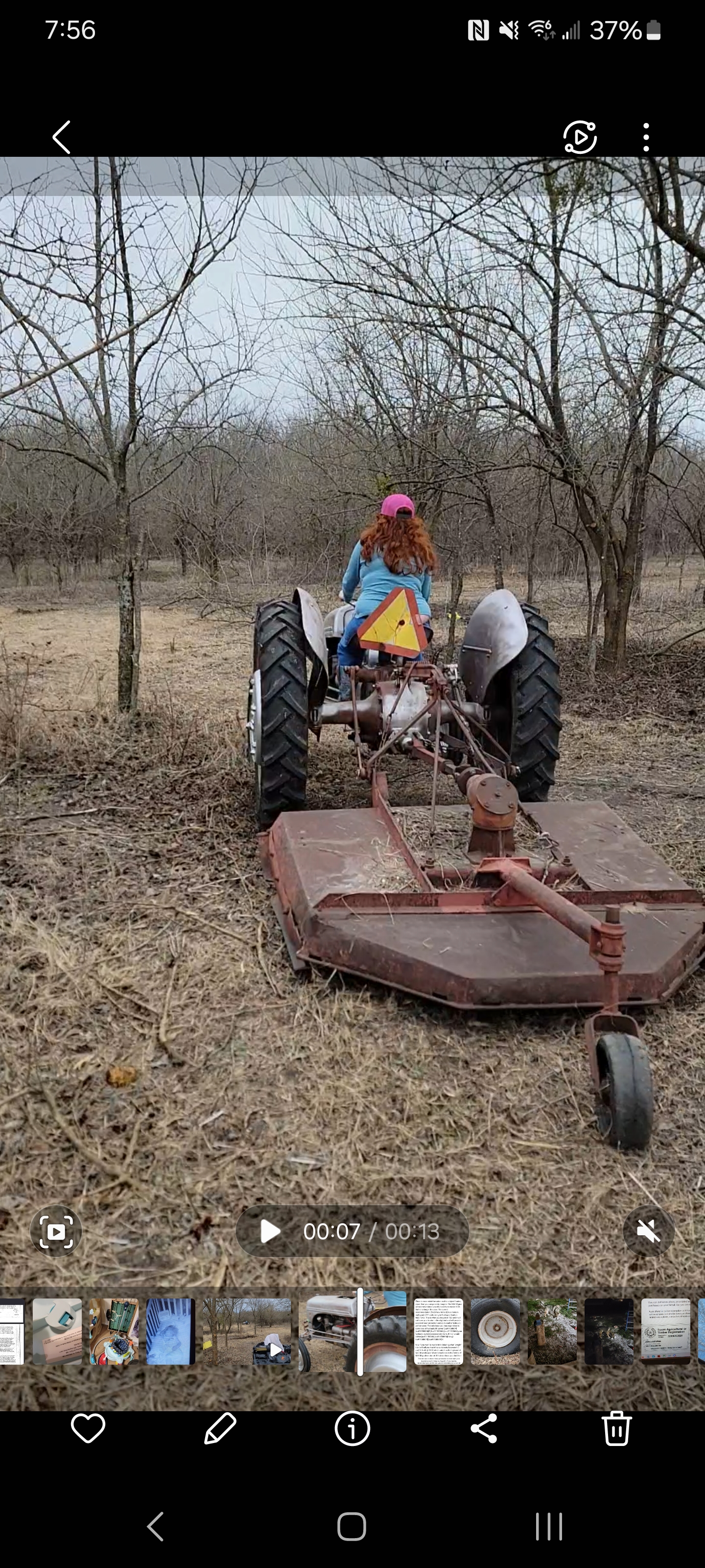

I have spent the last three days scouring the internet, looking at every picture I could find that matched my newly acquired brush hog. Nothing.
One of the blades snapped a bolt and flew off, so I was looking for replacements.
I couldn't find any gearboxes that had this slant, other than an international and a bush hog, but neither had the bolt in the center. The stampings on the gearbox say "permasteel", "T3M". On the blade holder, it says "48104-1".
Blades are 15 3/8" long, 48" deck.
Thank you!
I did repair the skirts already.
That cutter is a Servis that was built in Dallas, Tx on West Singleton Blvd & company was owned by the Austin Bridge Co. I visited the Servis Factory several times in the Mid '60's to early 70's picking up new equipment & parts. Name was changed to Rhino & factory was moved to Seguin, Tx. Company was purchased by the Alamo Group. If your rotary cutter is a 5 ft cut model I think it's a model E-60. I remember the shear pins came from factory in a small burlap sack 50 or 100 count. 3pt & pull-type shared same cutter frame just required different hitches & axle/wheels.

regardless, I would measure the bolt, and the blade and search for a replacement based on the dimensions and shape. And would probably buy a pair... AND there are left handed thread shredder bolts out there.
You appear to have a "straight" blade, of a certain length and width, and thickness.....with a x diameter hole in it. And maybe a bit of twist for uplift. A longer blade could be cut down if needed.
Tractor Supply has a selection of rotary cutter blades and bolts on the shelf. Take an old blade with you and see if you can match it up.
Also that is a rotary cutter or rotary mower, NOT a "bush hog." It can handle small twigs and shoots, but don't expect to be chopping down 3" diameter trees with it.

Maybe not a "Bush Hog"; that's a brand name, but it appears to be a typical brush hog (rotary cutter) of that size by the looks of the blades and gear box. I think it is capable of tackling some fairly good sized saplings......takes a pretty tough brush hog to go through 3" trees especially if they happen to be hardwood.
I agree, it looks like a Servis E60 lift type. That gear box could be off a Gyro model however. I don't know if that was put on the E60 model.
I can't tell you how much I appreciate you. This was driving me crazy. Which of these buttons sends you a beer?

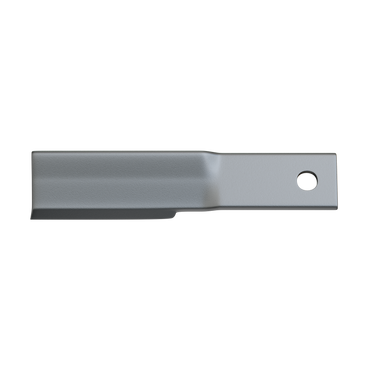

Agri Supply has a 15-1/2" x 3" x 1/2" straight blade with 1-1/2" dia. hole.
Only $20 !! that is cheap with steel prices today.
So close, but the bolt hole in the one I have is 3/4 inch. Tiny compared to the ones today!

Now I can't find replacement blades or bolts! $5 to anyone who can find me a (max)15.75" x 3" x .5" with .75" hole, and 14" from hole center to tip, and a pair of .75" wide bolts, 1" of thread x 2.5" overall.
I thought about welding a few plates over the holes on the old blades and redrilling the 3/4" hole, but that leaves me without new bolts. I could drill out the blade holder bolt hole to 1 1/4", and use the new blades. OR I could buy a new blade holder. What is the technical term for the thing that holds the blades? Should I just get a new gearbox and blade holder assembly? Really don't want to spring for a new mower. The cheapest ones are 1700 bucks, and used ones that "need work" are over $700!
I don't know if these will work but:
