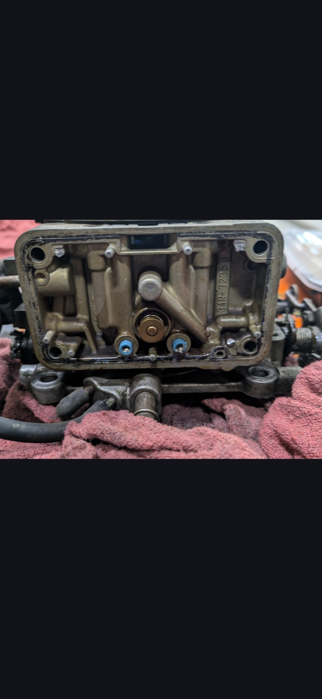

Bullet connectors for jets
Fritz Maurer
Well-known Member
In an emergency.
It looks like the primary side of a Holley four barrel. I have never seen anything like that, maybe some kind of anti-tamper device. I used to run jet extensions in the primary to prevent the jets uncovering when leaving the line. They were just a brass tube that pressed over the jet. Maybe a different type of extensions.
The answer is a roadside repair in the desert 2000 miles from home. Carb had an ethanol adapter block to burn some cheap fuel in California. Required removal of the jets with this adjustable block in their places. Block began to disintegrate on the way home...my son had all his parts except no jets. He did have a handful of electrical stuff and decided to try these connectors. It worked well enough that we drove the thing around for a couple years until recently the power valve let go and he had to put the right parts in.
The only driveability problem was that it had a dead spot just off idle and made feathering the clutch difficult during precise backing.
Other than that it ran great.
1974 GMC one-ton
350 cid
4150 holley
