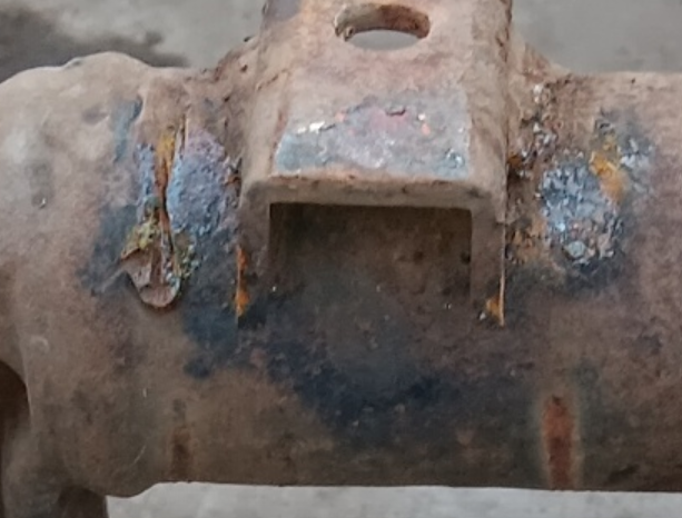

I had the loader tractor on my trailer and broke a 6K axle on my trailer two weeks ago - two blocks from the house.
I unloaded the tractor and drove it home. Then walked back, pulled the tire off and limped the trailer home.
Someone was looking out for me that it didn't occur at 60 mph and 60 miles from home.
I decided to replace both axles and put new walking beams, U bolts, saddles and new bushings and shackles in the springs.
Talk about the cost of living going up.
Over a Grand right there.
I had just replaced the brakes - drums, backing plates, bearings, etc and new breakaway kit last October. I'll get that stuff back on maybe tomorrow.
Hopefully I'll be done fixing on it for a while.

I'm no authority on the subject but wonder what if anything welding heat's effect on tube to spindle bead contributed to breakage. I would think spindle was welded onto tube then as saddle was being welded the bead holding spindle was heated. A question that begs to be answered is "would a cap bead tying previous beads together help prevent this"? I suspect it would.
That had been repaired before by someone. Those saddles weren't welded like that in the factory either.
I wondered about that too.
Used homebuilt trailer I bought 15 years ago so who knows. It has been good to me tho. I've pulled it a lot of miles and hauled some pretty heavy loads.
Was using the FIL's gooseneck and noticed the evener between the axles didn't look right. Took it apart and the bolt on the pivot was 2/3 gone on one side and 1/2 gone on the other side. Glad I caught it before it broke, doubt he would have seen it, trailer was used when he bought it. Shocked him when I showed him the parts.

looks like a groove was wearing in on the good one in the same spot where this one broke.
