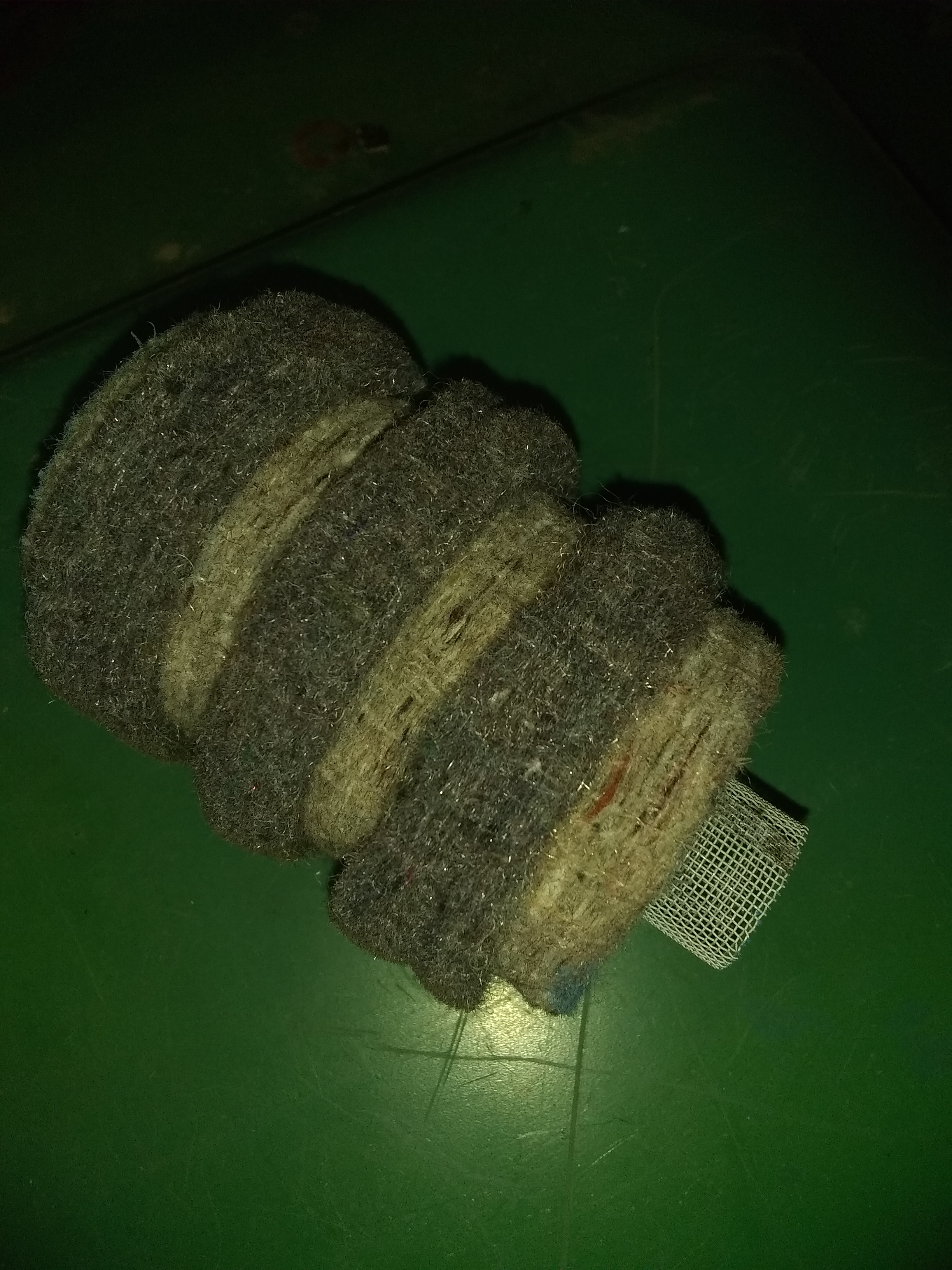

The earlier M&W turbos used a felt disc filter in a canister, the later ones used a spin-on filter.
Even though the "media" (in the cartridge version, for sure) may be of the same type used in some bypass filters they are plumbed in as "full flow" filters, filtering all the oil that goes to the turbo bearings.

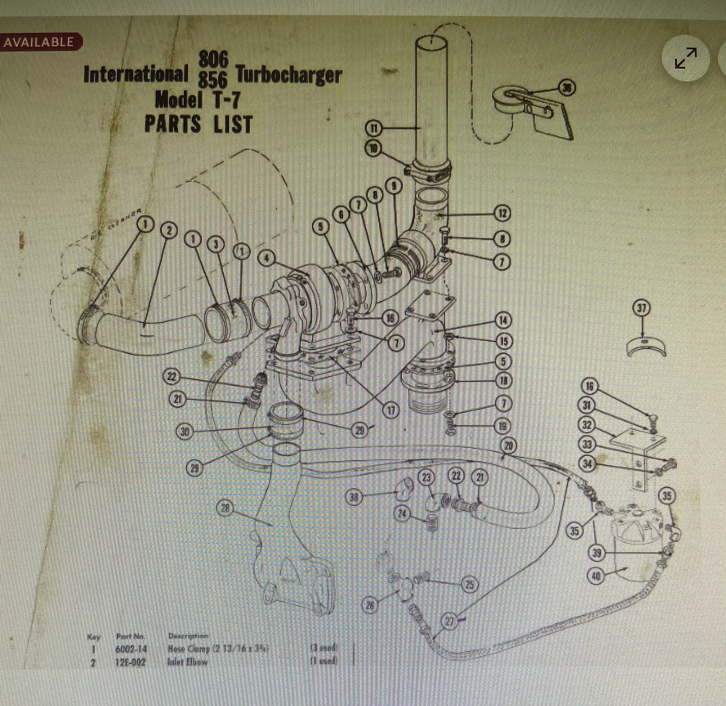

Not to sound snarky but M&W turbos are 1970’s technology. Mine uses a Wix 51052. Here’s a diagram on line for an IH 806. No. 40 is the by pass filter piped into the turbo. The full flow filter feeds the entire engine. The by pass feeds the small turbo bearings without robbing the engine.

NOT sure why you are calling it a "bypass", it's simply a lube line from the main oil gallery to the turbo and DOES "steal" a little filtered oil from what is available to the engine bearings, WHAT does it "bypass"?

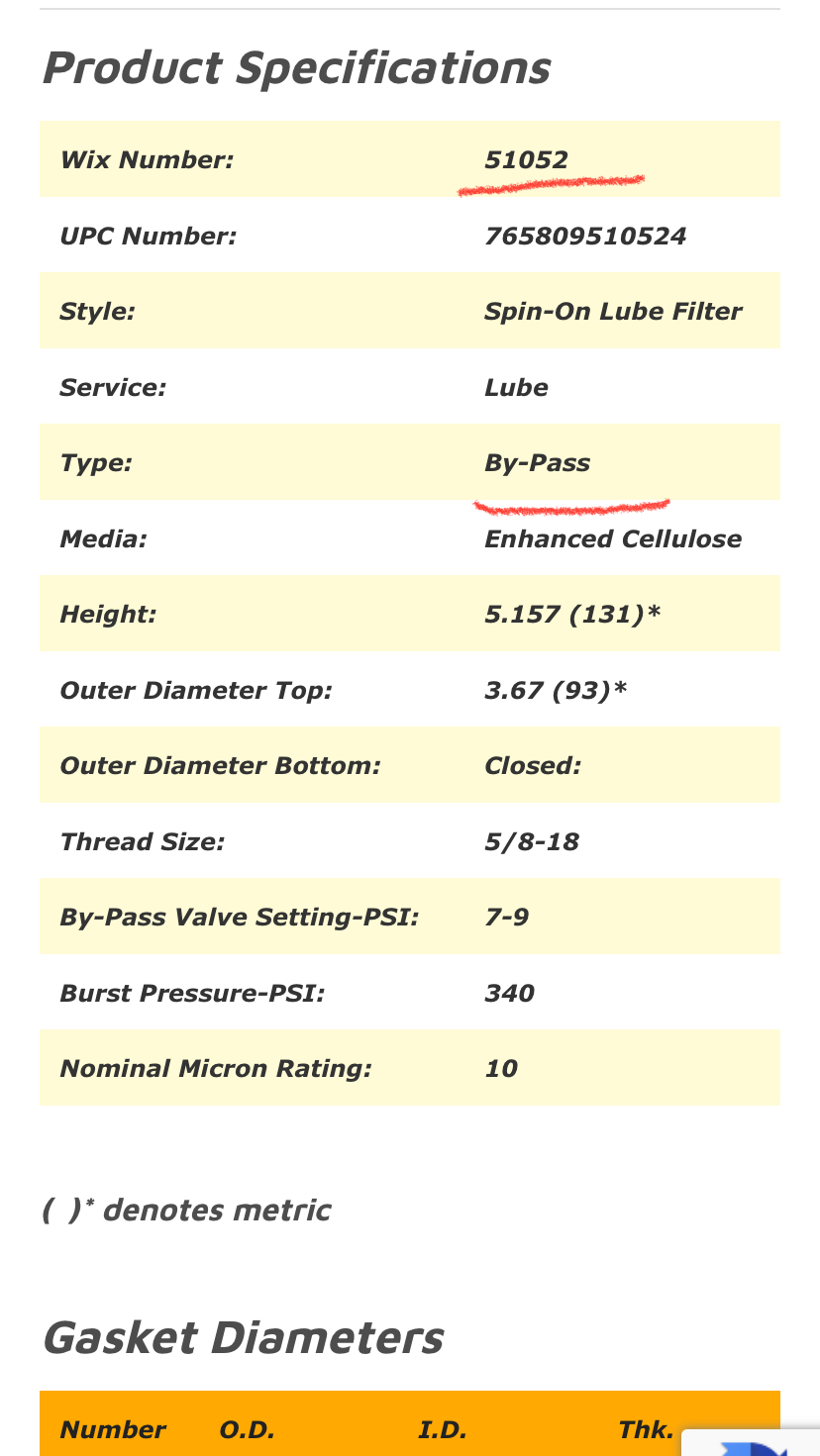

Wix 51052 is a by pass filter. They call it that, not me. But it’s also a 10 micron filter. Does my 4230 turbo oil filter keep my oil cleaner? Yes, it must. Should I consider installing a similar by pass oil filter on my other tractors? Good question.

We are talking here about a filter the M&W turbos were installed with that filters the flow of oil from a port in the oil gallery to the turbocharger bearing.

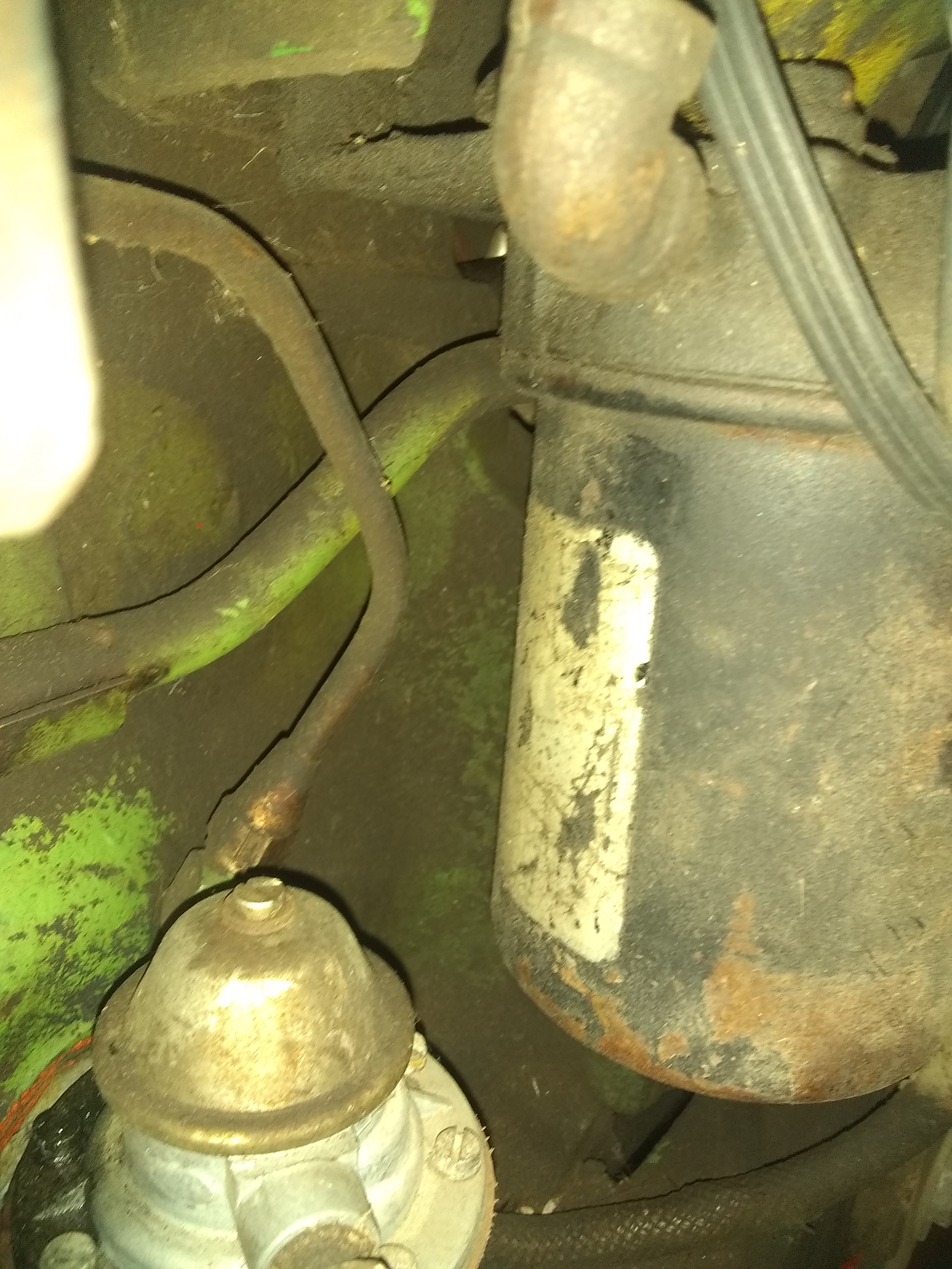

Here's a photo of the later, spin-on version of the M&W-supplied turbo oil filter.

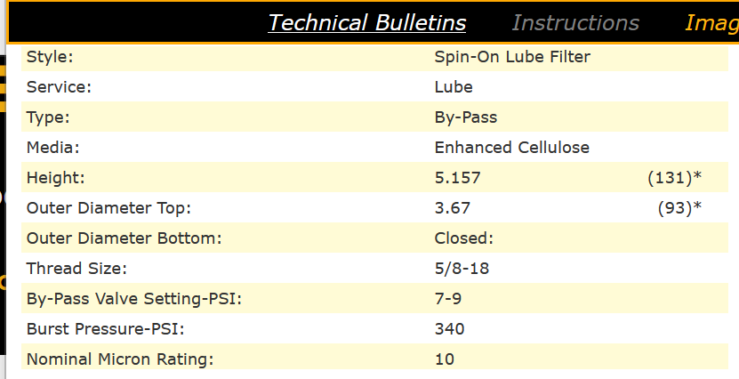

I may be wrong again, but that 51052 filter does nothing different than thousands of other built-in-bypass valve oil filters. That 51052 has 5/8-18 threads and WIX only shows seven filters with that thread. A real oddball thread size for spin on oil filters.
When WIX shows it to be a "bypass" filter, they mean that when the filter element clogs up with dirt, the pressure relief vale will open to allow unfiltered oil to bypass the filtering and continue to where filtered oil goes.
It fits the M&W filter base where there is a dedicated outlet to send filtered oil to the turbo via tubing or pipe or hose.

I have a 4020 with a M&W turbo and it uses the canister filter with the stacked felt discs, so I have not had to deal with a "cross" on it. I DO have a file on my computer as to what people are subbing, I will check that out later.

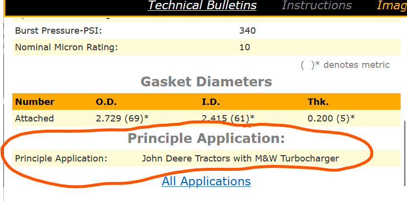

This is a screen shot of the specs for a WIX 51052
And no drain back valve.

GOTTCHA!
I should have downloaded that to make large enough to see that part # on my phone! The WIX bypass filter series that is commonly mentioned is 51050, 51051, and 51320, they have the same thread, ARE a "bypass filter" with an orifice an NO bypass valve.

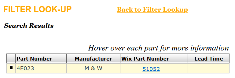

IS there more than one M&W filter number?
