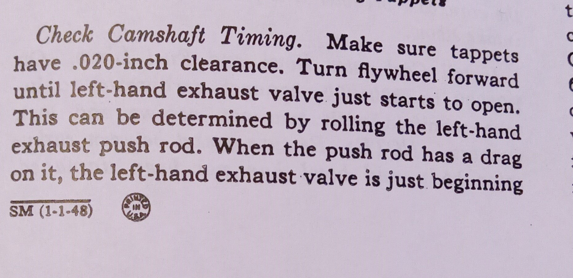

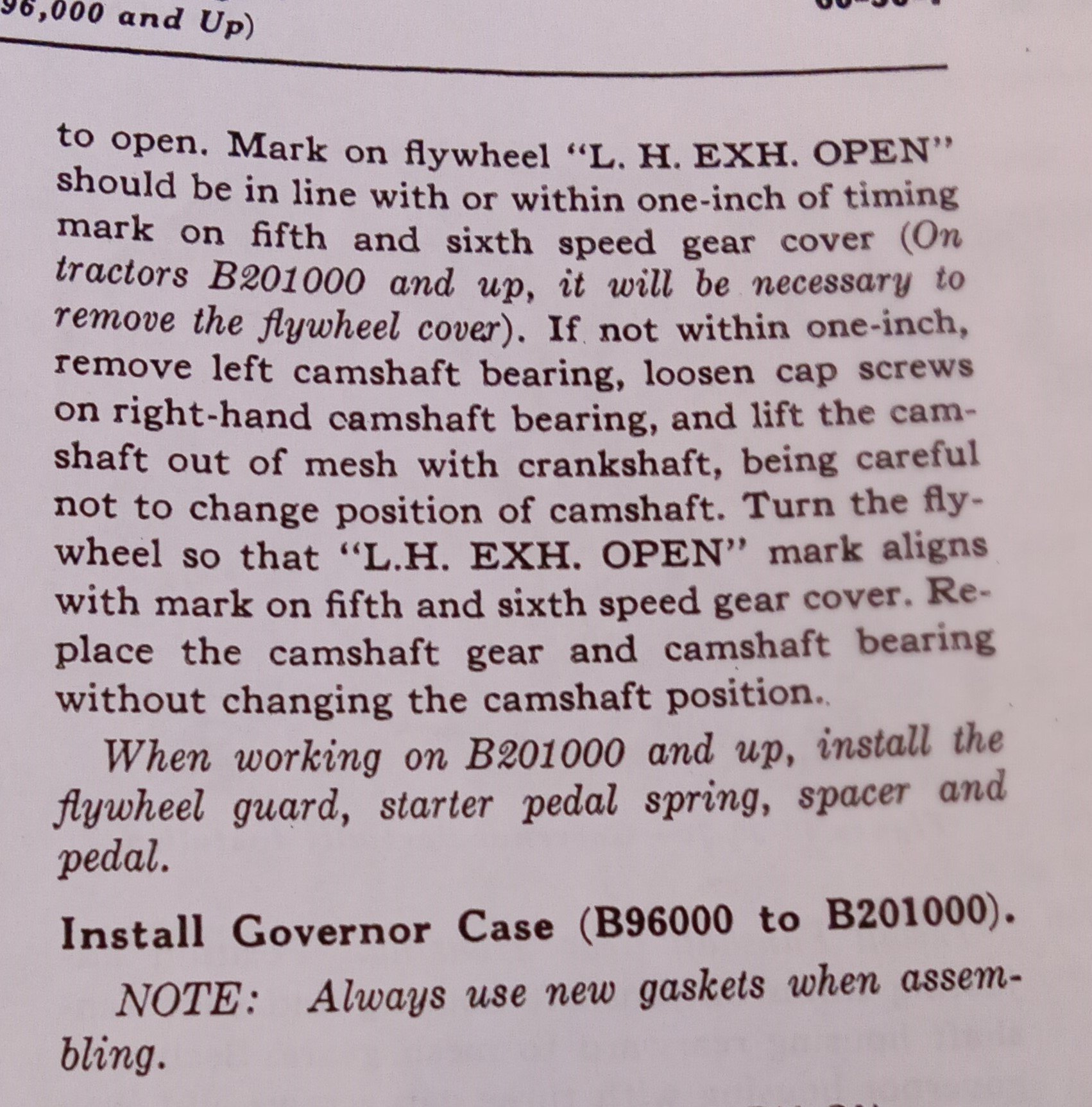

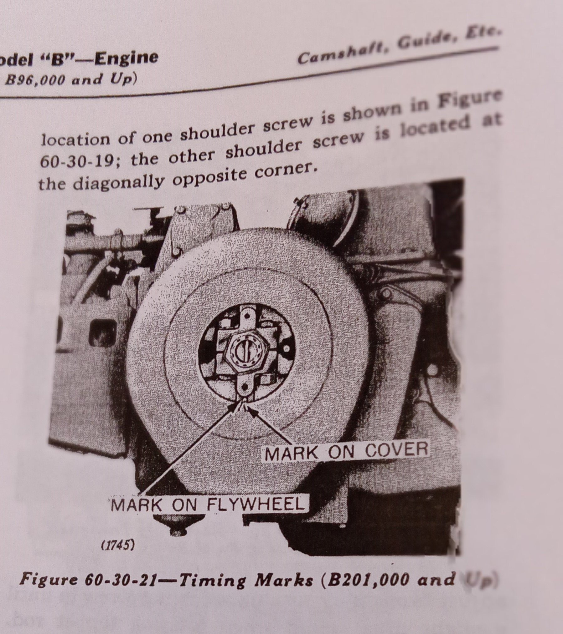

I still need to check the manifold. I'm sure my carb gasket is good. These pics are from my manual. I know my exhaust valve is off accordingly to my LHEO mark. Read pic one first

I believe it was already asked if the v marks inside the tractor on the crank, cam idler and cam gear all are timed correctly by opening the top cover and looking down inside? Should be some internal v marks
the v mark on the outside will just tell position of crank if someone moved something that won’t tell you much I had someone attempting to replace a crankshaft got it miss timed and I ended up lifting governor housing up a hair to line everything crank, idler and cam back up

This is a 1950ish machine with electric start. My fly wheel is faintly marked with no impuls markings. I had to verify TDC and go from there. It has some TDC timing degree marks and LHEO but not even in the ball park of either position. I have verified the weight position on both the flywheel and clutch they are correct. The valves are out of time to the Manual specs of opening and closing position slightly. It seem that the cam is from a pre 2001000 motor. The intake should still be close at TDC but it seems to be slightly open on both spark/waste spark of the mag.
Your posts are a bit confusing to me. You say you have "checked" all the timing. Are your rocker arm clearances correct? That can affect the valve opening. Missing marks on the flywheel? Post some pictures of the flywheel, in detail, of all markings you can find on it and the crankshaft end. Are you sure it has the correct flywheel. You should find a cast-in part number, may be on the inner side. Not trying to be critical here but you're new to these things and we all have to go through a learning curve. So I have to question your checking. Do you have any sort of manual? I get by fine with the I&T. I think it's unlikely the camshaft has been changed but it would have a part number on it. Trouble is you can't see it. Please don't take offense at my comments, I'm trying to help.

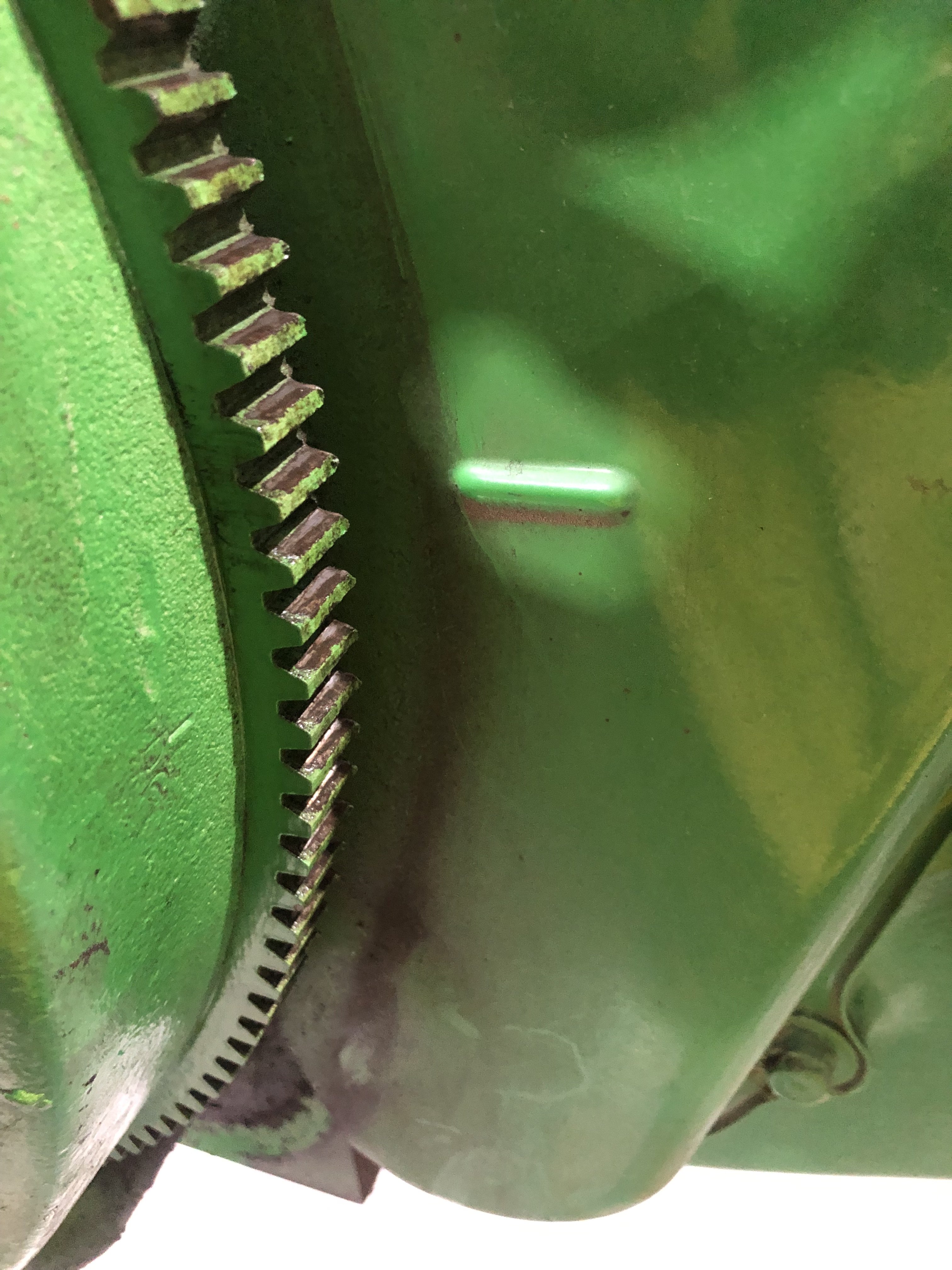

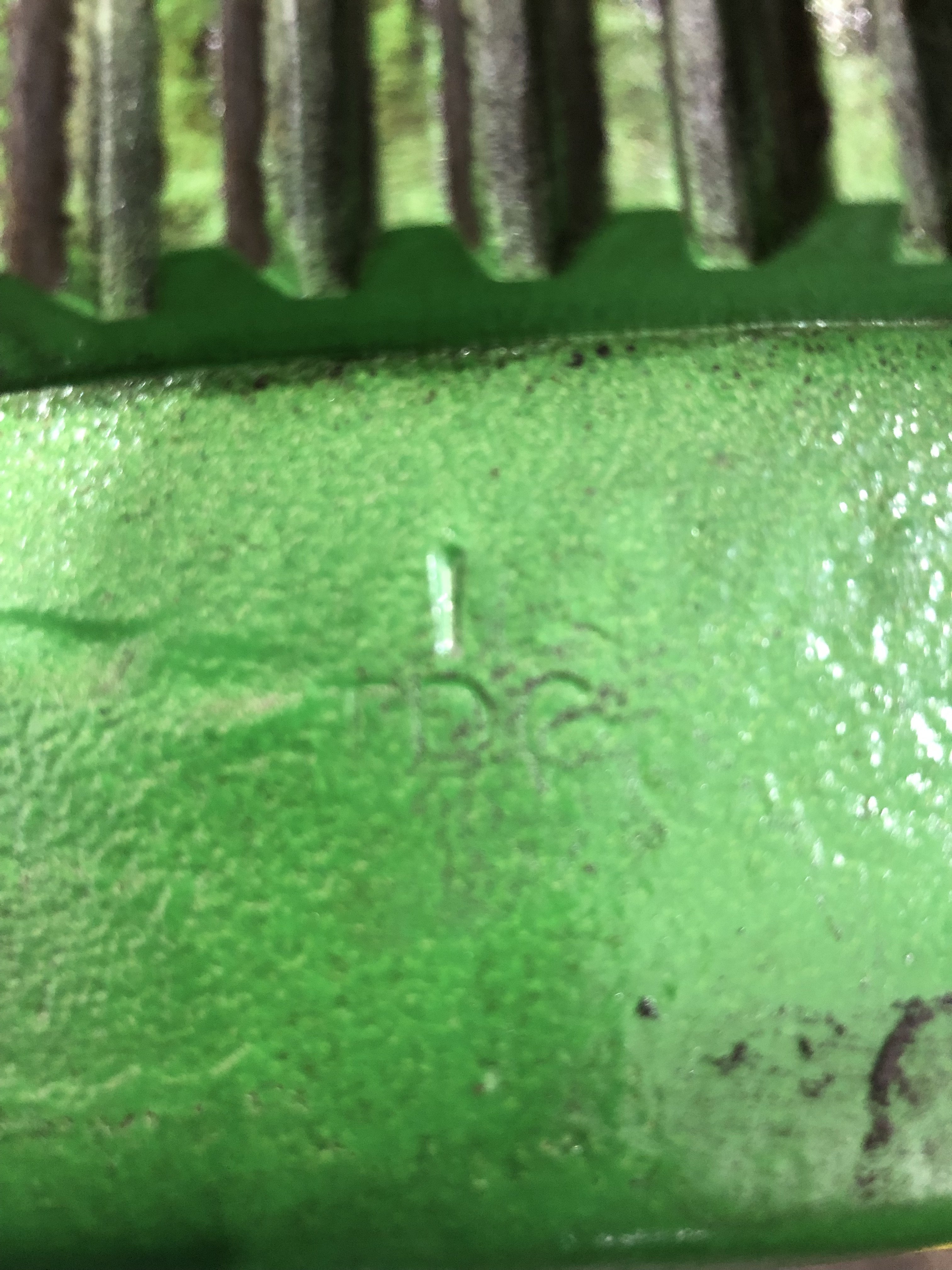

I have hopefully attached the 2 marks to use to adjust the valves this morning as I had to get the mower setup for spring on the A but the setup is the same
The cover picture you show in the previous picture should work for l.h. Impulse
If you would rather use the side of the transmission cover it is 120 degrees counterclockwise from the LHEO that you should have to the lh impulse mark (or 2 flats of the crankshaft nut make your own mark by putting crank in that position and silver sharpie it and the side of trans mark so you could use a timing light)
If you would rather use the side of the transmission cover it is 120 degrees from the LHEO that you should have to the lh impulse mark (or 2 flats of the crankshaft nut make your own mark by putting crank in that position and silver sharpie it and the side of trans mark so you could use a timing light)
