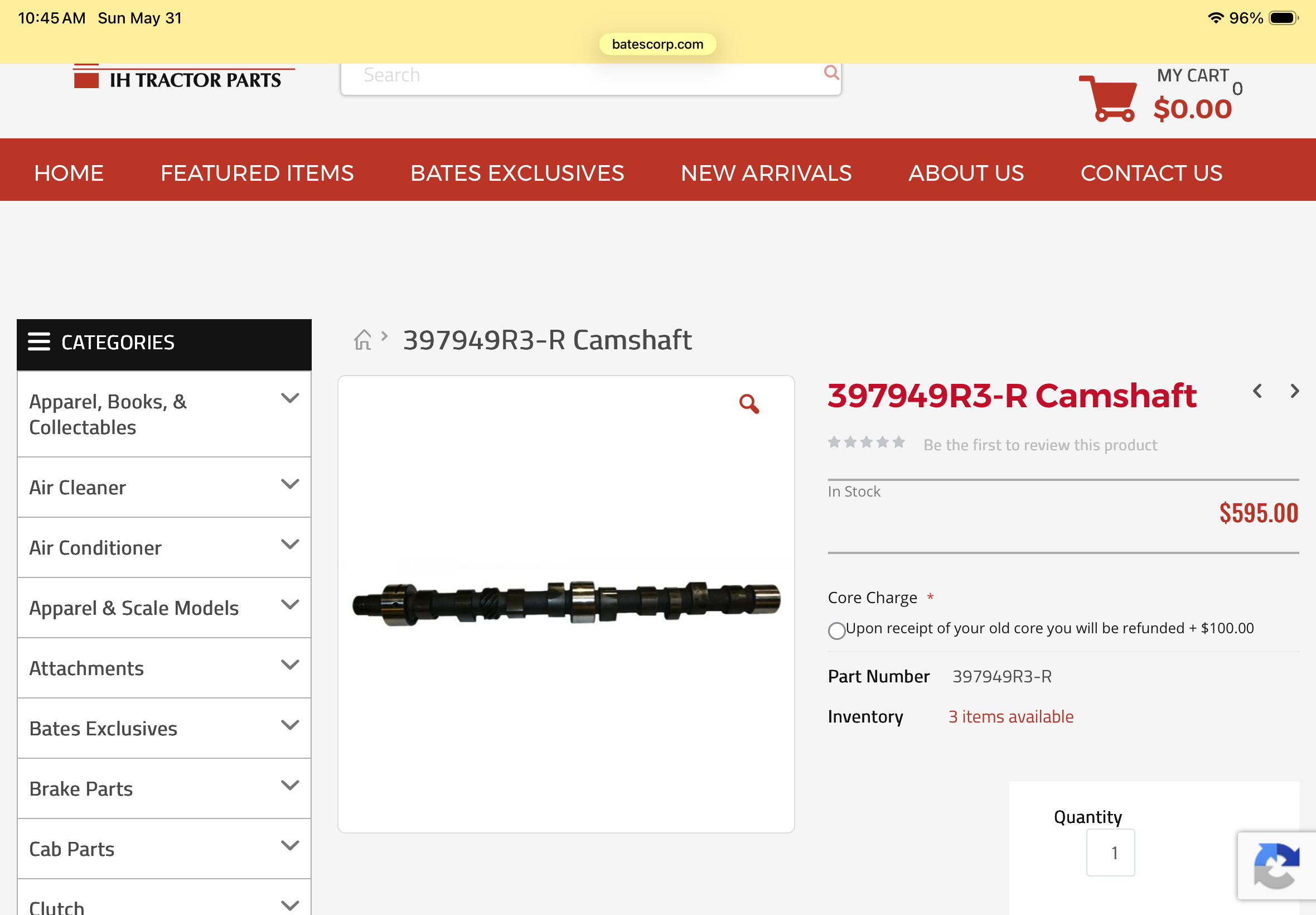

Here is a couple of used.

In DesMoines iowa but if you have one how much
Really have no idea of price. Don't know for sure if it is the new one I bought or the used one. Was rebuilding the C200 in my 544 and on initial startup had no oil pressure, no oil to the rockers on top. tried a new oil pump. Then had a camshaft on order when someone recommended putting a pan of oil under the pump pickup with the oil pan off to see where the oil was going. Turned out the shop I used for the block and head work didn't have the cam bearings in from right direction - weren't on the camshaft journals right. Changed that and all has been good. Hate to think it has been probably 30-40 years ago!😲
Will check around for a price, but I won't be trying to get rich I know that. Question will be what it will take to ship it?$
