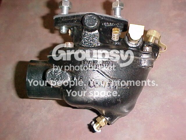

The drain plug on my Marvel/Schebler Carb has the head all stripped off. Could yall help me out and advise if a replacement is available or if it's a standard thread where I could purchase something locally. Want to find out before I take it out.
It's on a 49 8n front dist.
THANKS
BP
It's a standard 1/8 NPT pipe plug.
You can even replace it with a little brass petcock to make draining the bowl EASY.
(ASSUMING you don't mean the tiny brass screw used to plug a hole used for drilling an internal passage.)

Looks like Bob has you covered .
(quoted from post at 15:53:35 10/09/10) It's a standard 1/8 NPT pipe plug.
Thanks a bunch, I'll tackle it tomorrow!!
