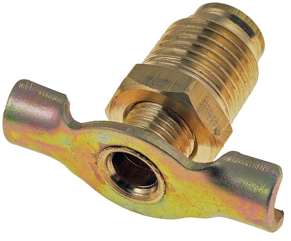

Terry,Be sure there is no crack in the bowl at the plug,replace the steel plug with a brass plug(will seal better). Even better would be a brass petcock to drain when needed with liquid Teflon or tape on the threads.
Pet Cock
