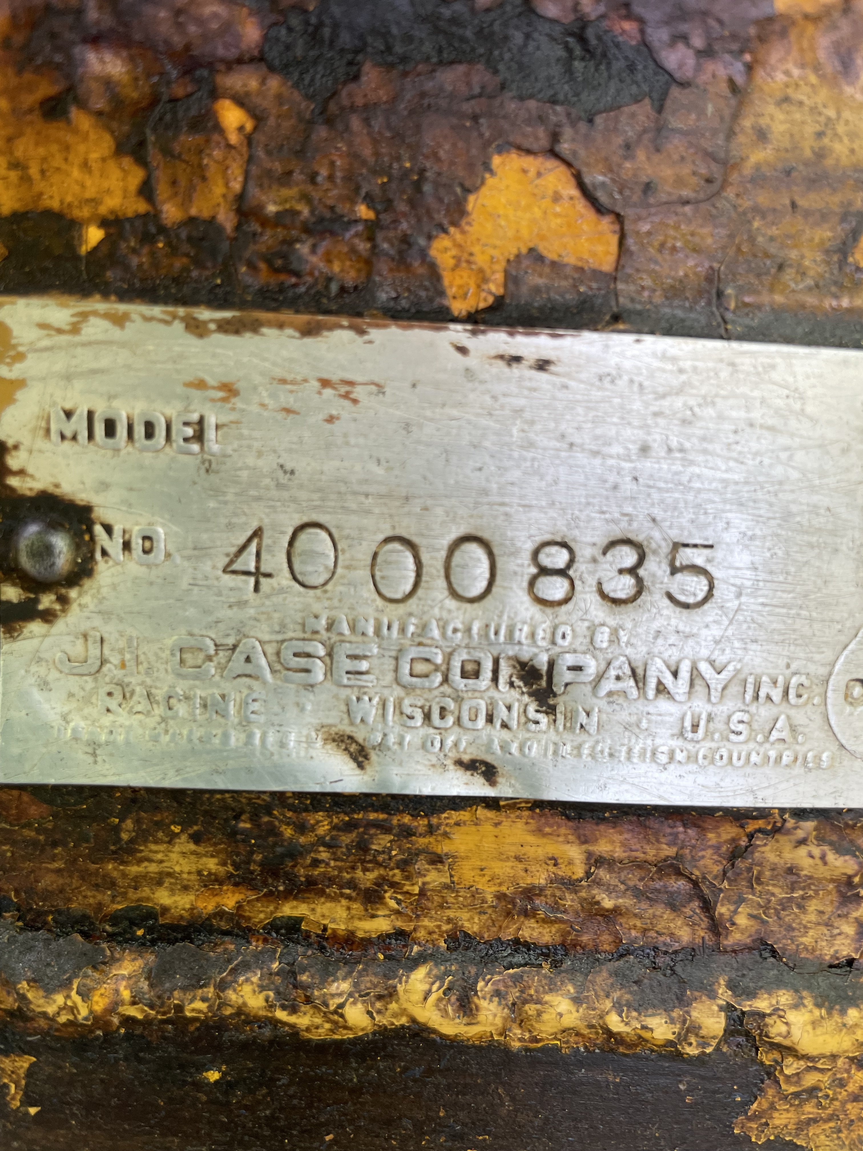

Case 320b? Year 1958?
ciscorais
New User
Hi - I just purchased a case backhoe and changed majority of the oils but can’t seem to find the filler for the hydraulics. Any ideas and anyone can make out the year and model with the attached image?
That tag is for the Loader - Hoe unit only and not the tractor. The tractor serial number will begin with 6 and the tag will be on the tractor itself, but by this time may have been lost. The reservoir for the Loader - Hoe hydraulics is the loader frame itself. On the right side of the Loader frame, on top is the fill, 3/4" or 1" Pipe plug . The level plug, 1/2" pipe plug is down on the side.
