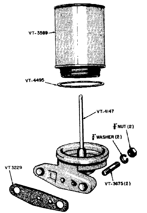

Hello all, me again with yet another question. Is there a different oil filter setup than what came from the factory? I have had trouble off and on with both the cork gasket and rubber seal leaking upon filter replacement. I've tried several brands of oil filters and all can fail. The filter is a "Mason Jar" style.
One of the issues that has happened through the years, is the gasket changed from cork to rubber. The rubber gasket is much thicker vs the cork gasket. The thicker rubber doesn't allow for as much thread engagement. I'm going to try to find a thinner rubber gasket.(I hope)
