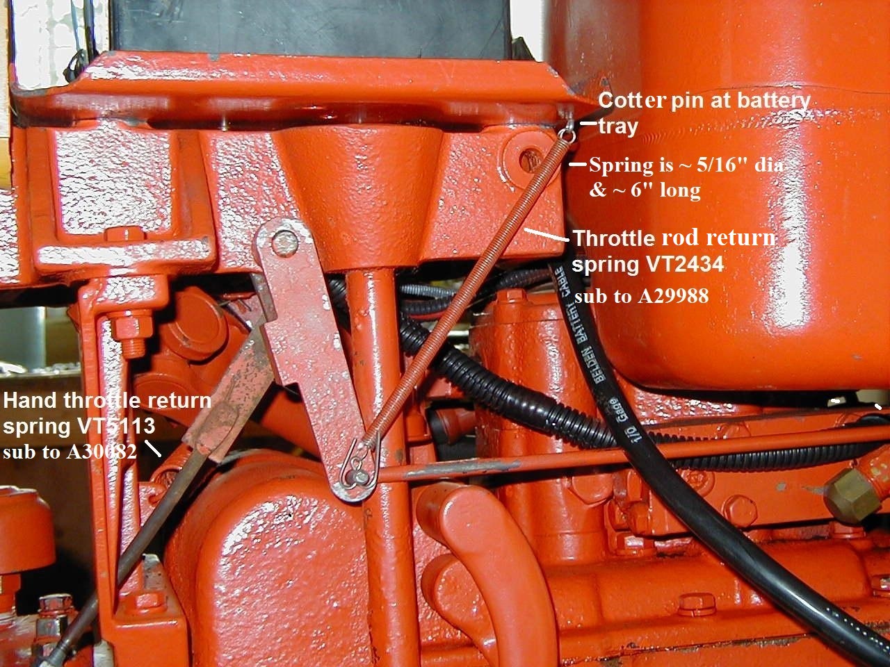

Throttle rod spring VT2434 is often missing on these tractors, this is the factory hookup.

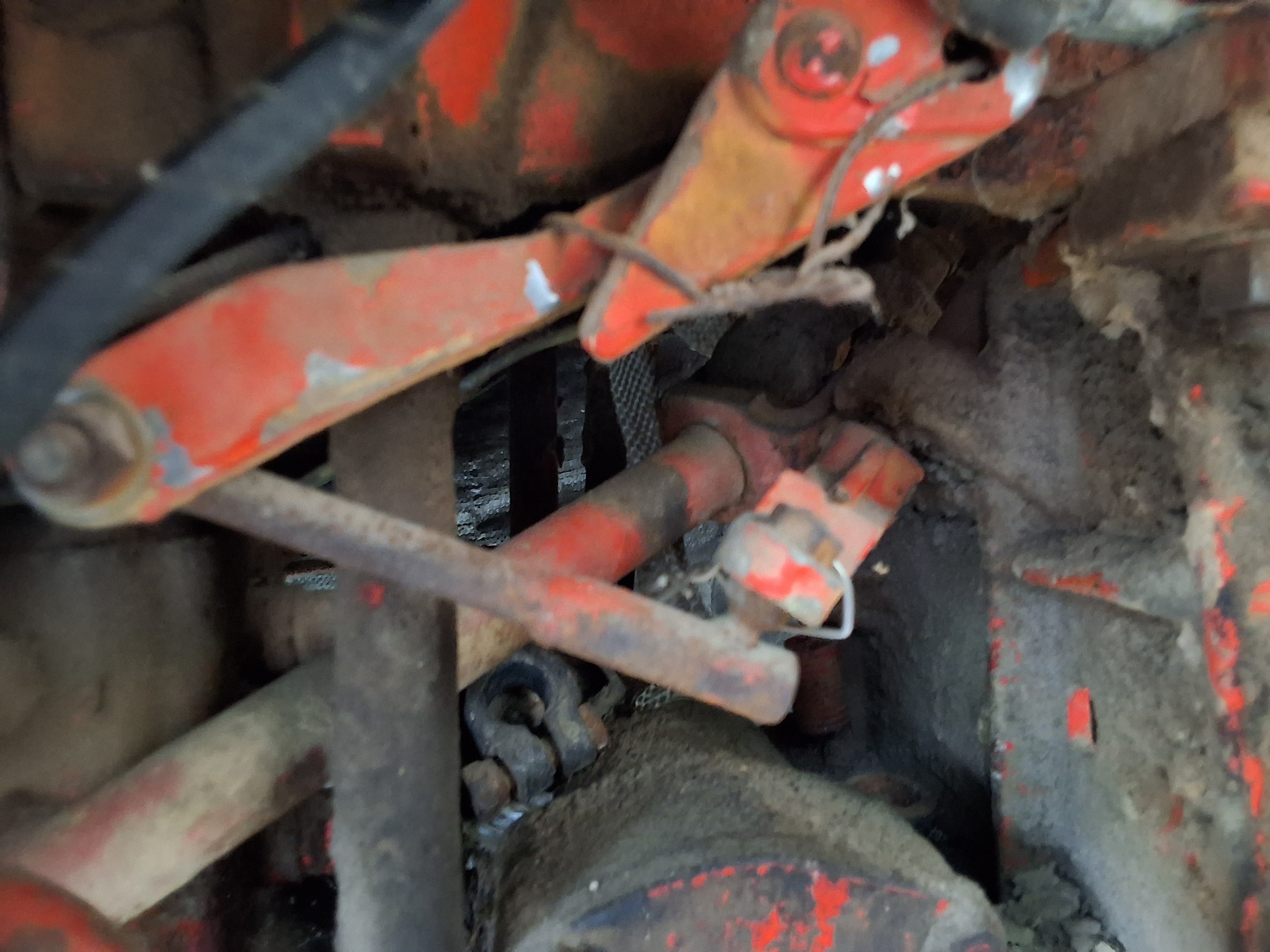

Well it stopped raining and raised the tarp covering the 511b and here is what I found. This tractor was bought from a "Mr. Haney" some years back, and I knew it was locked up, but it was all there, top link, front weight, power steering, cloths pins on the fuel line, etc. What I didn't know was the cost of an over haul kit. So it has set tarped while I work on other tractors. Not sure what function the wire serves. Joe (Wa), I think your pictures are better.
Finally getting back to the 511b after being away from the shop for harvest. Would it be possible to get some more views of this side of the linkage from some different angles? The foot throttle linkage layout is giving me problems now, I'd like to see how it attaches to that cross shaft under the battery tray and how it pushes on the lever going to the governor linkage.
This picture shows the foot throttle rod going thru the large slot in the case iron in the lower left hand corner, if you look thru my pictures from the wreck you can see our rod was on the outside of everything else.
Our rod is also different, a clevis end to the pedal on the running board and an adjustable threaded end under the battery tray that attaches to a short piece of angle iron which then attaches to a bell crank linkage piece. To the best of my knowledge our complete foot linkage has always been intact.
