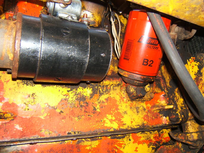

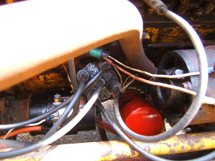

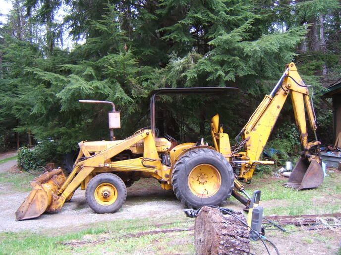

I recently bought a Case 'TLB' (although here in BC we just call it a backhoe). I was told that it was a 320, but my research so far suggests that it's a 530 (but without the 'CK'). The serial number plate for the tractor is long gone, but the tools (both Model 31's) have serial numbers 4049930 (loader) and 4042792 (backhoe). The engine is gas and has the number D200 cast into the block above and slightly to the rear of the distributor (see attached image). The engine serial number is 345S07260. The transmission housing has the number G-1096 cast into the left side; the shuttle housing (if that's what it's called) has the number G1355 cast into the right side.
It has the rounded grill with the 'eyebrow' headlight housing (see attached image), rather than the flat face of the 530CK. The grill itself is expanded mesh with vertical folds, which seems to be common to some 320's and some 530's that I've seen.

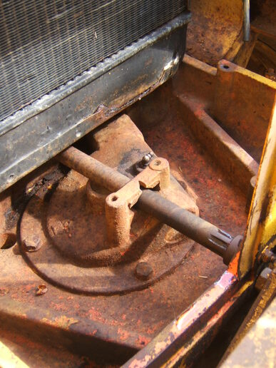

The images that I've seen in this forum of the steering on the 320 shows a worm and roller with a horizontally mounted shaft. Mine has a funnel-shaped housing (as seen from underneath) located under and partly ahead of the radiator. Input is from a steering shaft with 2 U-joints; output is via a vertical shaft with a Pitman arm and tie-rod connected to the left knuckle. A gear-driven power steering pump is located on the right-front side of the engine, beneath the generator (although I haven't been able to determine how it transmits to the steering system). The only manual that I've been able to find so far is for a 'CK', with its Hydrostatic steering, so I haven't been able to find any info on this system. Can anyone tell me what oil it uses and if there is a drain plug to change the oil?
