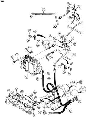

I have a Case 580E backhoe. My backhoe hydraulic swing rams have been leaking, so I took them off the machine to be rebuilt. I was careful to tag each line and where the came from and went to. Unfortunately, the Ram rebuilders tore off all the tags leaving me with two rebuilt rams and four hoses. Does anyone have a diagram of hydraulic hose alignment for the swing rams? Thank You. Doug in NJ

From the 580E parts book found at My CNH Store, link below.
580E parts book
