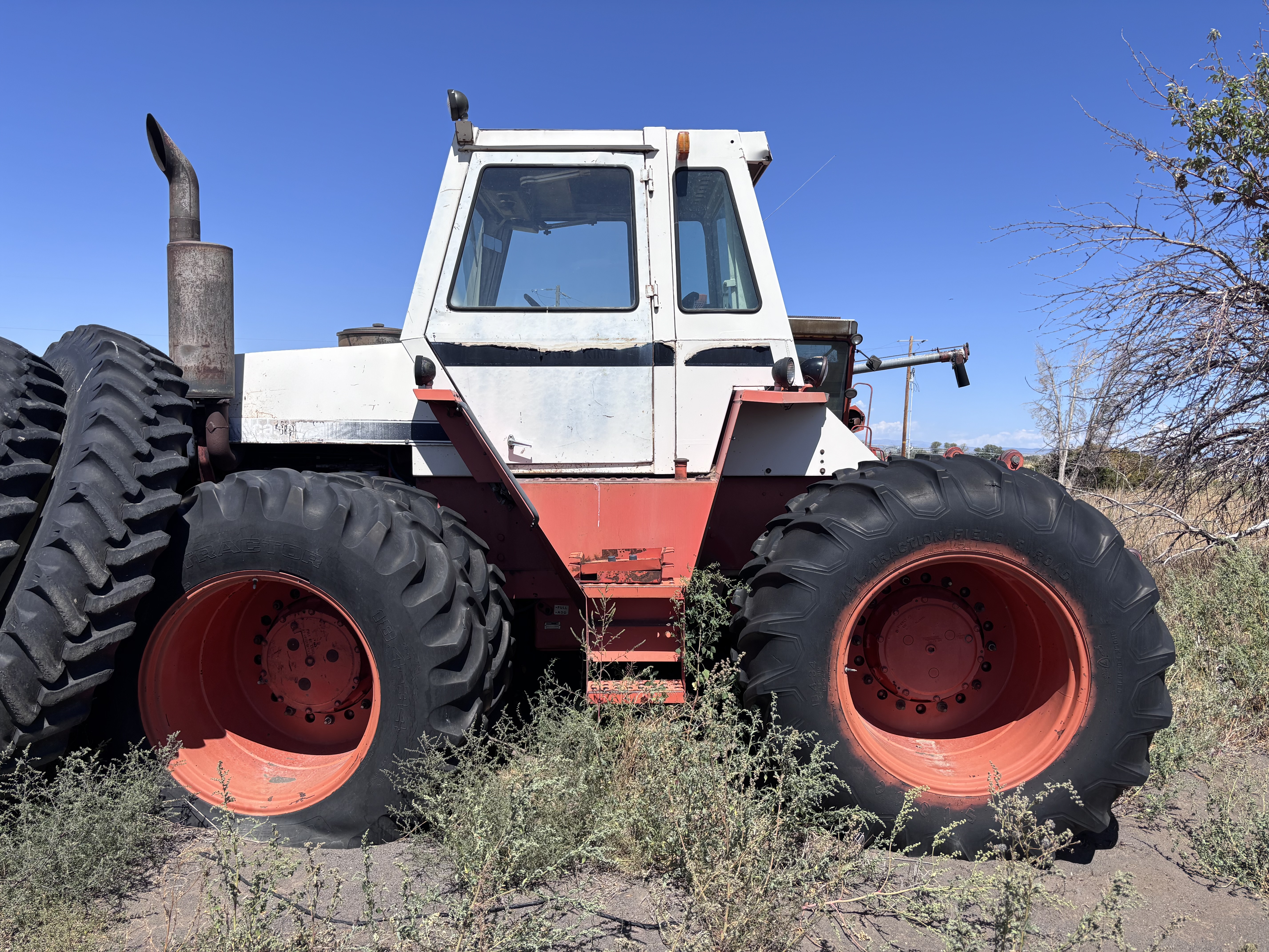

This has screw in injectors so I’m guessing they updated the heads at some point.The 2470 injectors are pencil type held in with a bolt and bracket. 90 series have a nut that screws into the head.
