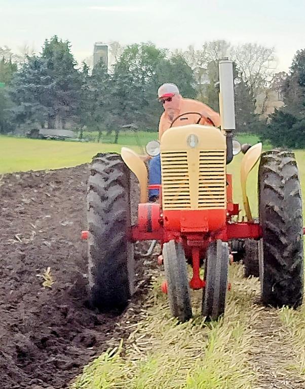

Yesterday I was plowing a sorghum field with my 3-14 Case Centennial model 'B' and my 1956 Case '400'. At some point, I must have hit a rock and broke the point off the rear share. I didn’t notice it was missing until I stopped for lunch and saw it was gone. I kept plowing for another three and a half hours, and it still worked just as well as before. Does anyone know if shares are available for this plow with CX14 moldboards?
Thanks a lot.
(The photos show the plow before, all shined up, and during use.)

I use the 16" shares on my 14" S and A Series bet yours are the same you just leave one share hole empty,, the extra length does not affect any thing at all
Going back more years than I care to remember, I went to the local blacksmith with my grandfather, and he put the shares in a forge and pounded new tips on broken shares for us. Good blacksmiths are hard to find nowadays. Am I the only one who has those memories, I suspect not.
