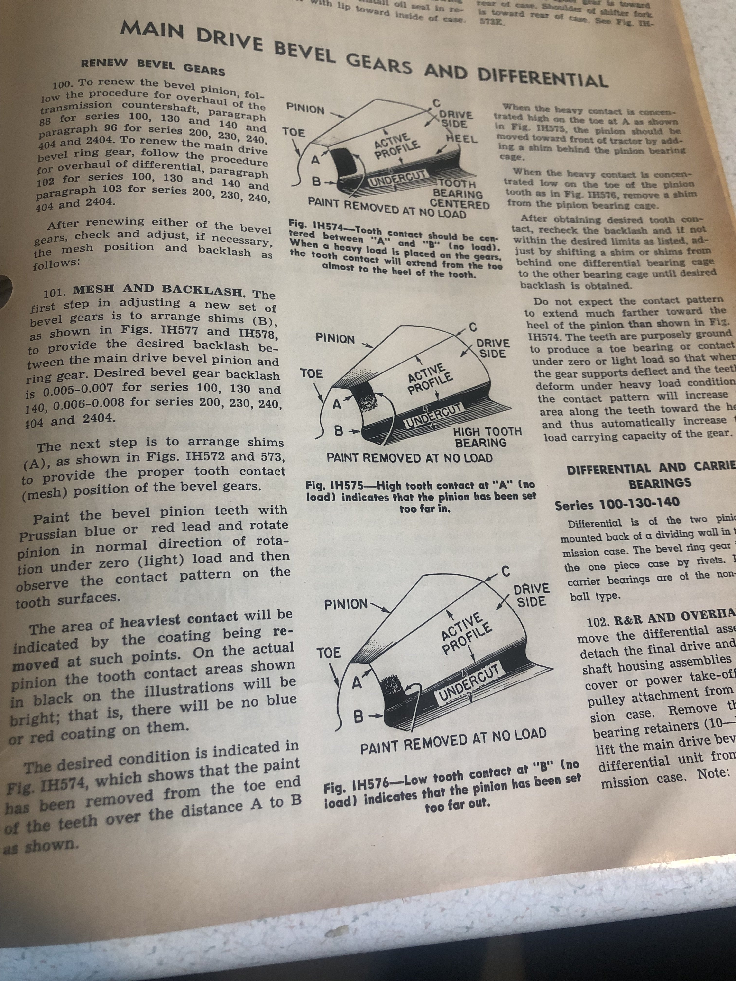

I found u some info regarding procedures. These are the small model farmalls. Don’t matter a diff is a diff.

Actually that backlash of 0.005" sounds correct.
The pinion on my 1944 DC3 is marked 5BL.
And the pinion on my 1951 DC3 is marked 6BL.
In this case I would work with it a little.
You could for example add a 0.003" to the pinion bearing carrier and see what kind of a pattern you get in the blue.
There are three different thickness' of shims for the pinion bearing carrier.
30 gauge.
0.005"
0.003"
Then check the backlash and the wear pattern.
With worn gears you are shooting the dark, so to speak.
Looking at your last picture, the one of the pinion, there is heavy contact on the ends of the pinion gear teeth, and then a faint line deeper in the pinion gear teeth where the top edges of the ring teeth are contacting as the teeth roll apart/separate.

A little update here. I have done a lot of research since my initial post and talked to several people. As of right now I think I will keep it where it's at but I will explain why. I do not and cannot know how this gear sets was setup before since it was shipped to me in the mail. More than likely it was set per the numbers on the pinion because it was installed from the factory that way. This differential is now set again to the procedure in the manual. I am confident in my ability to use a feeler gauge and dial indicator. These Case gear sets have numbers scribed in the pinion (see picture)for backlash and pinion depth, using a special gauge which I have (homemade). What I am less confident in is reading the markings in the blue although I've learned a lot. It is my understanding that a perfect pattern would be a football shape dead center on the tooth. My pattern is roughly a football shape but toward the toe of the tooth. Through research and by testing that pattern will move toward the heel as load increases. I was able to verify this by using no load and having a little contact on the toe then adding load by hand to get what you see in the pictures. I can only assume a real load will move that pattern even farther toward the center. In the photo below you can see where the gears touched circled in red and where they got very close in green. My assumption is that under a real load the green section will become part of the contact patch. Also the coast side or the side that contacts when the engine is breaking looks perfect. The contact patch is basically the whole tooth. See picture
One last piece of advice I received from a respected Case man was to use a piece of news paper. Running that piece of news paper through the gears should result in a creased but not cut paper see final picture. I appreciate all the advice. It will be a little while yet before I close this transmission so I can still make adjustments if the consensus is it's needed. If I am still way off let me know that too and I will adjust accordingly.
