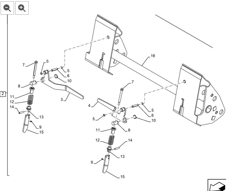

Since you say you have two levers, it's probably a SSQA style like this. It's a very simple setup.

This is exactly the diagram I was looking for and I will give it one more look over I have also include photos.

1. When I removed the blade, unbeknown to me, there were some burrs and power coating pieces on the part where the pin engages Several tiny pieces got pulled up when I disengaged the pin. This caused the pin to bind and prevent it from traveling down. and engaging
2. The pressure on the handle pushed the ring (see attached image in red) out of alignment and was inhibiting the handle from engaging the spring and pin.
