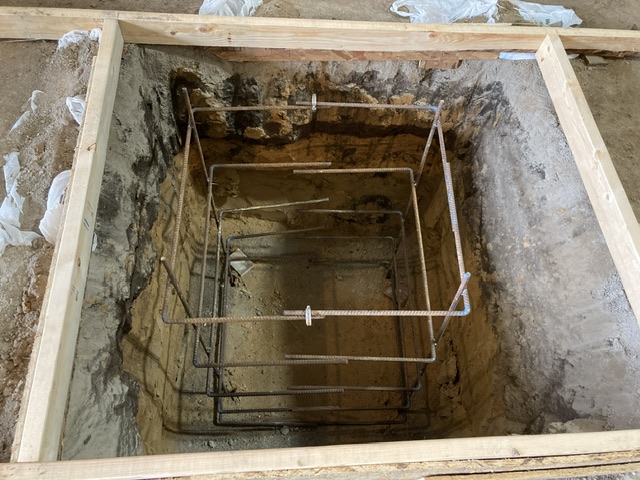

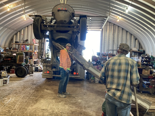

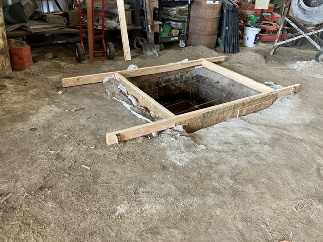

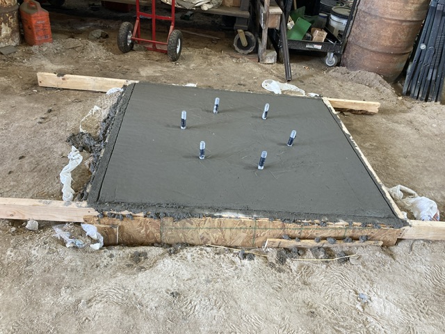

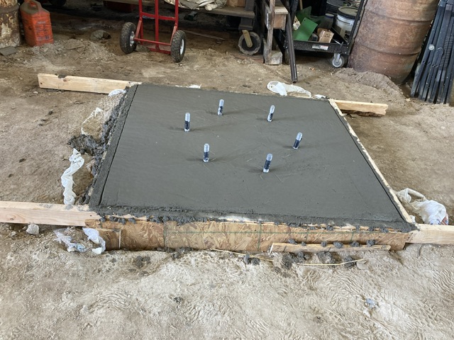

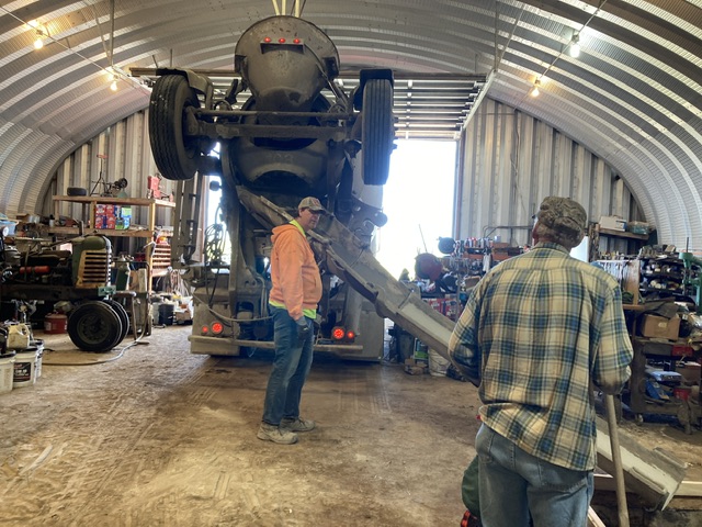

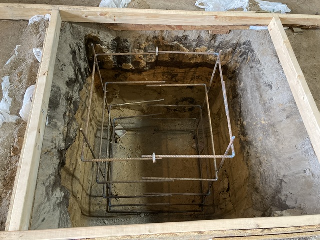

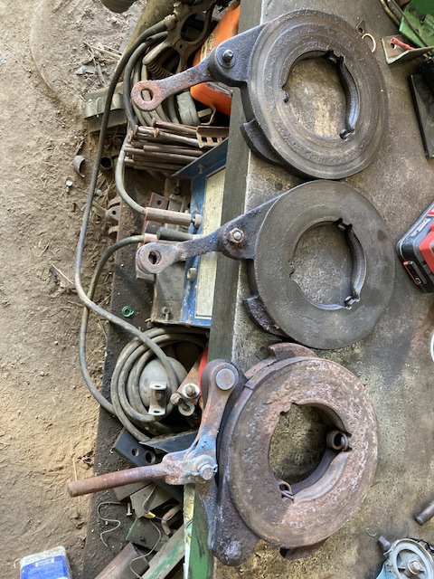

Finally got the cement poured for the jib crane base. Couldn’t find anyone to do it so 2 guys I used to work with came and helped. Then went to Rock Island and filled out paperwork for senior property assessment freeze and ate late lunch at Rudy’s Tacos. Came home and got the last brake out of super 88. I’m tired!!

Mighty fine mount base. Well done. I assume it is as high above grade as eventual concrete floor. Jim
Should be, it's a dirt floor with about 8" of packed limestone on it. If I get a floor poured, it can be dug down as far as needed.

I would also like to know the dimensions of your hole, yards of concrete poured, and the capacity of the jib you are planning.
I have thought about making one myself. Was thinking I would bury the entire rear axle of a 2? ton truck in the concrete and use the the outer axle bearings and hub for the pivot.

Same brakes as a 30 series Case.
Where did you find a cement truck driver that would back into your building? Around here they will not even put there chute inside a building, you have to rent a chute or bucket in the cement with a loader. That's been my experience.
If you don't mind my asking, what size jib, and what size is your footer?
I am planning one sometime.
The crane is rated for 1200#s, it came out of a local factory. Information I found on the internet said I needed 4X4 4 foot deep with rebar and 36" anchors. The hole was slightly larger, I gave them the size of the hole and they figured 3 yards of concrete, don't want to run short but there was plenty left over to find a home for fast. The strongest mix was 5000#s and added fiber. I told them it was inside and they said it didn't need air added, not sure what that means. I couldn't find the anchors locally, had to buy 10 to get 6 if anyone needs 4, I got them. Shipping was 3 times the cost of the anchors, GRRRRR!
