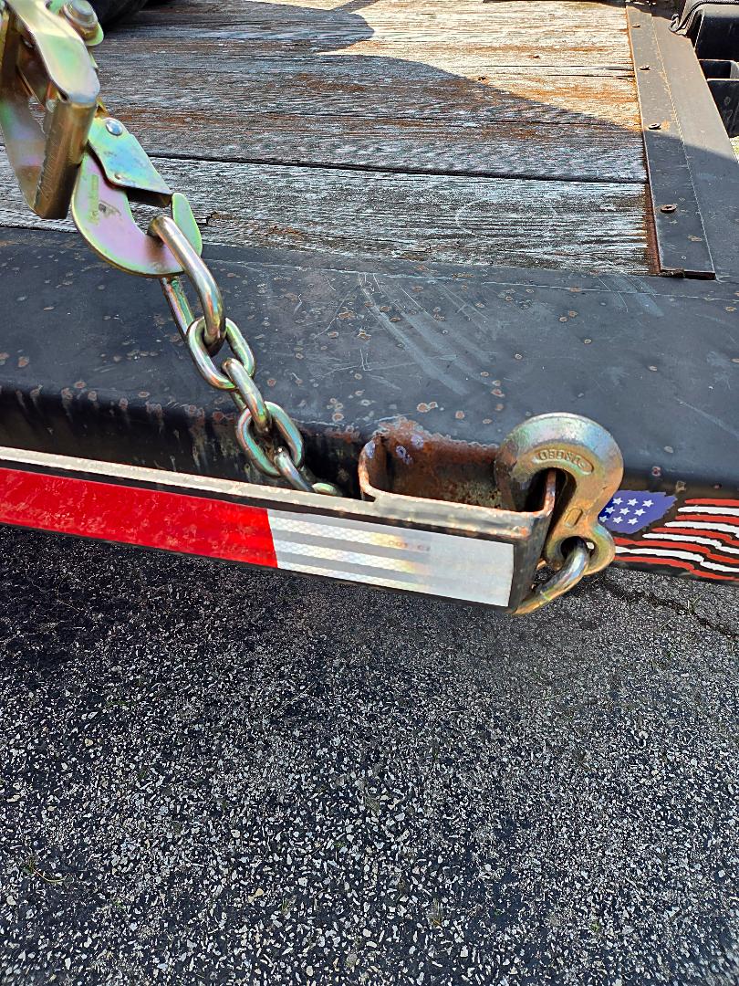

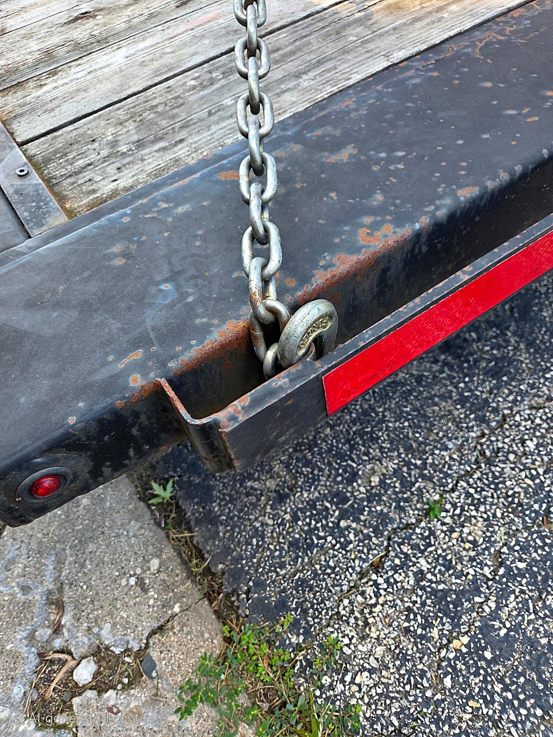

Chained to a stake pocket
What is the best way to chain to a stake pocket? I don't like being outside the rub rails. The photos are at a 45-degree angle. Two straps on the front, and a chain and binder through a clevis on the drawbar.

I don't see a problem with either picture. But the single chain and clevis on the drawbar is a hard NO for me. A common farm clevis and pin is not rated for load securement. Screw type shackles can be used. Nothing less than 4 point tie down for me, regardless of weight. IMO. YMMV. Flame suit on.
Only problem I have when using number two is the chain hook like to come up a little when I bind the chain down. Not as tight a load securment but I use both.
I like the first one since it is pulling on the whole pocket not just one side. It also does not pull on the pocket so it can bend it like when they hook on the pocket and pull over the top like I've seen done. Which would be a third method compared to these. I also if it is the end pocket like the first one will a forth style where I come up through the pocket and hook to the opposite side so it would go under the pocket and come up through like 2 is but hook to the opposite side from the inside. I always liked hooking on the top like these since the hook if chain is loose will not fall off the hooked connection.

By the way you guys that like straps can buy straps with about a foot of chain on the end to hook like a regular chain does without having to have a short piece of chain, for it like it looks like used in the first picture. Just an FYI.
Yeah, but if you damage the strap then you have to buy a whole new strap-with-chain because they're permanently attached. Here you can just re-use the chain.
In the years I was using straps for tie downs I only had a couple straps that got ruined in 15 years of use and they were replaced for not all that much cost. I still have my straps with the chain ends on them. Where they cam in handy was with high lads I could use a chain to extend them easy that the flat hooks did not work well with. Just hook a chain to the end of the strap and go. Big thing was the weight would pull the strap back over if you didn't have one of a few things a helper to hold the end ,a way to hook the end then go hook the chain to it or hold the end of the chain up enough you could reach the strap to pull it down to the winch. A full 10 foot high load would leave me short on strap with the hooking and getting to the winch mounted just below the deck on the winch track at the bottom of the cross members. If it was hay I( could usually pull it enough to get it started.IF a solid load like pipe or such then no had to ad the chain.
