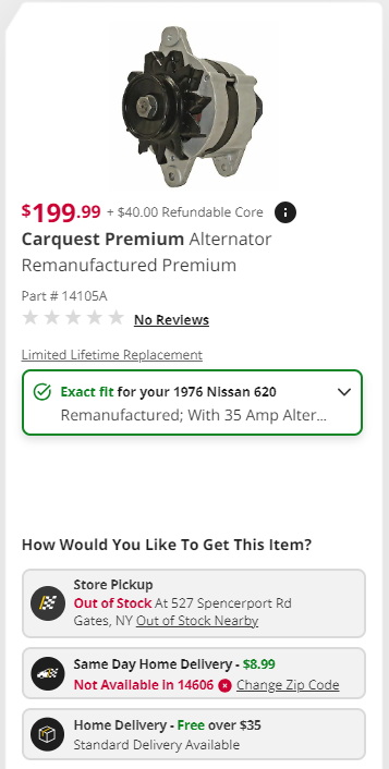

Hitachi 14231's were used on Datsun 620s in the 1970's so they can be hard to source locally. When I last bought one about 20 years ago only one store in the entire greater Rochester NY area had one in stock. They weren't widely used or popular among "hot-rodders" like the delco 10si or the denso mini.
Looking at NAPA's offerings for "denso mini alternator," the cheapest one is $263. So unless your buddy is going to steal one for you, I suggest you just google it and snag one off Amazon or Ebay for $60-75.
I just checked the "big 3" parts stores here, all 3 had one 14231 in stock.

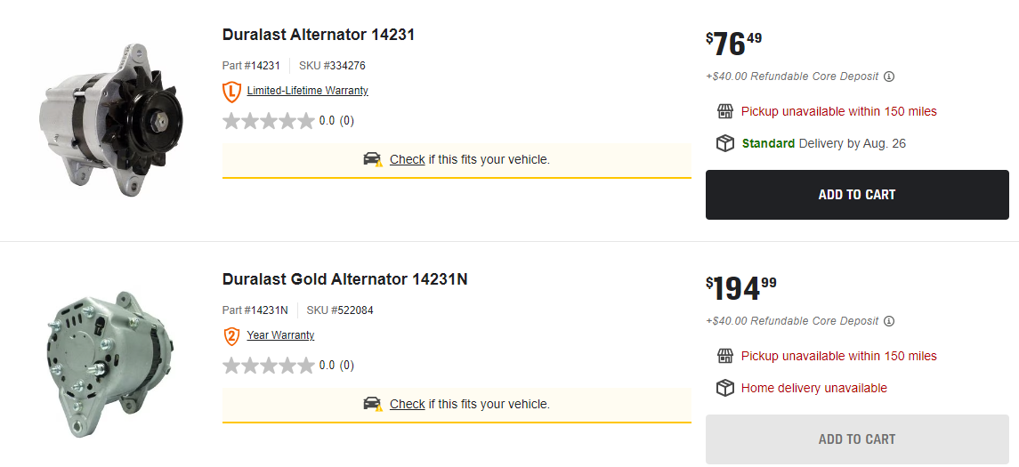

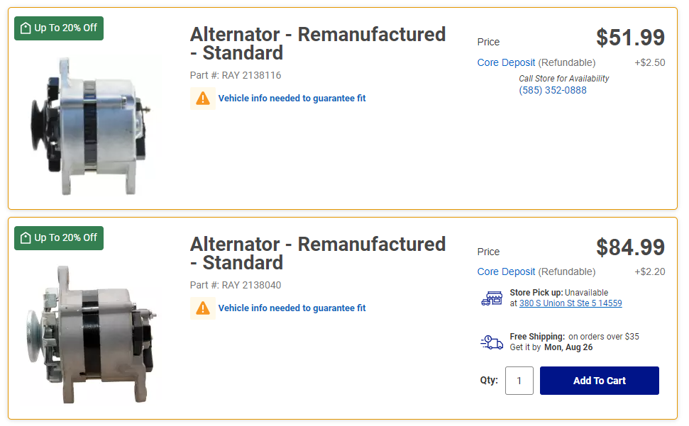

Out of curiosity, I checked too. None within 150 miles... and a $40 core charge which you won't get back... ouch.
Wow! Didnt even think about the core charge. Its funny one is $2.20, and another is 40 bucks! Anyways, I called my local alt/starter shop. He has a few smaller alts on the shelf, not a 14231, but others that size and would easily fit and replace his genny. I dont recall which one I put on my Cub, but it fit perfectly and wired easily and is a high output and will chug the engine down slightly until the amps drop. At the time I had other palns for the Cub and needed, IMO, more power from the battery.
