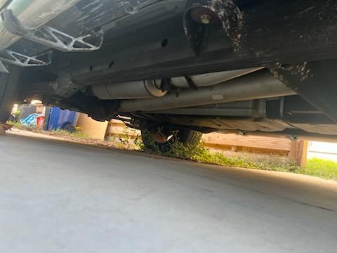

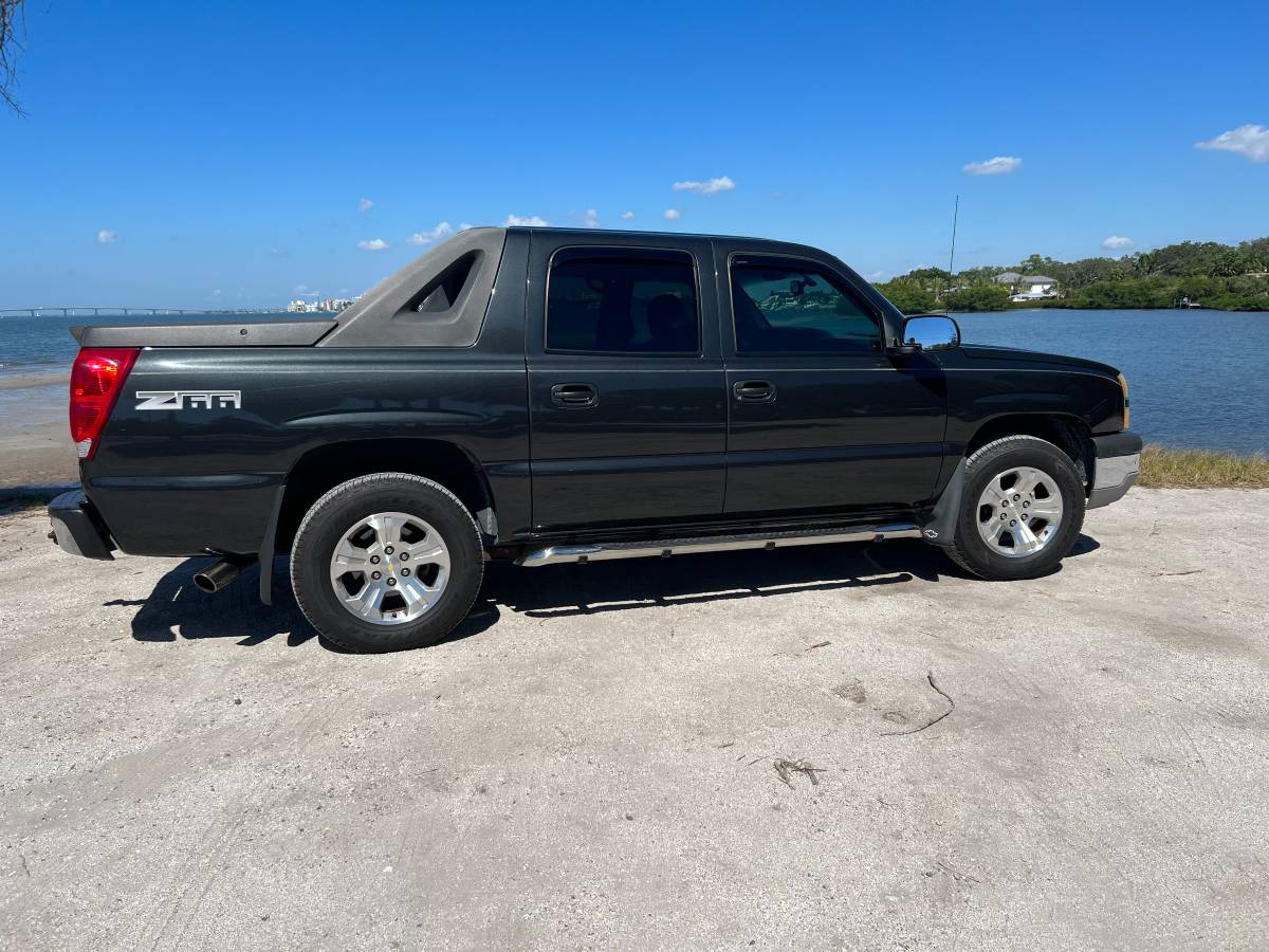

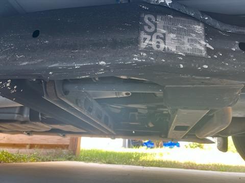

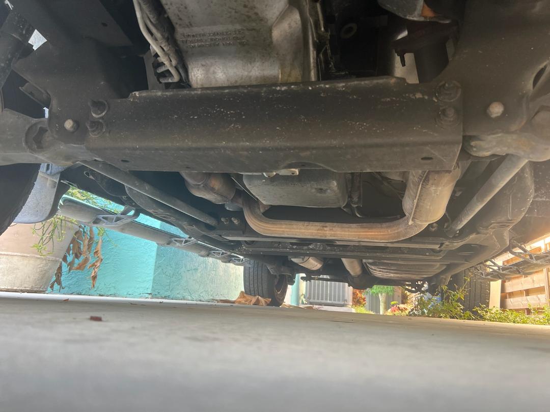

I bought this 2003 Avalanche back in Nov. 2023 has 166k on it, pretty much every option, two previous owners. Always in Florida. Original exhaust system, brakes, lines.
Since I grew up in SW Michigan salt belt for 40 years, I have had my fill of rust.
Some days I crawl under this Avalanche just to marvel at how rust free it is, lol.
