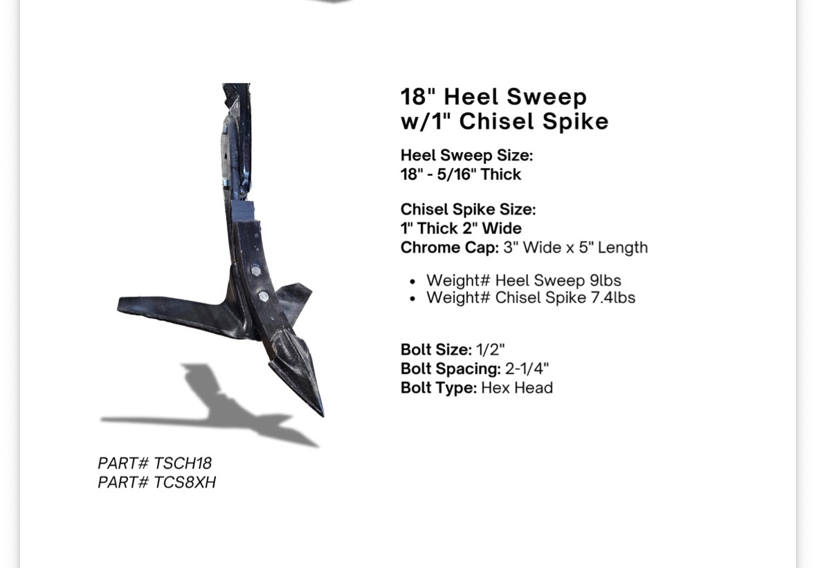

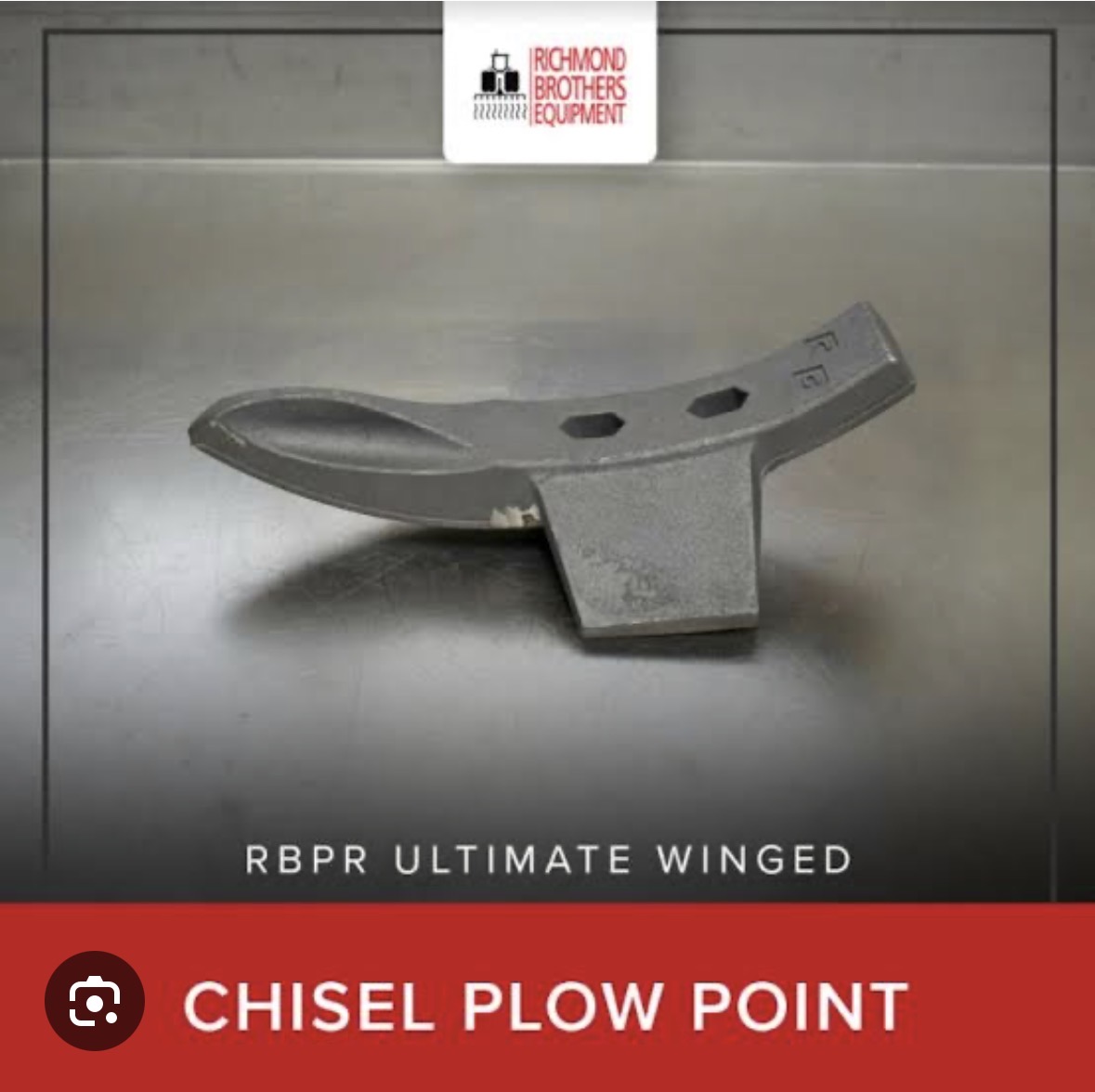

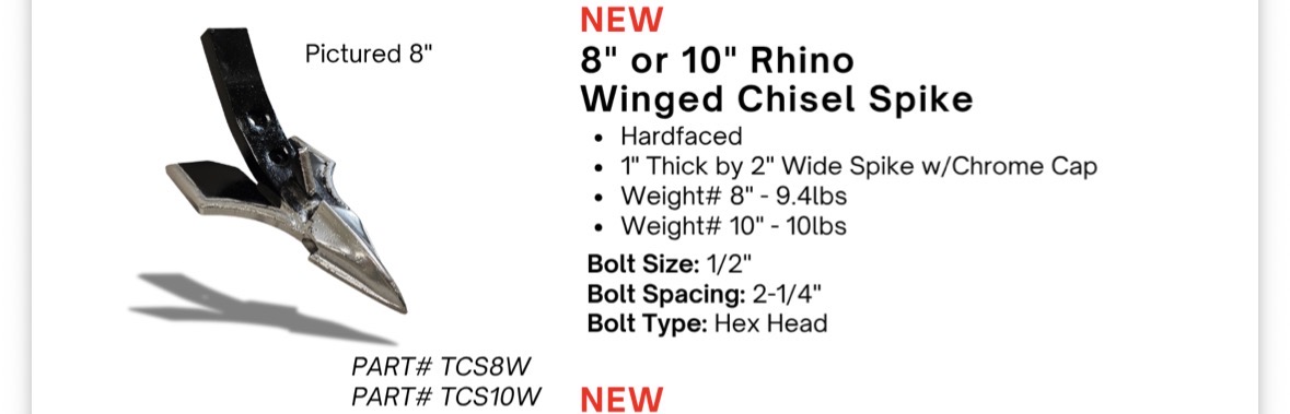

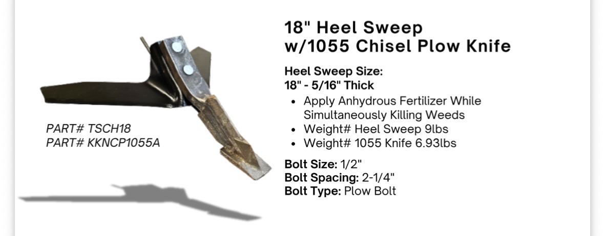

I’m looking into some different options for my chisel plow. I don’t have anything against the 4” twisted shovels I run now, but I’m just exploring my options. Ive also ran 2” spikes. I’d like something to mix corn stalks, not pull super hard, and break up compaction. I understand it’s hard to get all of those in one go but I’m just curious to what’s out there. The pictures attached are things I’ve been looking into. Any thoughts/suggestions? I don’t really think I like the big bull point on the Richmond bros. Sweep.

Not sure how it would work, I saw points like that for rippers , ripper shanks are a lot heavier, I kind of think may you may end up damage a chisel shank if you get deep enough. Just my spin as I use my 13 shank chisel with the twist shanks and mix the soil up nice

As far as throwing dirt around to cover cornstalks I don't think any of these will do as well as the 4inch twisted shovels. Sometimes I mow my cornstalks before chiseling, sometimes I don't. It would be neat to have a stubble chopping corn head.
