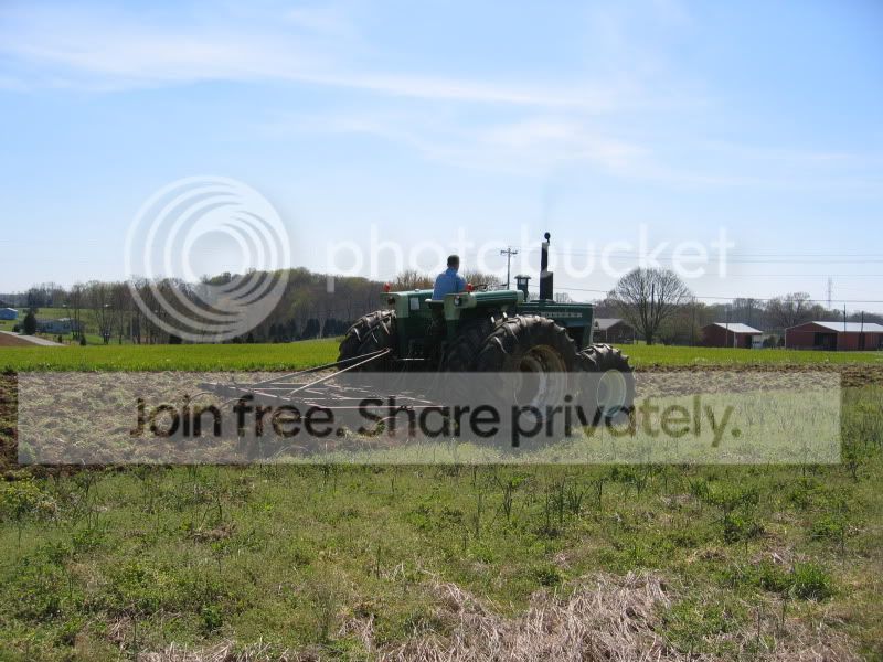

Nice pics of the big Oliver in action but it's hard to see any smoke, I bet it could pull more. With the tractors I have 7-9 shanks would be all they could pull the way it sounds. Thanks for the reply.
