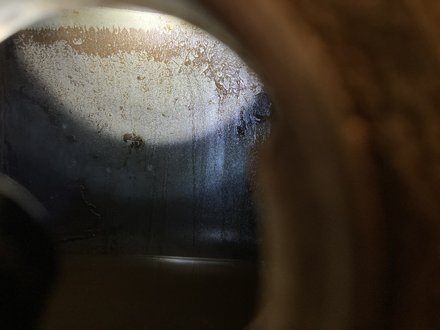

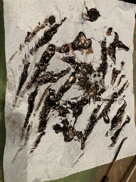

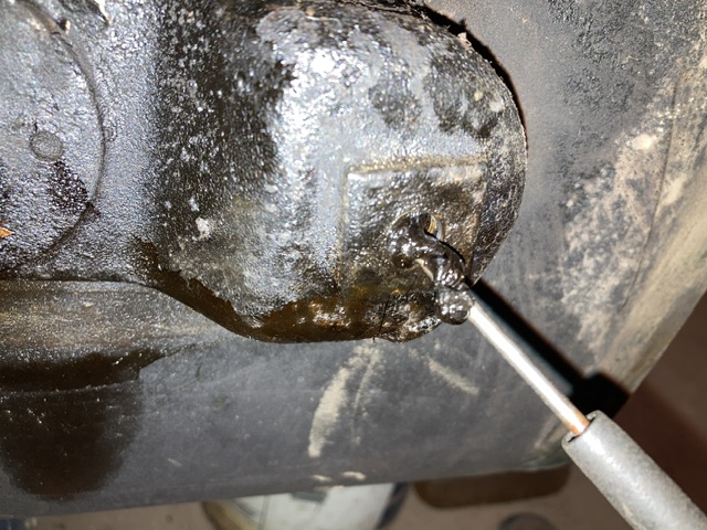

The super 88 diesel that I bought had sat several years with a thin layer of fuel in it and it had turned into tar. The tank is off and I’ve been soaking it with a gallon or so of E85. It cut it some but wasn’t getting it all, the bottom of the tank looked like cracked blacktop. I got a gallon of Acetone and dumped it in and then fastened a parts cleaning brush onto a stick long enough to reach the bottom of the tank and rubbed it around a bit. Looked inside with a flashlight after a few hours and the bottom was clean. Might get to see if it runs tomorrow!
Kinda looks like that black bacteria ...some call it algae...that grows in diesel.
I've only dealt with it once in a Ford 3000 I'd bought, nasty stuff.
Might want to treat with a biocide.
