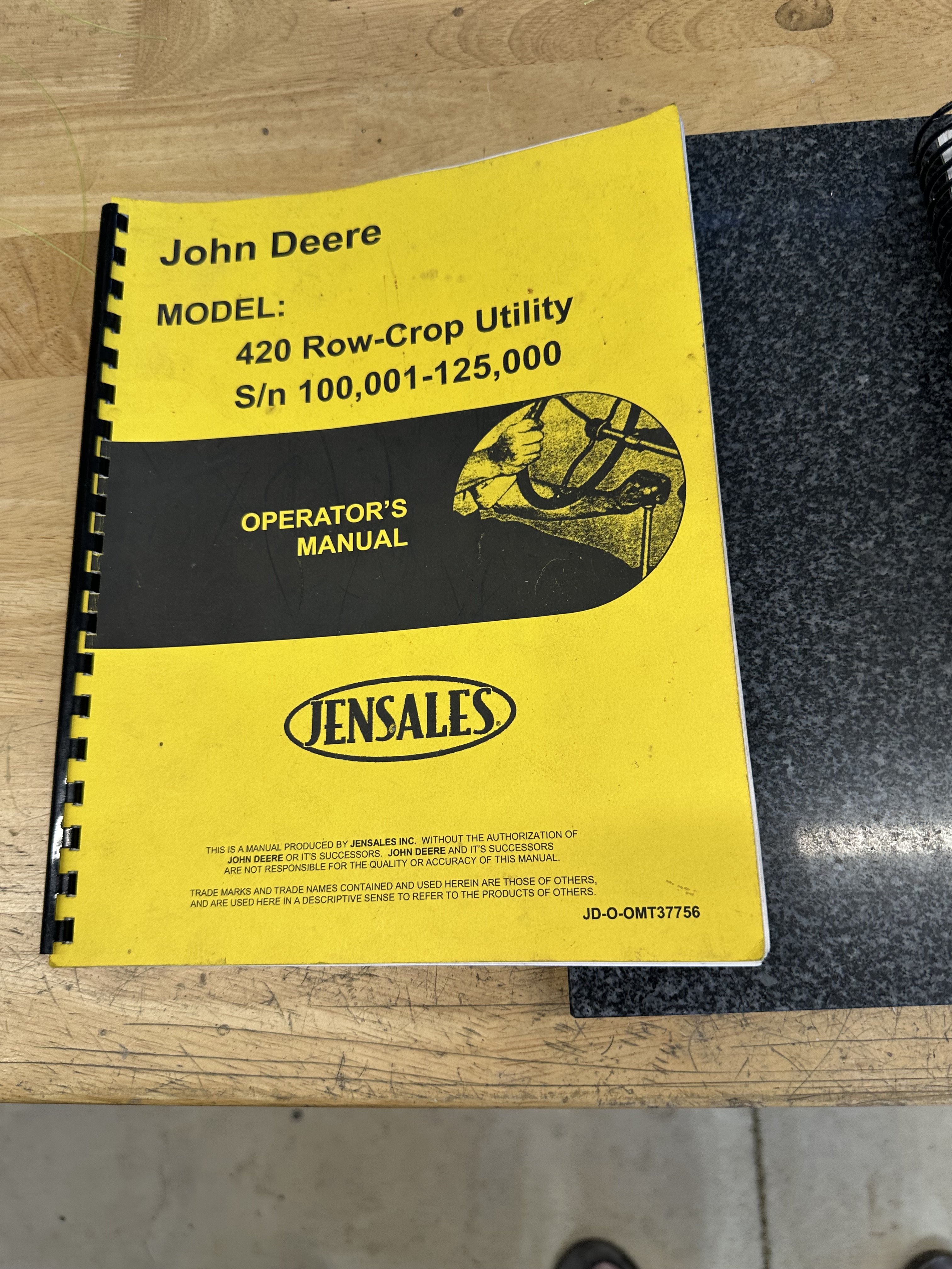

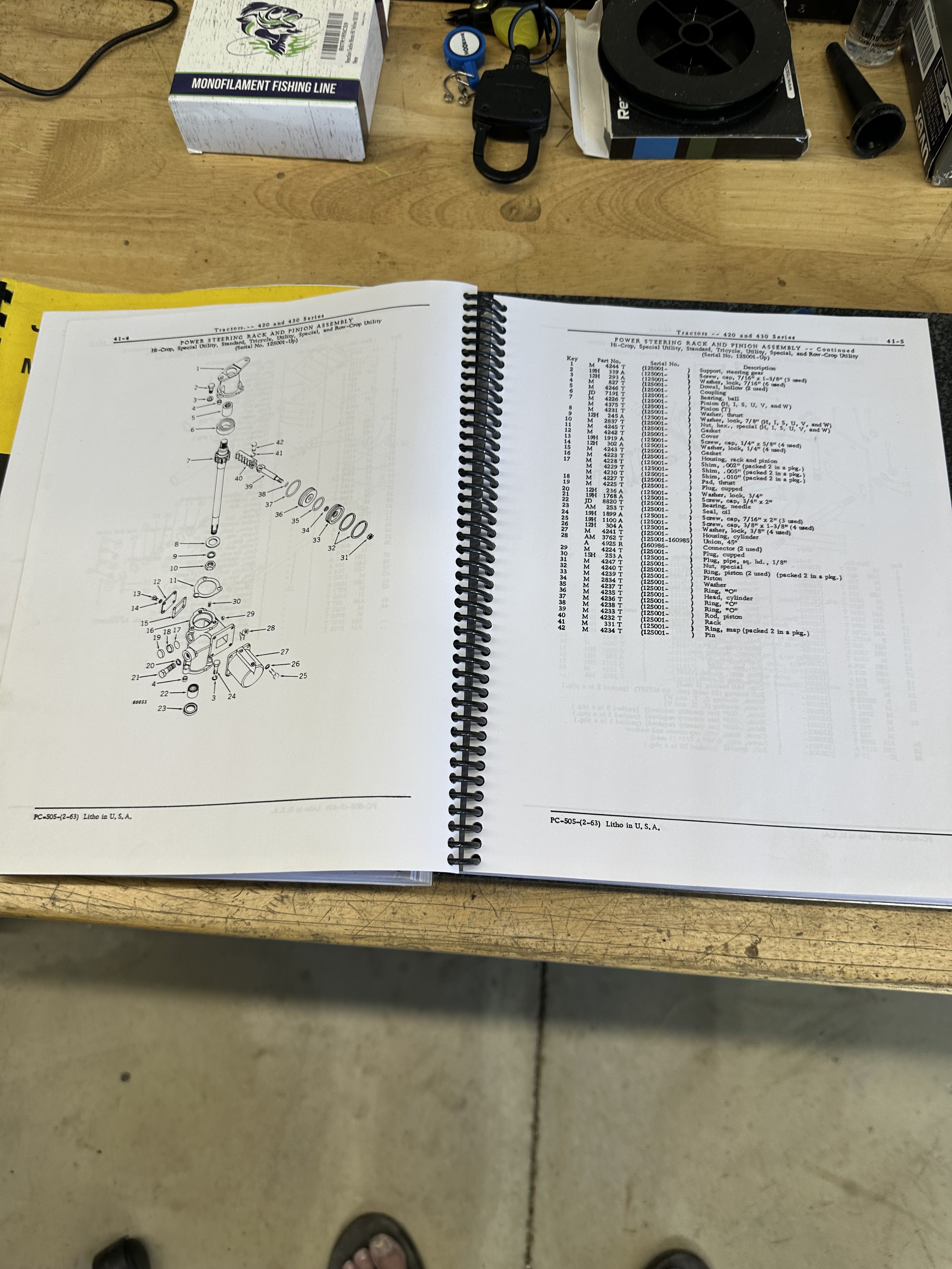

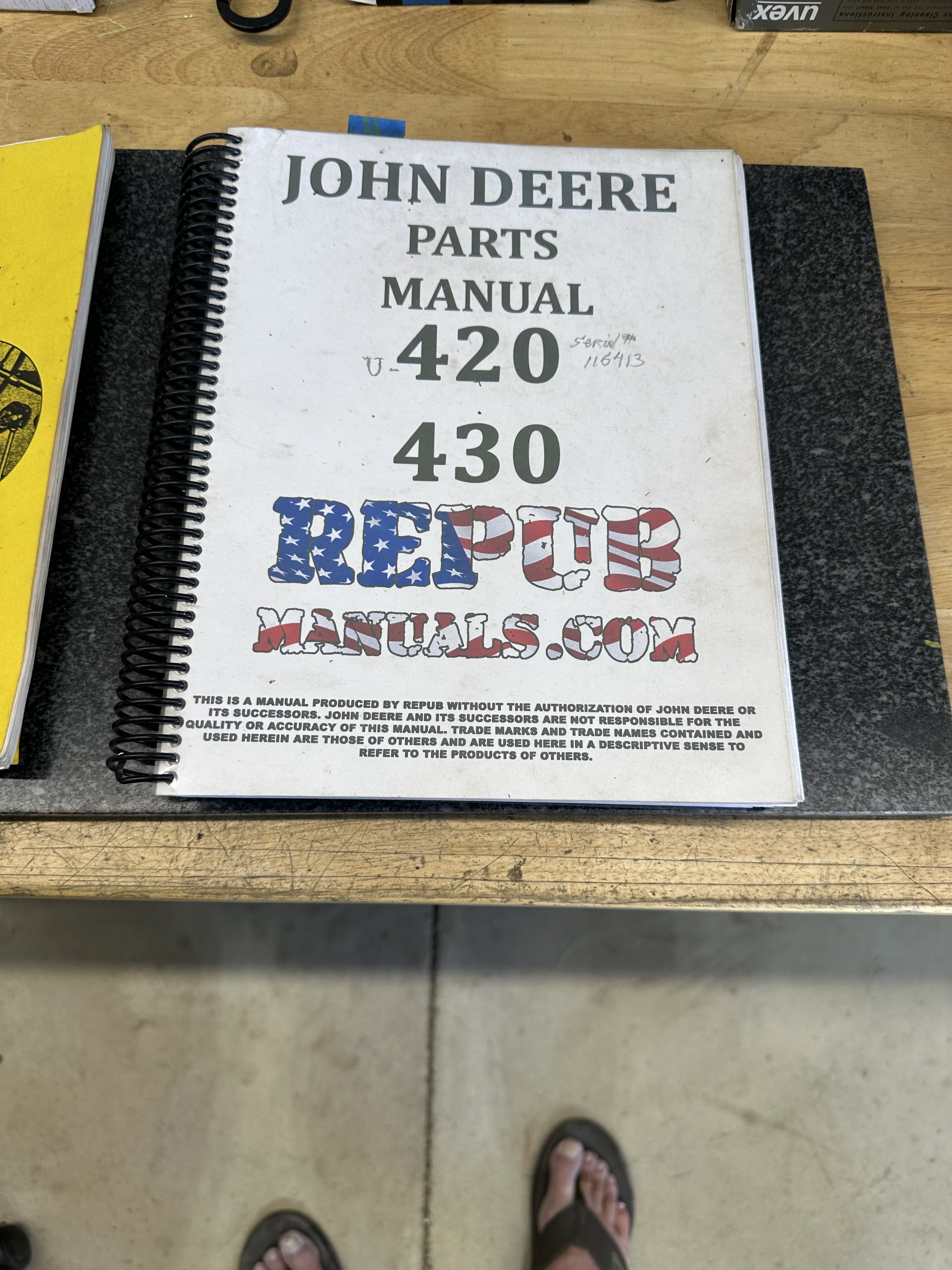

These is the best manuals I have, it’s a reprint of the original JD parts manual. I also use service manuals, Jen Sales reprint and a Clymers (I think).
The Big Book part numbers are true to what a dealer uses to make it easier and more professional to order JD parts.

The 420 and 430 service manual is John Deere publication number SM2019. It recommends having SM2013 (for the 40 series) as well since SM2019 refers to using info in SM2013, they figured the dealers already had SM2013 so why bother to include it in SM2019, just point the mechanics to where to find it. They also reference SM2000 (Tractors & Engines, Overview of older tractors, all models prior to and including the 435) which they expected the dealers to already have.
