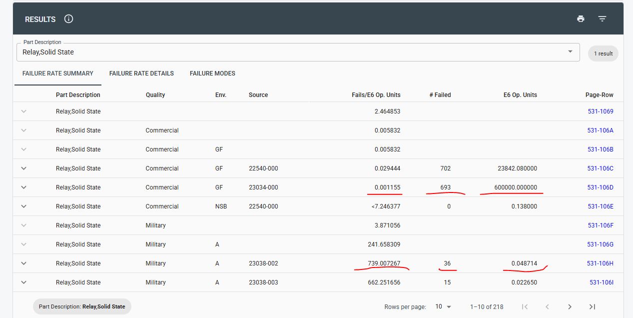

Just for fun, I looked up solid state relays.
The operating units is in millions of operating hours.
The commercial, ground fixed listing says a failure rate of 0.001 failures per million operating hours! I looked at the source (23034-000)... it said there was a population of 680,000 with 600,000 million accumulated hours. That would work out to a million hours (112 years -ish) per sample. I'm not sure how anybody could have 112 years of data per sample on solid state relays that were invented 50 -ish years ago. (I actually should look into this... as I think the data needs correction)
Moving applications, such as aircraft (the A environment) have a failure rate of 739 per million hours... which would equate to an MTBF of about 1300 to 1400 hours...
Either way, still better than points.
Looking into the details was fun... as there were listings for SSRs made by Allis Chalmers.
Also, for fun... I looked at capacitors, fixed, paper... which had a failure rate below 1 per million hours...
So why would condensers be taking a crap on tractors after a few hundred hours? Electrical Stress? Heat? Low Quality? Vibration?... prolly all of the above.

True... and failures right out of the box would be infantile failures/defects that would never get into the data sets from where this data comes from... which is annual maintenance of existing fleets of various stuff...
