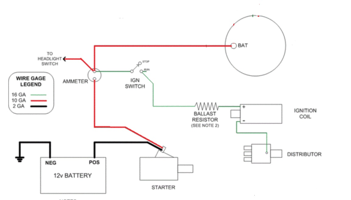

I am new here and I am trying to help my dad with his 1951 MT John deere. I have a one wire alt and 12 volt coil. I am just not sure of the wiring. Most of the wires have been removed or just partial wires. I found a picture of the wiring in 6 volt and I was wondering what do I need to change from the original wiring. I attached the diagram that I found.

What condition are the wires in? I can't imagine very good. This would be a good time to start over with all new wiring. "wiringharnesses.com" can make a wiring harness for your new arrangement with the alternator.
One thing old tractors have in common is lack of protection. Your negative battery terminal will be your ground cable. (Starter doesn't care either way) Power emanates from the positive terminal on the starter. Do yourself a favor and make sure there's a fuse or circuit breaker close to there, so the whole system, outside of the battery cables, is protected from short. That could well be incorporated into a new harness.
With a negative ground system, the negative side of the coil goes to the distributor. Do yourself another favor and make sure the advance mechanism is free to work. And lubricate the hole in the top of the shaft under the rotor with light oil, as well as the main shaft, if there's a plug in the distributor housing you can remove. These are just a few ideas, I'm sure plenty of detail will follow.

An MT is a pretty simple tractor, wiring wise. You can wire it yourself using this basic diagram. The ballast resistor is only necessary if you don't replace the coil with a "12V No Ballast Resistor Required" coil:

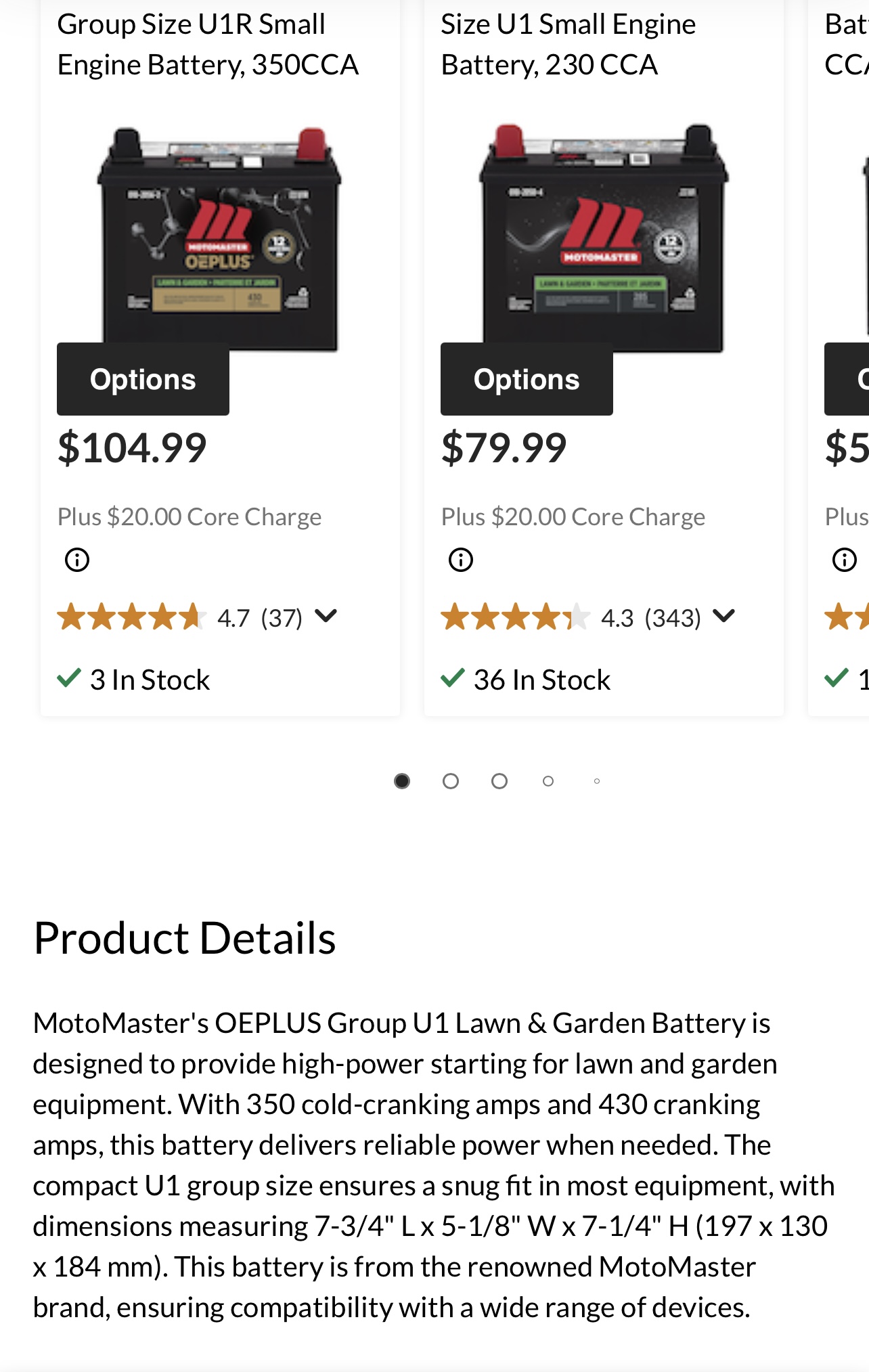

Would a 350 cca lawn tractor battery start an MT? That's what George uses in his Farmall C, and that's what I intend to do when my 6 v battery fails in our C. You can buy a pretty good 350 cca battery for < $50.
