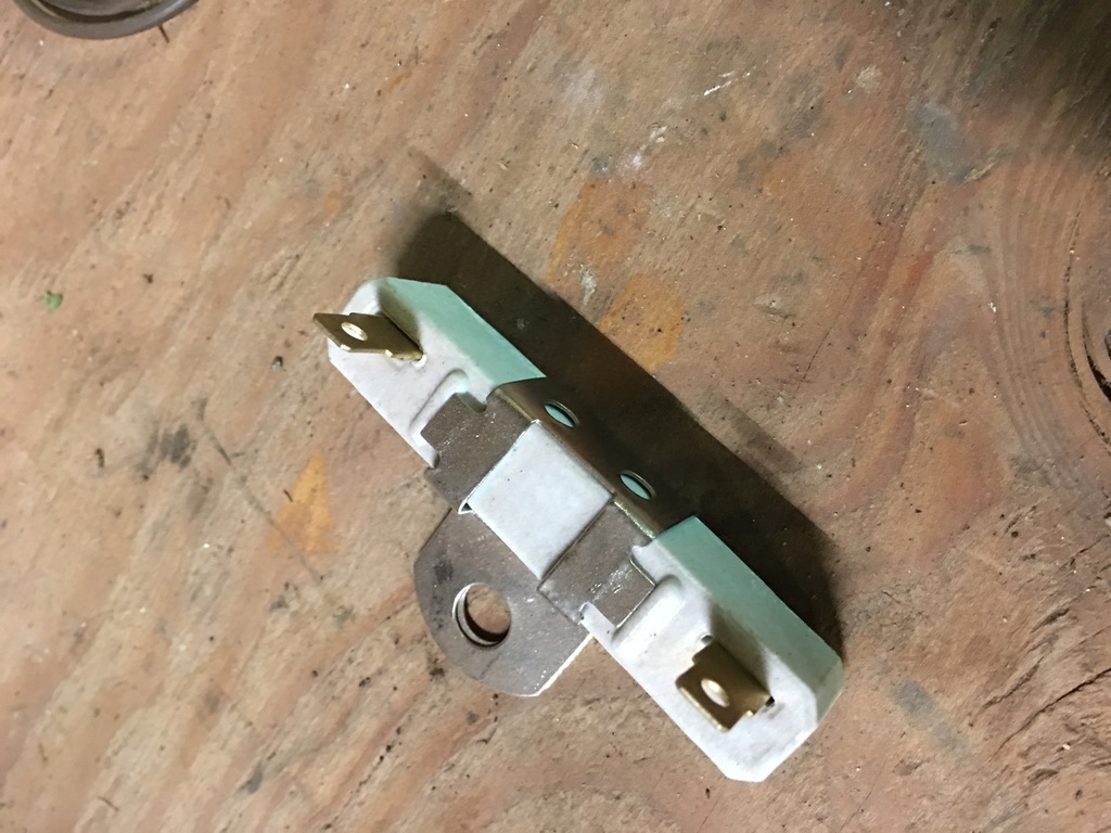

2. If it's a distributor ignition (not a magneto system), wire a ballast resistor between the ignition switch and the coil, remembering to reverse the coil connections (swapping plus and minus). Try a 1.5 or 3.0 ohm resistor and measure the voltage on the far side of the coil. You are probably looking for between 3.5 and 4.0 volts. If you measure the voltage on the near side, it should be about 6 volts after going through the ballast resistors.
